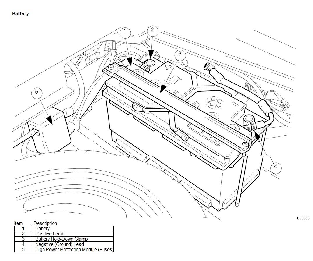

Old Jan 15, 2014 | 05:12 AM
Originally Posted by Peter Garrod
I replaced the Battery about 18 months ago, will check it --but I am wondering now if its corroded terminals on the negative to chassis. .......
The Negative chassis connection isn't noted for issues but is easily checked and cleaned or tightened if necessary.
Although I don't recall Positive lead being reported as an issue on X308 (and I never had any problems with mine), this is a known fault on X-Type and XK8.
The Positive lead loosens or the terminal corrodes in the HP protection Module (item 5) giving rise to spurious faults even with a healthy battery.
Worth checking and eliminating on your X308 ........
