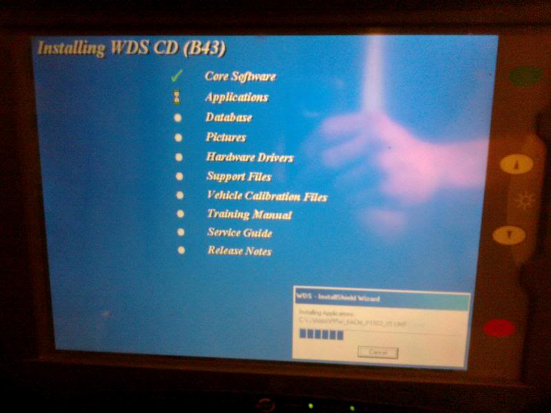

Things are looking good!!
Old Jan 11, 2014 | 12:51 AM

She's a worker again. Huge thanks to everyone that posted in this thread.
Got everything loaded, battery conditioned and purring like a kitten.
Tomorrow I'll tear into it and see if this RAM that I have will work.
