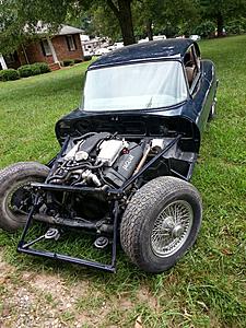

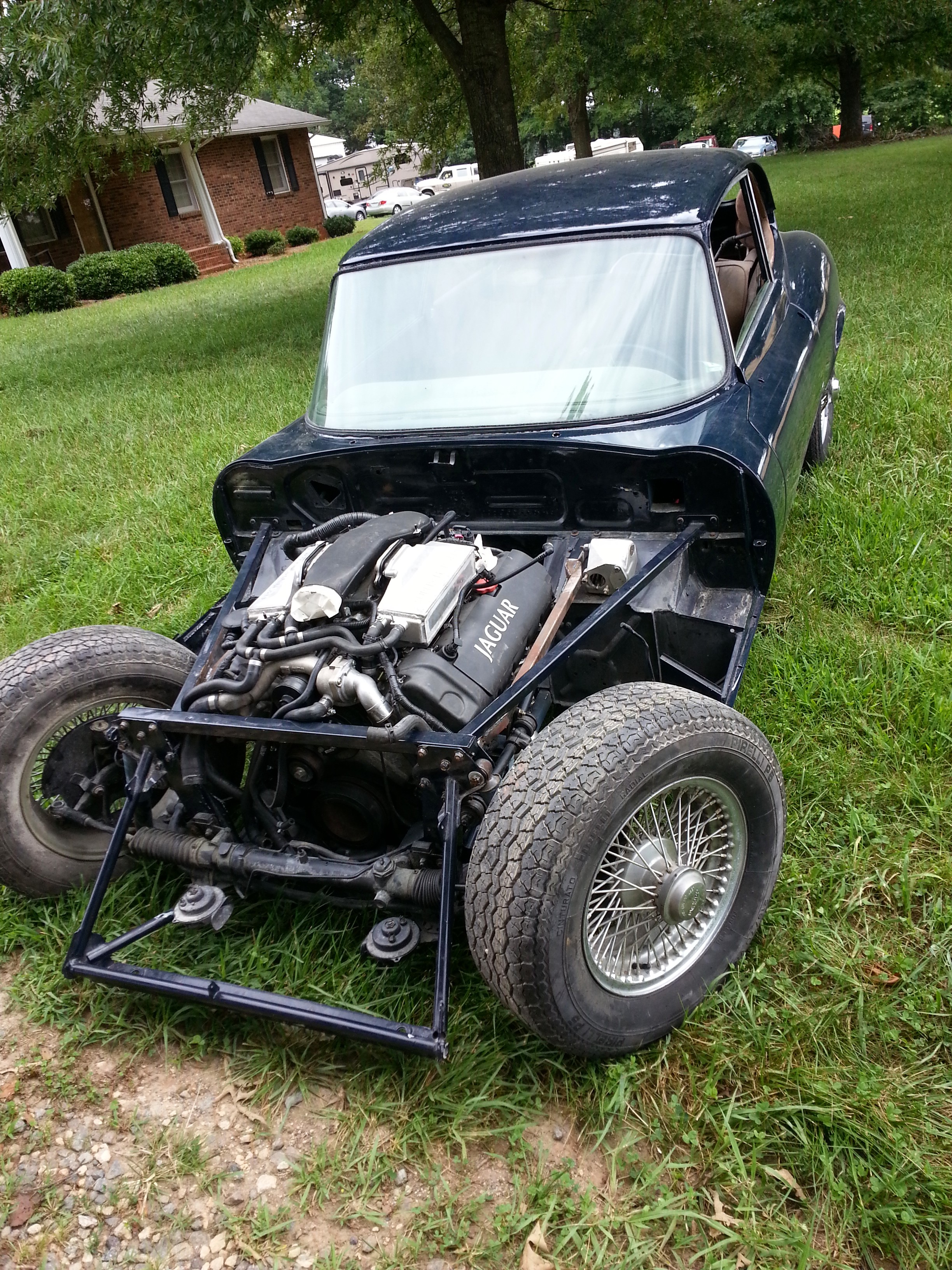

Default Swap? what swap?
not an easy swap, but unkique, I think.
Attached Thumbnails Jaguar 4.0/ 4.2/ Lincoln 3.9 interchangeability?-xke-supercharged.jpg
