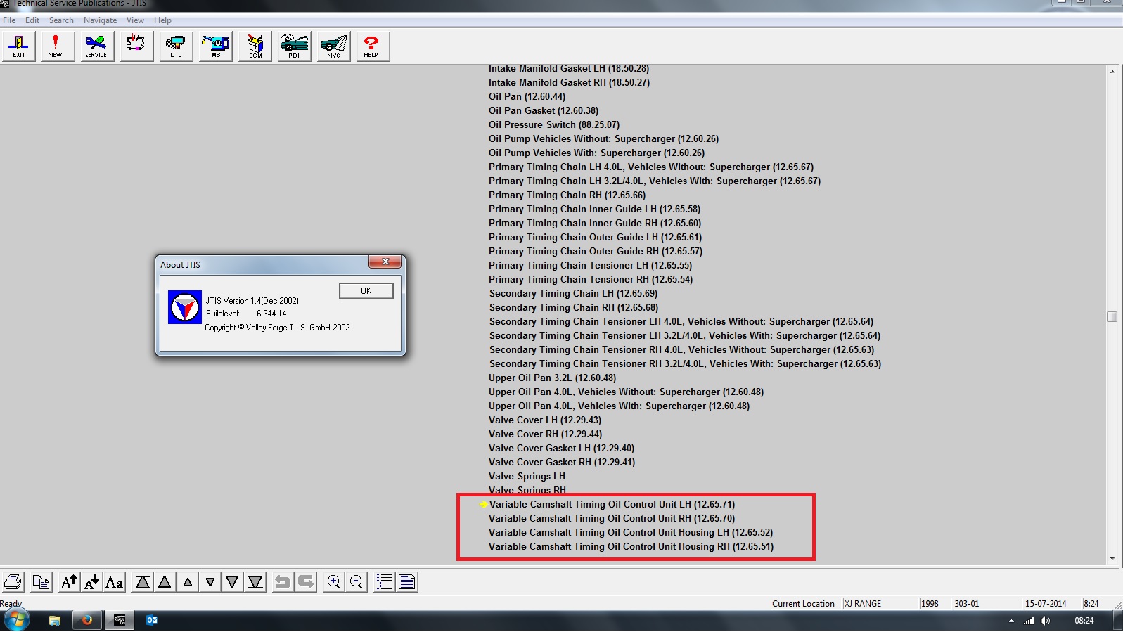

I have been trying to get JTIS installed for the past week, I am still working on it but am running out of patience. The part that I really want to know from the JTIS is the reference related to the VVT in JTIS 5. My Jag is down until I know that the VVT is correct and everything I found so far references to this JTIS 5, which is why I have been working to get JTIS installed.
Can someone PLEASE tell me what JTIS 5 is and what it says about the VVT system? I am trying to correct a P1396 code

Is there a JTIS 5?

My installed version of JTIS is build version 1.4 (Dec 2002) at build level 6.344.13 which goes up to MY 2004. I assume this build level 6 post dates the 5 you are asking about.
It has information on the VVT (see section boxed in red:
Please follow this link New Member Area - Intro a MUST - Jaguar Forums - Jaguar Enthusiasts Forum to the New Member Area - Intro a MUST forum and post some info about yourself and your vehicle for all members to see. In return you'll get a proper welcome and some useful advice about posting to the forum.
Attached Thumbnails JTIS21 win7 64 install method &amp; new archives-jtis.jpg

The VVT removal/install Procedures are in the JTIS21 - 1998 XJ - Powertrain - Engine - In Vehicle Repair - Variable Camshaft Timing Oil Control Unit Housing LH 12.65.52
also
Variable Camshaft Timing Oil Control Unit Housing RH 12.65.51
also
Variable Camshaft Timing Oil Control Unit LH 12.65.71
also
Variable Camshaft Timing Oil Control Unit RH 12.65.70
