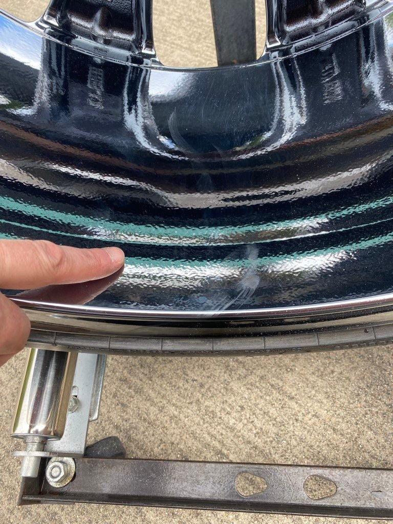

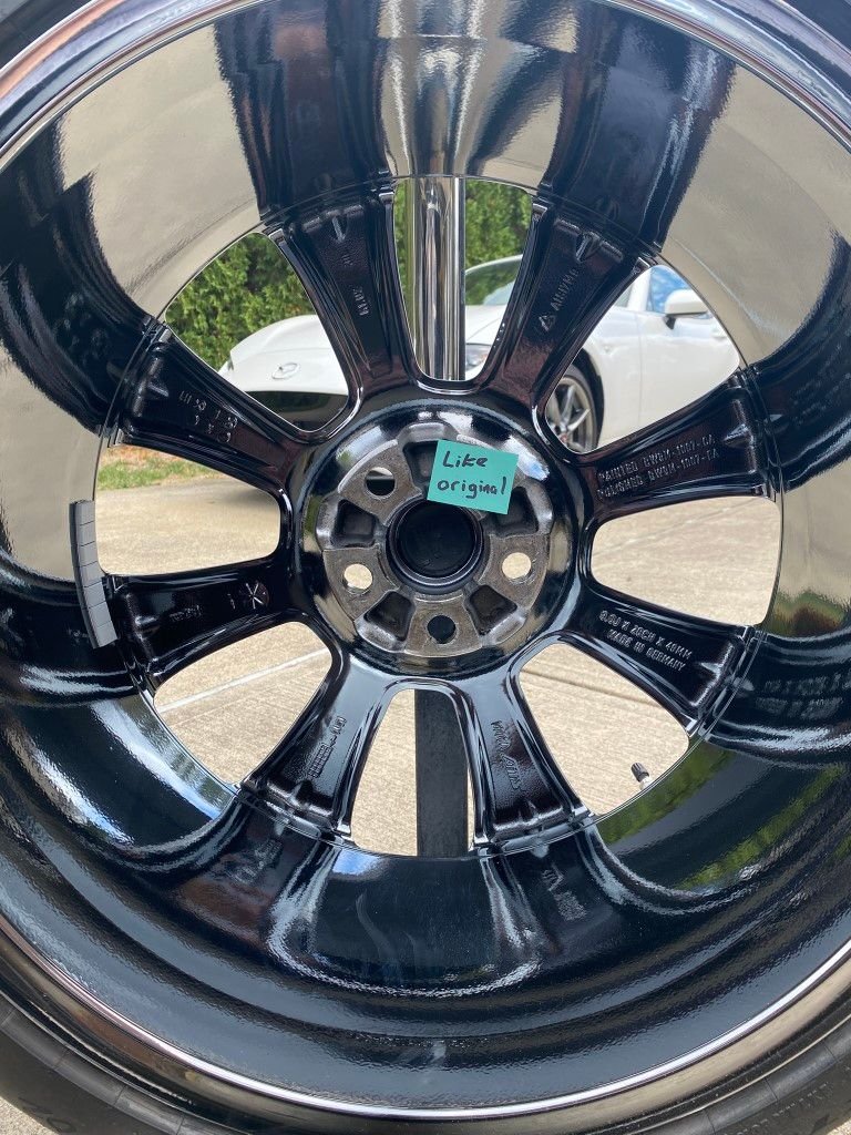

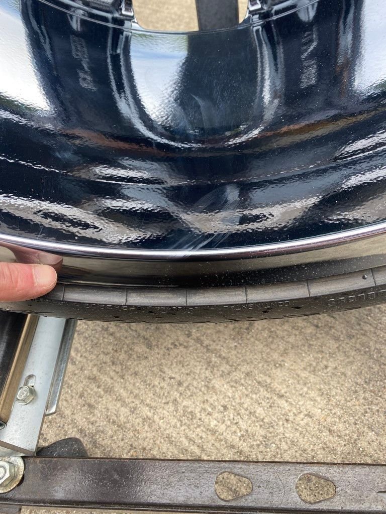

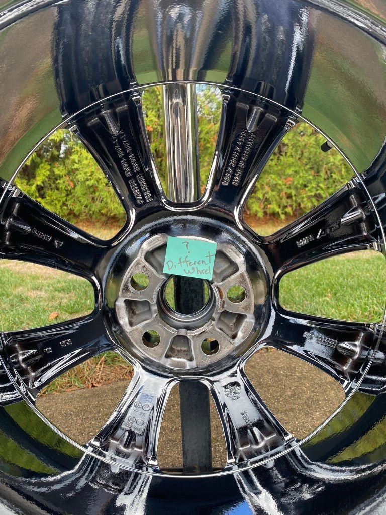

Now two and half months and 2,500 miles later I start my Fall detailed cleaning process in the last few nice days we have in Northern Kentucky. This involves removing the wheels to deep clean both sides and the wheelwells. I had done this once before right when I purchased the car so I knew the exact state of both sides of all the wheels and in my mind I knew what they looked like. All of the first 3 looked great, just a small dusting of brake dust build up. When I pulled the last one, the front driver's side I immediately noticed a build up of crud in a “groove” about 2 inches from the inside edge of the wheel (see photo pointing to groove labeled "? Different Wheel"). It's rounded and about 5mm wide and maybe about 2mm in depth. Inspecting it further I realized the edge that folds around the edge isn't smooth an around like all my other 3 wheel styles, but has more of an edge and also a flange that sticks out about 3mm. (I took photos of all of it including close-ups of manufacturing code #'s to try to figure this all out). So I put the driver side front back on and re-pulled the front passenger wheel again to compare it to make sure I wasn't going out of my mind and sure enough: no grove / no flange.
Weird thing was the part #'s match: they both are BW9M-1007-EA, 9.0Jx20CHx49mm, D22FA, Made by ATS, Made in Germany, etc.

View of driver's front wheel that is different from the other three showing the manufacturing codes.
Pointing at "groove". It's really hard to see in this photo but it's about 5-8mm wide and 2-3mm in depth, and collected a bunch of crud before washing.
Same wheel pointing at "edge flange", you somewhat see the groove in this photo better at this angle.
Passenger front that has the style that matches the rears and what I saw on my old ones I turned in for the swap.
Notice no groove and how the edge smooth folds over and has no flange sticking out.

Kevad68, that difference in manufacturing is not something I would be worried about. If anything, the wheel with the larger radius bend I would prefer (due to ability to handle stress). But, I am sure both wheels are mechanically sound and will handle whatever you put the car through. Now, if the wheels are physically a different diameter, then that can lead to problems. But, having a 1/2" radius bend at one point and a 1/8" bend at the same point on a different wheel is nothing to be concerning. A little bit on manufacturing and why they put curves on things, especially those that see a large load. If the manufacturer was to put a sharp corner at where you are pointing to, as you side load the wheel, all the forces would concentrate at the point of the 90 degree bend. This would cause a lot of stress to be focused on a very specific point and could lead to exceeding the strength of the metal. Where, you put a 1/8" radius, now the stress is "focused" over the entire 1/8" bend (a lot more surface). So, exceeding the strength of the material becomes less of a worry. You go up to a 1/2" radius, the stress is "focused" over an even larger area, definitely not exceeding the materials strength.
Now, I would be asking why the wheel is different more from a historical point of view and being able to explain why the car may not be a "numbers matching" vehicle (lowering the value of the car). If that is how it came from the factory, then all is good. But, if someone was to notice, then it could lead to the question of "why was the rim replaced" which is normally immediately associated with "the wheel hit a curb" and "what other damage has happened to the suspension".
