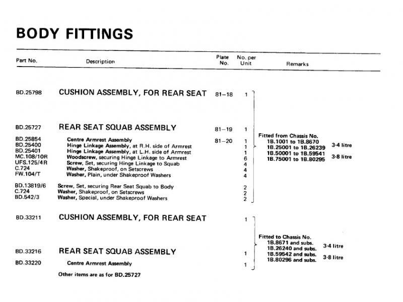

After removing the two bolts from the bottom of the rear seat back, what else needs to be removed to remove the back from the car?

There's two rear seat assemblies listed for the 3.4S and 3.8S depending on Chassis Number but the removal procedure is the same for both.
Lift the rear seat cushion upwards off the two locating pins at the rear of the seat and remove the cushion.
Remove the two screws and washers securing the bottom of the rear seat squab to the back of the seat pan. Lift the squab to disengage the three retaining hooks and withdraw the squab.
