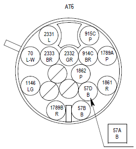

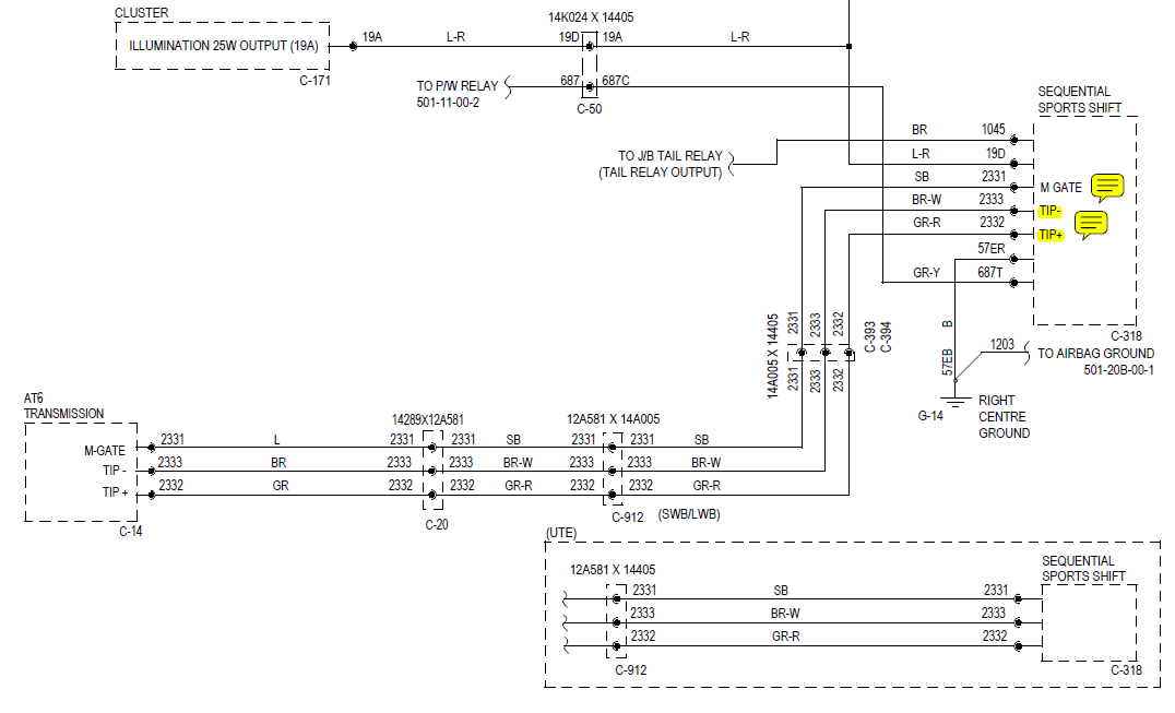

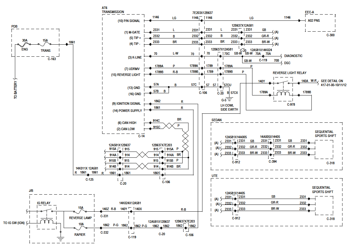

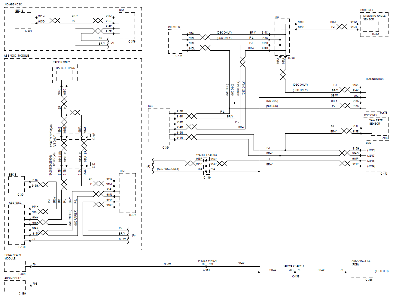

Some of them have paddle shift (aka Tiptronic/Steptronic etc) so may be different - yes, maybe you'd want it if it worked!
I guess you found p50 of http://www.jagrepair.com/images/Auto...ning-guide.pdf
I found some Ford wiring etc pics I'll add.
Some BMW & other links / files
www.e38.org/electran1.pdf
www.ge39.com/files/electran1+2.pdf
ZF%206HP26%20Pulling%20and%20Troubleshooting%20The %20Mechatronics%20Unit%20E%20shift%20Unit%20by%20w ilson009.pdf (has some ohms values etc)
I expect you have the ZF parts catalogue & repair manuals?
DISCO3.CO.UK Photo Gallery - ZF 6HP26 Automatic Transmission in LR3
www.automaticchoice.com/Catalogue/v_index.pdf
I don't know what changed but there are at least 6HP26A (4WD version?) & 6HP26X (e.g. BMW X5).
http://www.rangerovers.net/forum/6-r...-teardown.html
