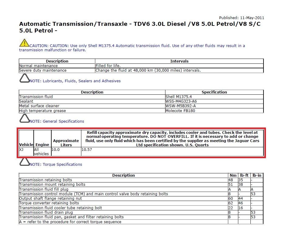

Old Mar 25, 2020 | 08:28 AM
Originally Posted by Dougsf6770
I have recently purchased a 2009 Jaguar XF and want to change the transmission fluid...looking for information as to how many quarts / liters are required. ......
This is from the 2010 X250 Workshop Manual:
Filler plug access is a bit tight:
