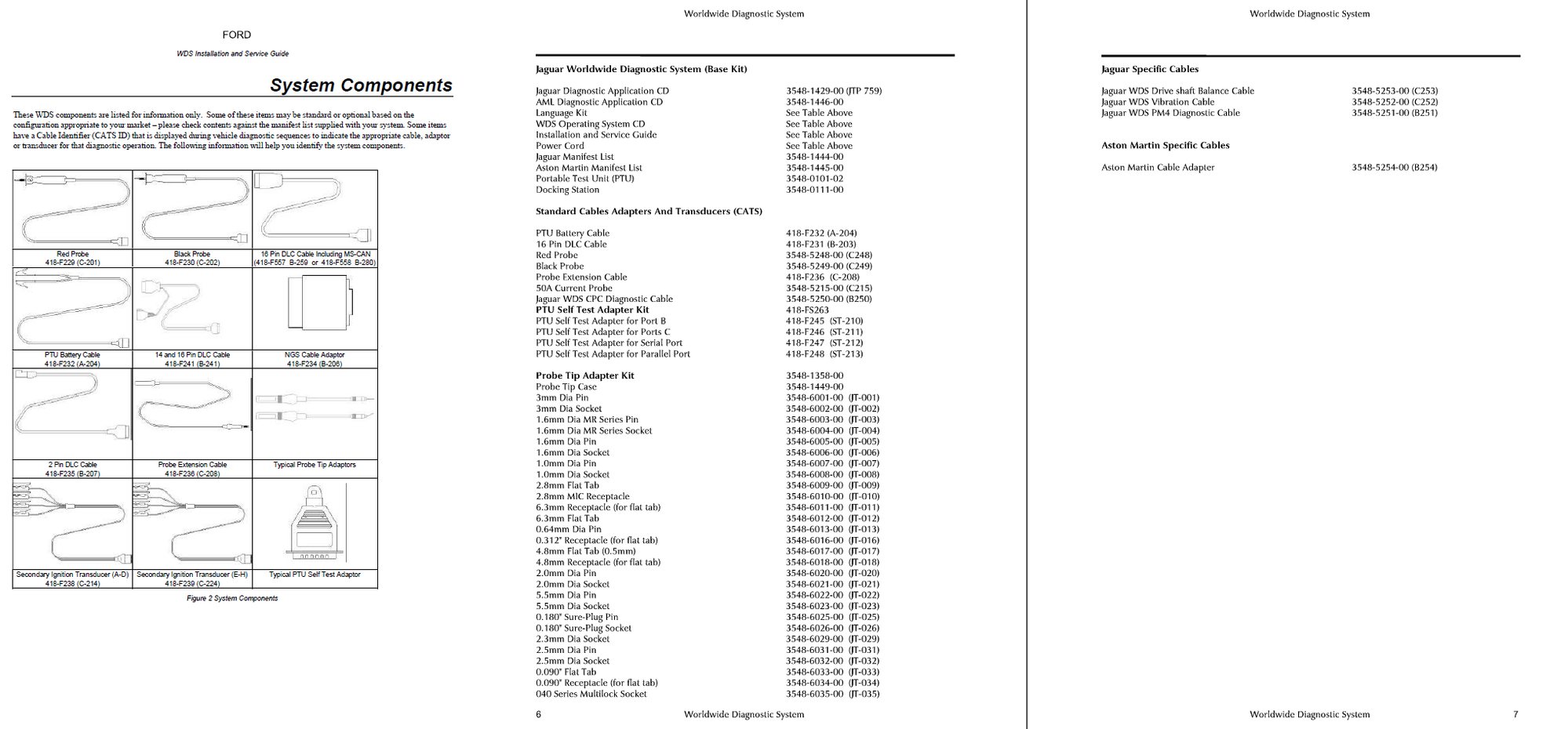

B-280 is upgrade to replace B-203 and can be used instead. B-259 is the same but shorter. 280 and 259 came from Ford WDS but are compatible with Jaguar. WDS even on UI says you to connect B-280 and use B-203 if you don't have 280. 280 is "must have" with newer cars with VBLOCK (onwards 2002 or so).
Last edited by tlindi; Sep 19, 2024 at 08:54 AM. Reason: Added image of cables from Ford and Jaguar WDS manuals
