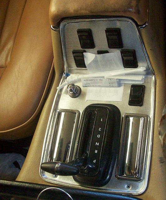

Here are some before pictures:
The first picture shows the entire dash and steering wheel (cheap looking crap) cover. The second is a closer shot of part of the dash, the buttons under the dash and the stereo/climate controls. The third is the console panel for the shifter/ashtrays/etc. and the window controls. All of the silver will be covered with the walnut burl veneer, and the dash will be redone using walnut veneer. Also, notice the shift knob is black plastic. That will be redone with a lathed piece of walnut burl as well.
I've also attached a couple of pictures of the veneer I'll be using (in case you don't know what walnut burl looks like ).

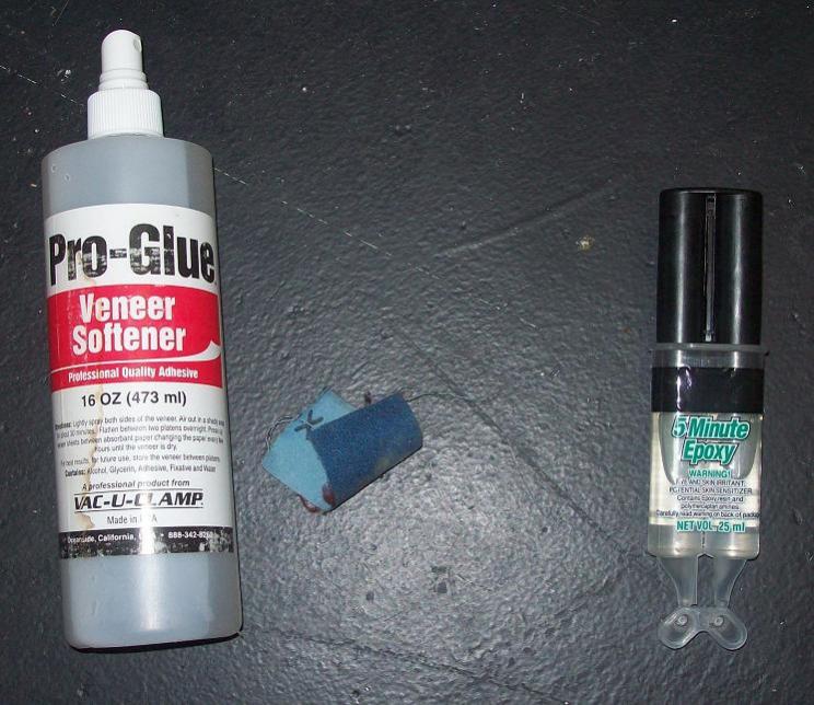

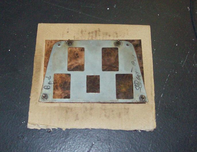

Here are some pictures of the test pieces.
In the first two pictures are my materials. The window switch plate, and the piece of walnut burl.
The third pictures shows the stuff I'll be using to do it. Pro-Glue veneer softener (but not actually an adhesive), copper pipe sandpaper strip, and 5 minute epoxy (I got this from Lowe's). I used the pipe sandpaper strip since I use it to clean and roughen copper pipe when I do plumbing...I figured what better sandpaper to use than something designed for use on metal?
I lightly sprayed the veneer with the softener and let it dry for about 5 minutes. While it was drying, I mixed the two epoxy resins with a toothpick (since I wasn't going to need much), and spread it with a new razor blade (since the epoxy needs to be a VERY thin coat). I spread it onto the switch plate versus the veneer so that the veneer wouldn't curl.
The fourth picture shows the switch piece attached to the veneer. Notice that it's laying on top of a piece of cardboard? The veneer softener says to place the veneer between two piece of brown paper (like a paper bag) to slow the drying process so that when the veneer is removed from between the flattening things, it won't curl back up again). Since I didn't have any, but I had some really nice pieces of cardboard, I decided that I would use that instead.

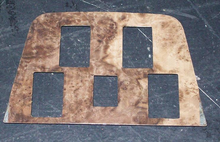

More pictures of the test piece. Almost wish I had done this one as the real thing, because it's coming out good. Time will tell.
First pic - glued and cut out.
Second pic - show little to no raised sections.
Next step (when I have more money to get sand paper and gloss treatment) is to sand it and get it glossy.
