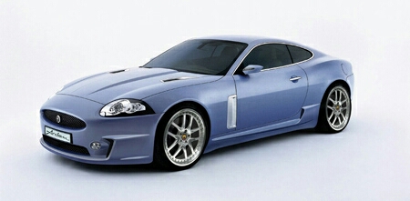

Arden Xk aj 20
"As far as the normally aspirated engine is concerned, Arden rebuilds the V8 from scratch, increasing its displacement to 4.5 litre. In conjunction with the modified intake and exhaust systems and sports catalytic converters, the recalibrated Engine Management System produces a noted hike in power, while retaining the original emissions classification.
The 4.5 litre displacement generates almost 100 extra brake horse power, with a total of 392 bhp (288 kW) and a torque of 475 Nm at 3,800 rpm. Sprinting from 0 to 100 km/h (62mph) is just 5.3 seconds; that's just under a second faster than the production version. And the top speed of 285 km/h (177mph) is pretty impressive too."
