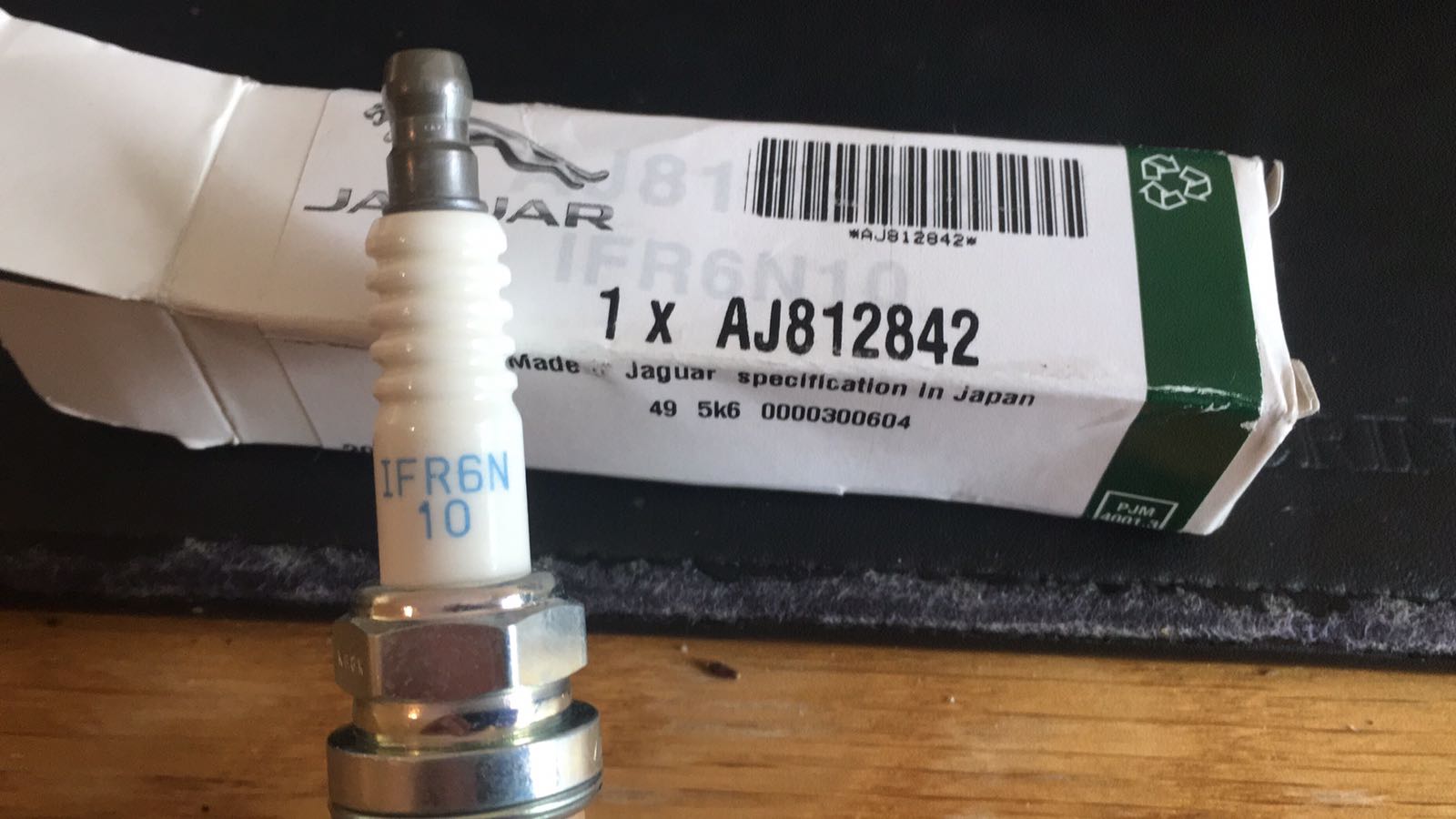

I can't believe it...
Colder sparkplug for s/c AJ-V8 ?-ifr7n-10.jpeg
Colder sparkplug for s/c AJ-V8 ?-ifr6n-10.jpeg
The Aston guys are gonna go nuts when they see this...
Attachment 143503
Attachment 143504
Wow and thanks for sharing. Off to order now.
