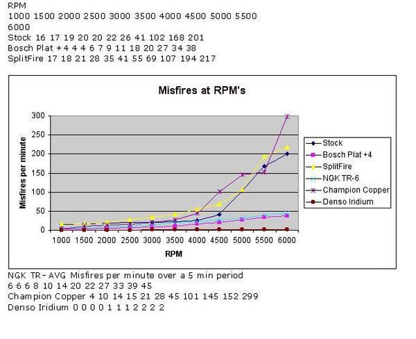

Originally Posted by AlexJag
I just have cheap copper NGKs that are one step colder, if I remember correctly gaped to .035
Cooper is ok of course (maybe you need to gap it smaller), but it also wares quicker then the iridium ones, so you need to change them more often to ensure a good spark and less stress on the coils.
Attached is an interesting spark plug test on a lightning engine done within a lab (at least that was what was written next to it).
Attached Thumbnails Colder sparkplug for s/c AJ-V8 ?-misfire-lab-test-.-lightning-engine.jpg
Interesting, although I also read somewhere that cooper were actually a better conductor and they were less prone to detonation, the downside was only that they didnt last long

avos's Avatar
Joined: Apr 2008
Posts: 3,616
Likes: 1,070
From: Europe
What I learned is that it’s not just conductivity (iridium plugs also have copper cores), it’s also the sharpness of the electrodes and the size of the main electrode. As copper is softer it wears quicker reducing the sharp edges (i.e. rounding them off), making it harder for the plug to fire. Especially for a boosted setup it will become gradually harder to fire (higher voltage requirement), which can reduce the lifetime of coil but more important you risk more misfires. I don’t have the graph of how quickly copper wears so when it needs to be replaced though.
Considering all what’s written about iridium being able to fire much better under harder conditions (leaner mixtures, higher boost) lasting much longer as well, I can’t see any reason for going back to a copper plug.
