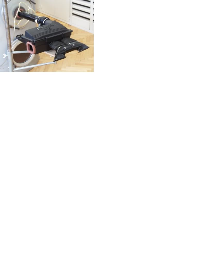

The X type intake airbox leaves some room for improvement:

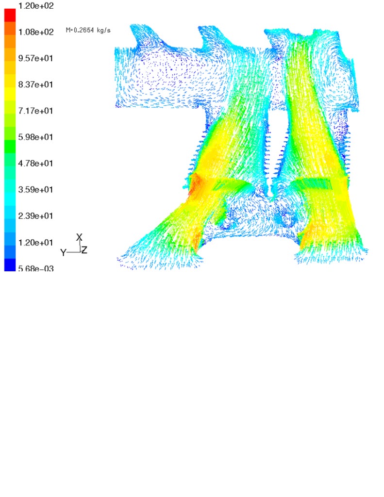

On the 3 litre the intake manifold depression measured is 57 mbar (intake losses) for about 230 bhps worth of airflow. Compare this with the JV6 X202 engine- in the S type which is about 28 mbar at peak power.
You can do something simple- such as introducing another hole- with a bell mouth- but this will almost certainly increase intake noise:

The problem with the basic design is that there are recirculation zones within the flow- where collumns of air hit one another- which is very wasteful in terms of energy

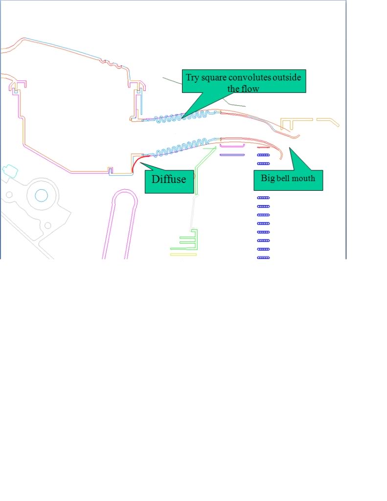

The X type replacement was to have a detail orientated and optimised design, using square convlutes that dont intrude on the flow, bigger radiused sections and general detail design improvements that would have brought it in line with the bigger brother, the S type

Before I set about changing the airbox I would first measure and confirm the losses are 57 mbar and then go about fabricating and making detail improvements, all the while monitoring the intake manifold depression at WOT and peak power- where it is safe to do so.
Good luck!
