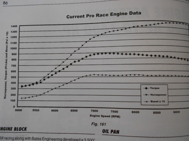

dyno sheet ,check the torque, and the boost #s, whoda thought from a street engine!
GM is great for giving a detailed book and part numbers to build it!
yup 1400hp,, 900 lbs ft, 9000rpm, and amazing 52 PSIG boost.
the hp junkies will appreciate it.

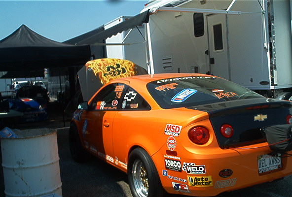

that engine is for the race car,, other pix are for the street car, to go out for fast food,(Macdonalds,, Wendys, ETC). read the street performance figures on the window sheet.
i dont think i want to run him! LOL.
