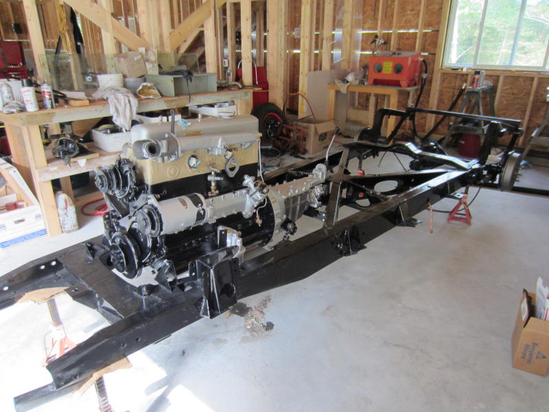

The body is in the metal shop , being the roughest part of the project. I will be working on the mechanical part as my friend works on the body. You can see the original re-built engine, and the blasted and painted chassis.

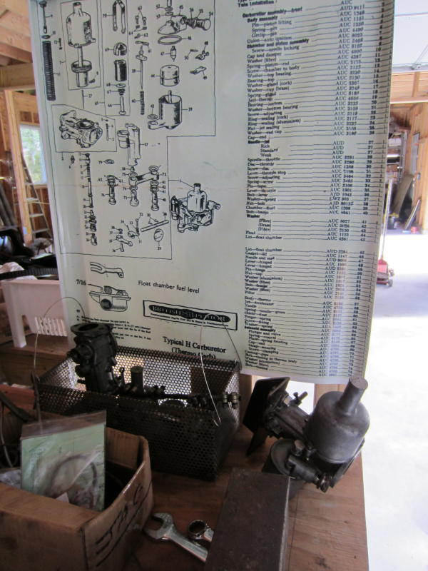

I have to deal with the throttle shafts on the SU carbs , there is too much play , the bodies will need to be drilled and fitted with bushings and a new throttle shaft. This is not unfamiliar to me, having done it on S&S carbs for Harleys.
Thank you ,Steve

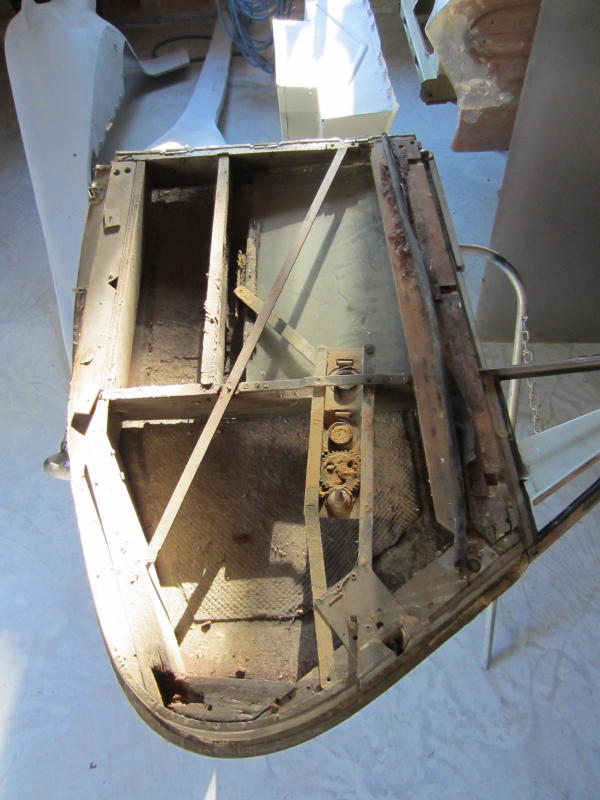

Here is a shot or two of the door from one side:
..and the sad carbs with 2-3mm throttle shaft play, new bushings and shaft on the way.

My car is now in the stage that the frame was sandblasted and powder coated, engine and transmission and suspension rebuild. (see picture).
Im now in the process to restore the body. The tub is repaired and powder coated and I'm now restoring the wood of the doors. After that I will have all parts painted in the primary colour.
