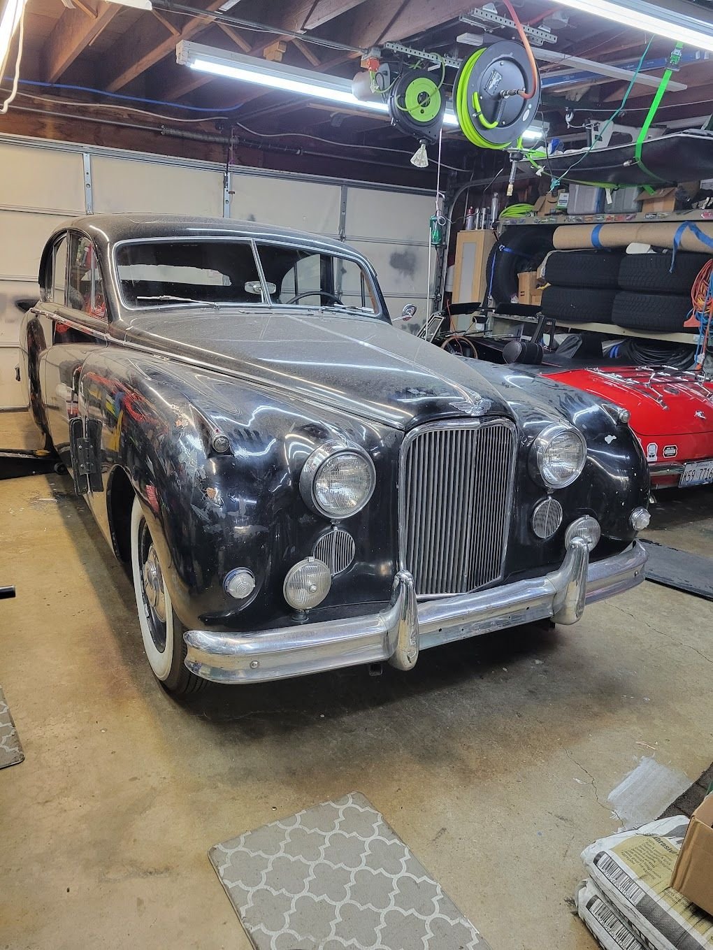

After wrapping up a 1974 XJ6 project, entertaining myself with a 1967 420, and bringing a 1989 XJS back to life, I felt it was time to visit a decade I haven't owned a car from. I picked up a 1955 Mark VII that had spent most of its life in Arizona and while the paint is rough, the body is very sound with only some minor surface rusting in some areas. Based on the documentation that came with the car it looks like there was an engine and transmission rebuild in the late 1980's.
First up is getting her on jack stands and defusing the tires. They have to be 35+ years old.
Next up is seeing why the engine doesn't run. I'll fill the cylinders with Marvel Mystery Oil and try to turn the crankshaft. The shafts on the carbs seem to be frozen stiff so she will need some love.
Third on the immediate list of things needing attention are the brakes and/or why the car won't roll. I am guessing the brakes are stuck in the on position.

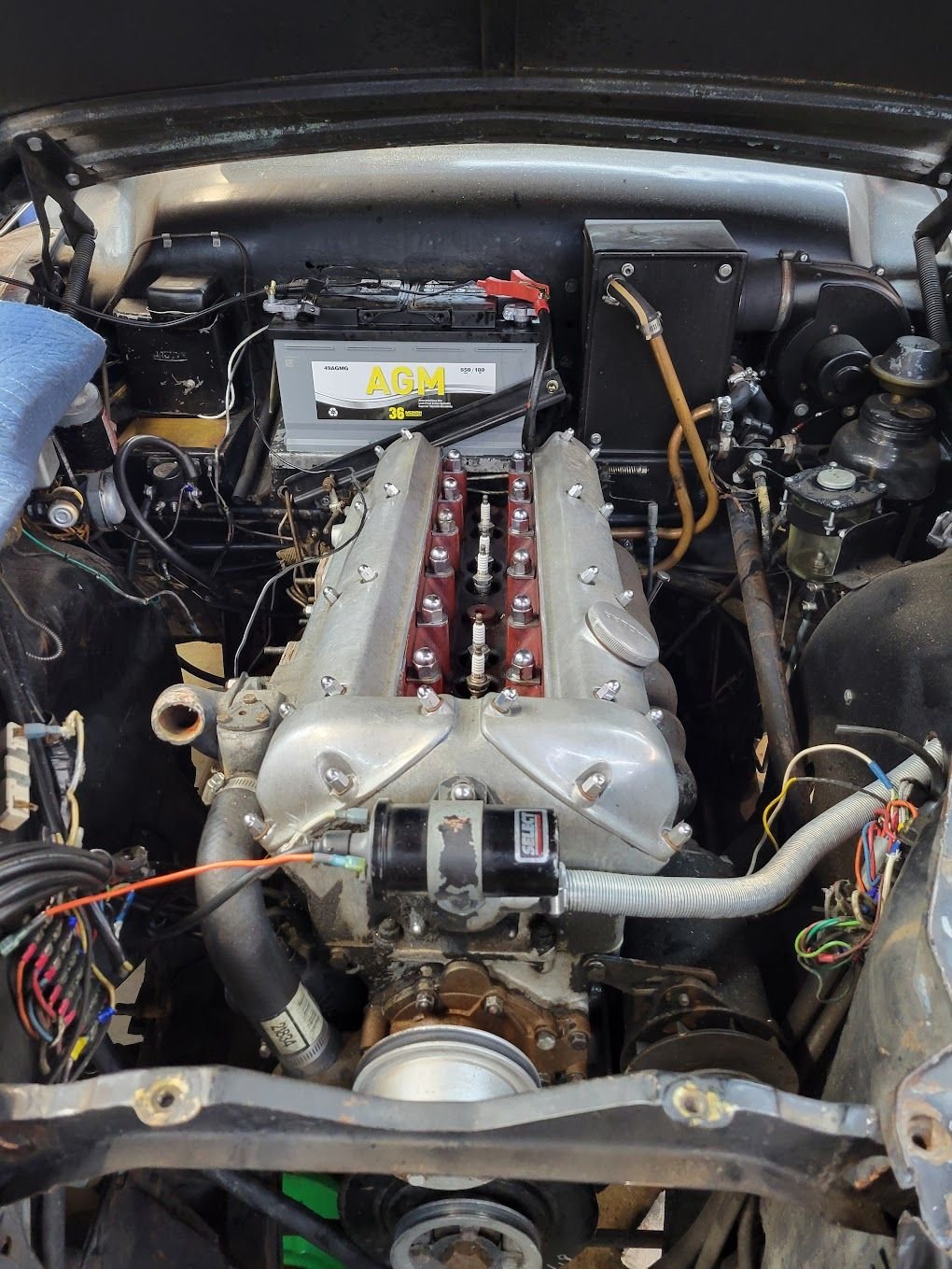

I went out at lunch today and the crank turned very easy. I assume the piston rings were stuck and the Marvel Mystery Oil helped to free them up.
Buoyed by the good news, I went out tonight and bought a new battery. I hooked up my compression tester and checked each cylinder. The odd-numbered cylinders were really good and the even-numbered cylinders were not good at all.
I stuck my borescope through the #2 spark plug hole and didn't see anything catastrophic, so...
With nothing left to lose I filled the even-numbered cylinders to the very top with Marvel Mystery Oil. We'll let that sit for a few more days and see what happens.

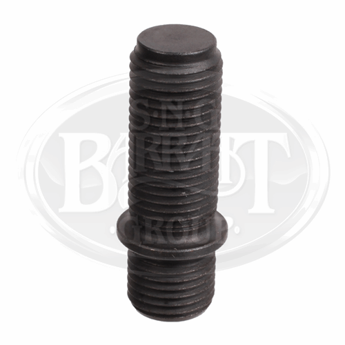

Has anyone ever removed the wheel studs from a Mark VII hub? Do they press out like modern studs? They appear to be staked in the back so I'm not sure if that means they can't be pressed out.
Hi Thorsen,
I have not personally removed a wheel stud from a Mark VII, but SNG Barratt shows that the studs are threaded:
Barratt gives the part number as C13365 and shows them in stock.
I assume you could grind away the staked area, install two lug nuts and jam them together, then turn the stud out.

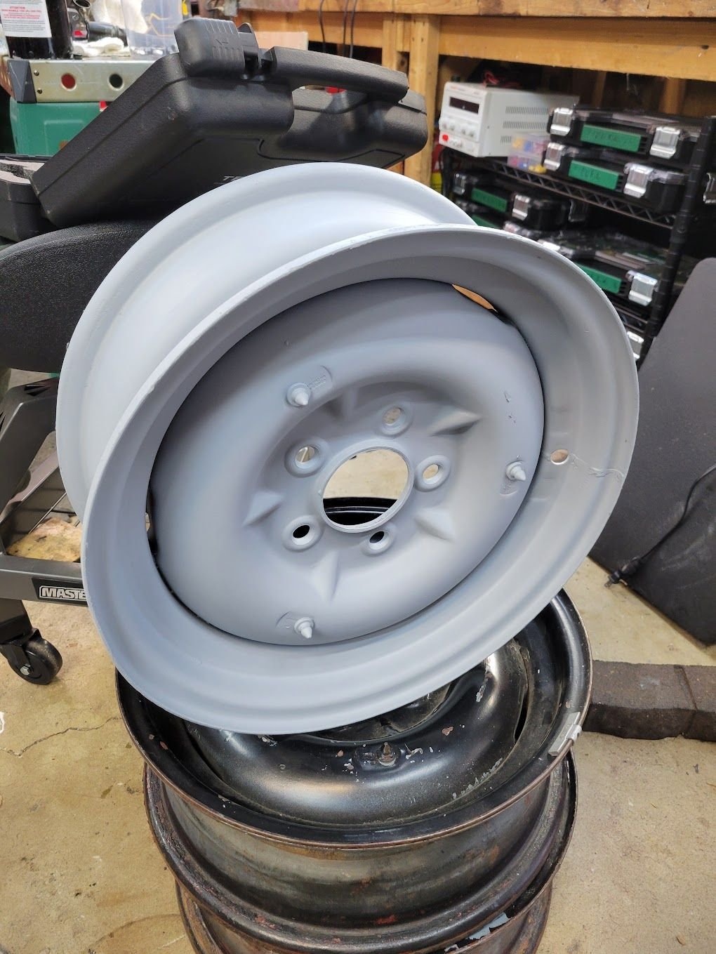

Got a couple items done today after work. I finished sand-blasting the wheel for the spare tire and got a coat of primer on it. I'll get some paint on it tomorrow and call the tire shop next week. My research showed that 215/70-16 tires will fit so I'm going to order and have them mount a single Vredestein Quatrac so I can check clearances. I have those tires on my MGB and have been very happy with them.
I gave serious consideration to buying a set of Portowalls but decided not to. I love the look but reading through the reviews made me second-guess myself.

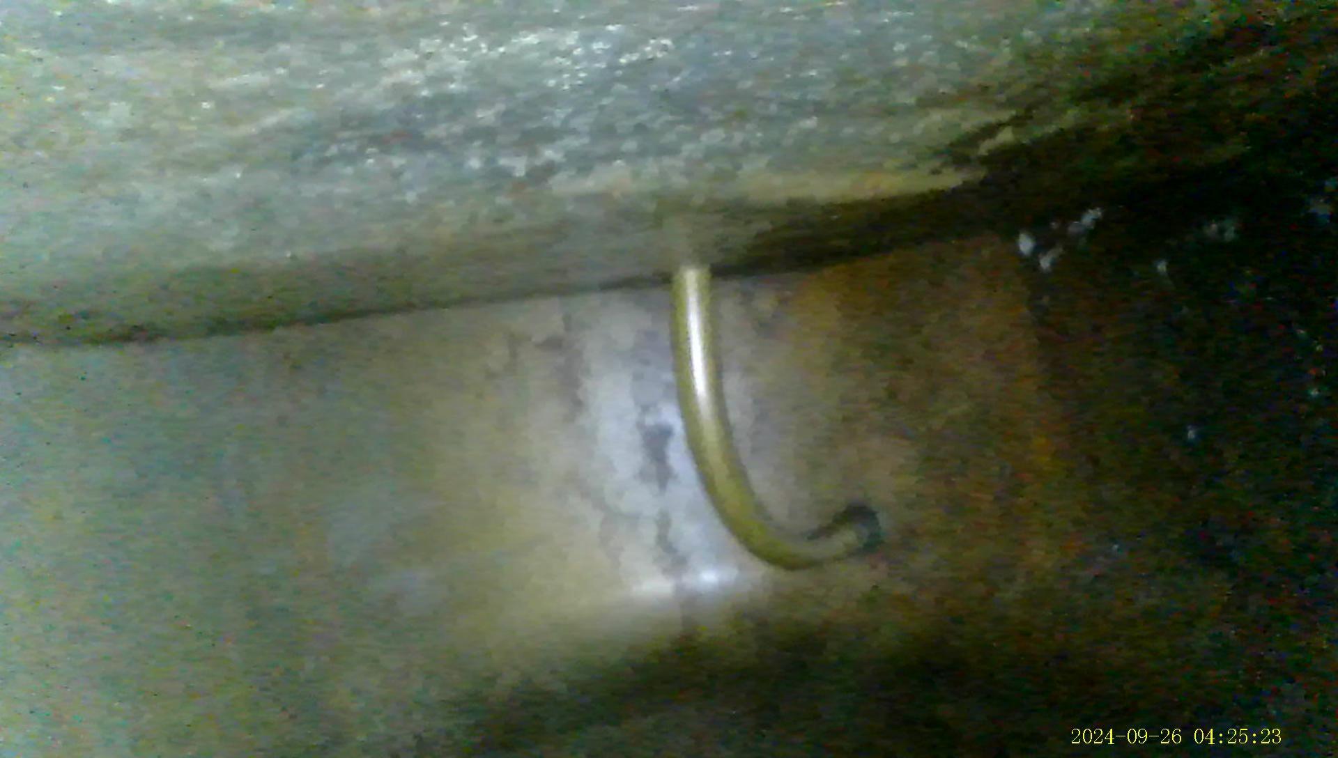

I also stuck my borescope into the fuel tanks. The left side tank was remarkable clean and empty.
The right side tank was about 1/2 full of fuel and was hard to judge how clean it looked, but I will drain it this weekend so I can assess.
Going back to the engine, I filled up cylinders 2, 4, and 6 with Marvel Mystery Oil last night. This morning cylinders 2 and 6 were still full of oil while #4 was empty. I filled #4 up again and will check the level again later tonight. If it's leaking that fast that makes me think the rings are shot.
I also pulled the cam covers and it appears that none of the valves are stuck - from what I could tell without rotating the engine. I'm going to let the MMO do it's thing for the next few days then pull out the cylinder leakage tester.

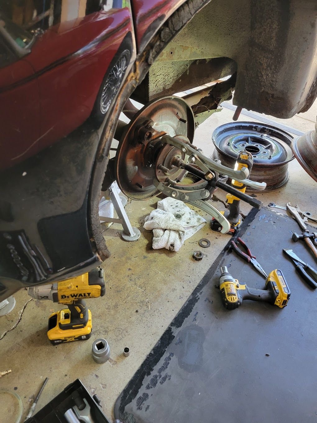

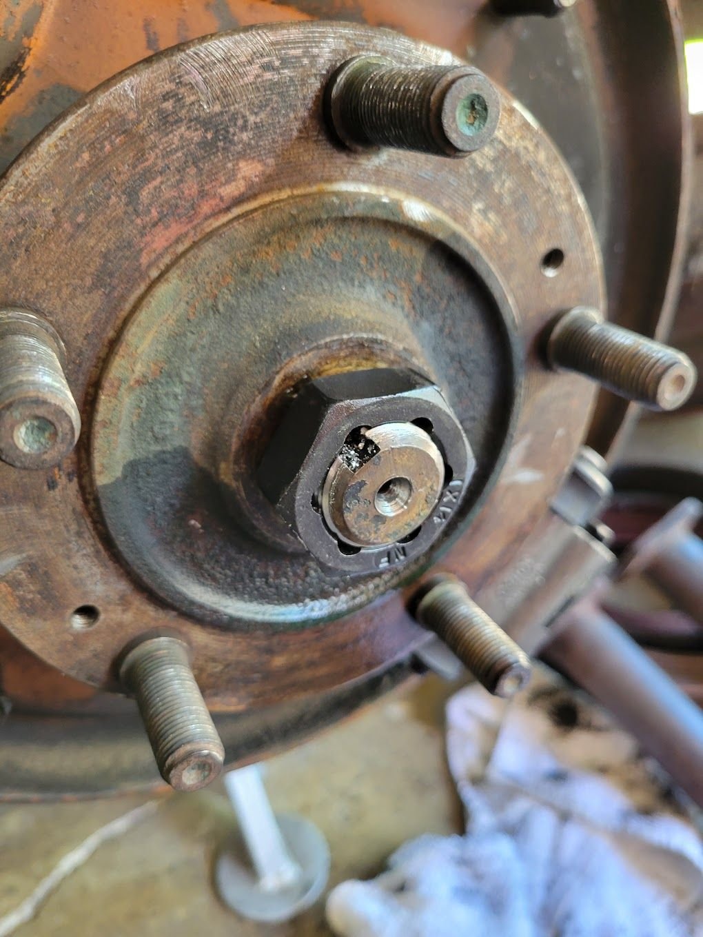

Next I started working on removing the rear hub. The nut came off easily enough but the hub resisted all my efforts at removal. I put a puller on it, I vibrated it with an air hammer, and I sprayed it with penetrant. No luck there so I moved on to the engine.

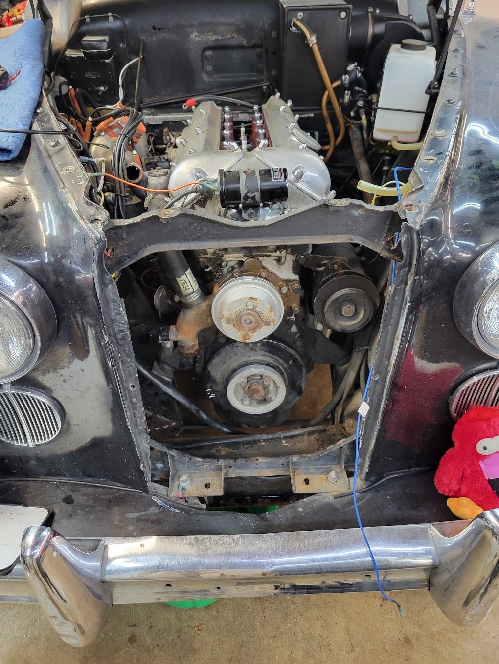

I pulled the valve covers off and rotated the crank to make sure none of the valves were stuck (they all appeared to be free). I started with #2 which is the one that showed 0 compression. I hooked up my air compressor to the spark plug hole and with the #2 piston at BDC and both valves closed, you could feel the air escaping out the intake port.
I pulled the head and didn't see any smoking guns. The head gasket looked fine and I didn't notice any cracks. I'll pull the cams off tomorrow and pull the valves to see what they look like.
The one good thing was the brake rotor I picked up looks to be a perfect fit. So I have that going for me.

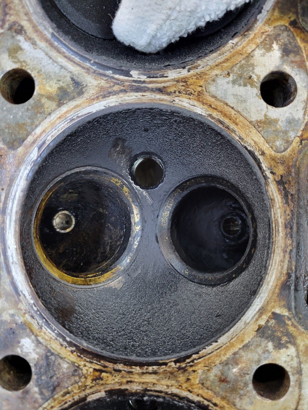

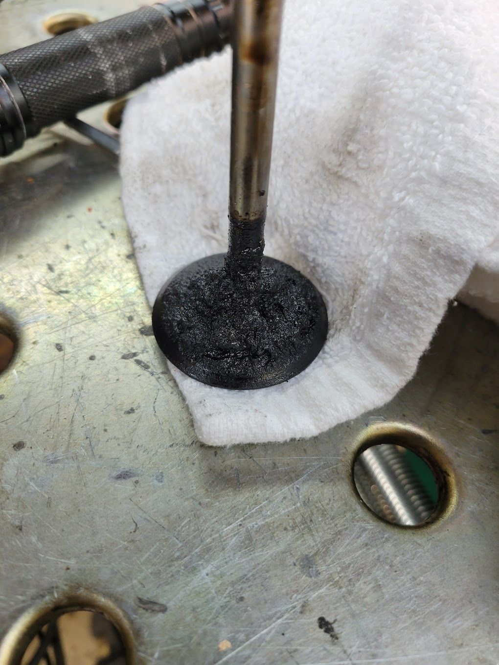

Today the search for the smoking gun that caused 0 compression with an audible hiss of compressed air through the intake port in #2 continued. I removed the #2 intake and exhaust valves.
#2 intake had some build up but it was soft and not preventing the valve from closing. Valve springs were good and not broken.
I didn't see any cracks in the #2 bowl that would cause 0 compression.

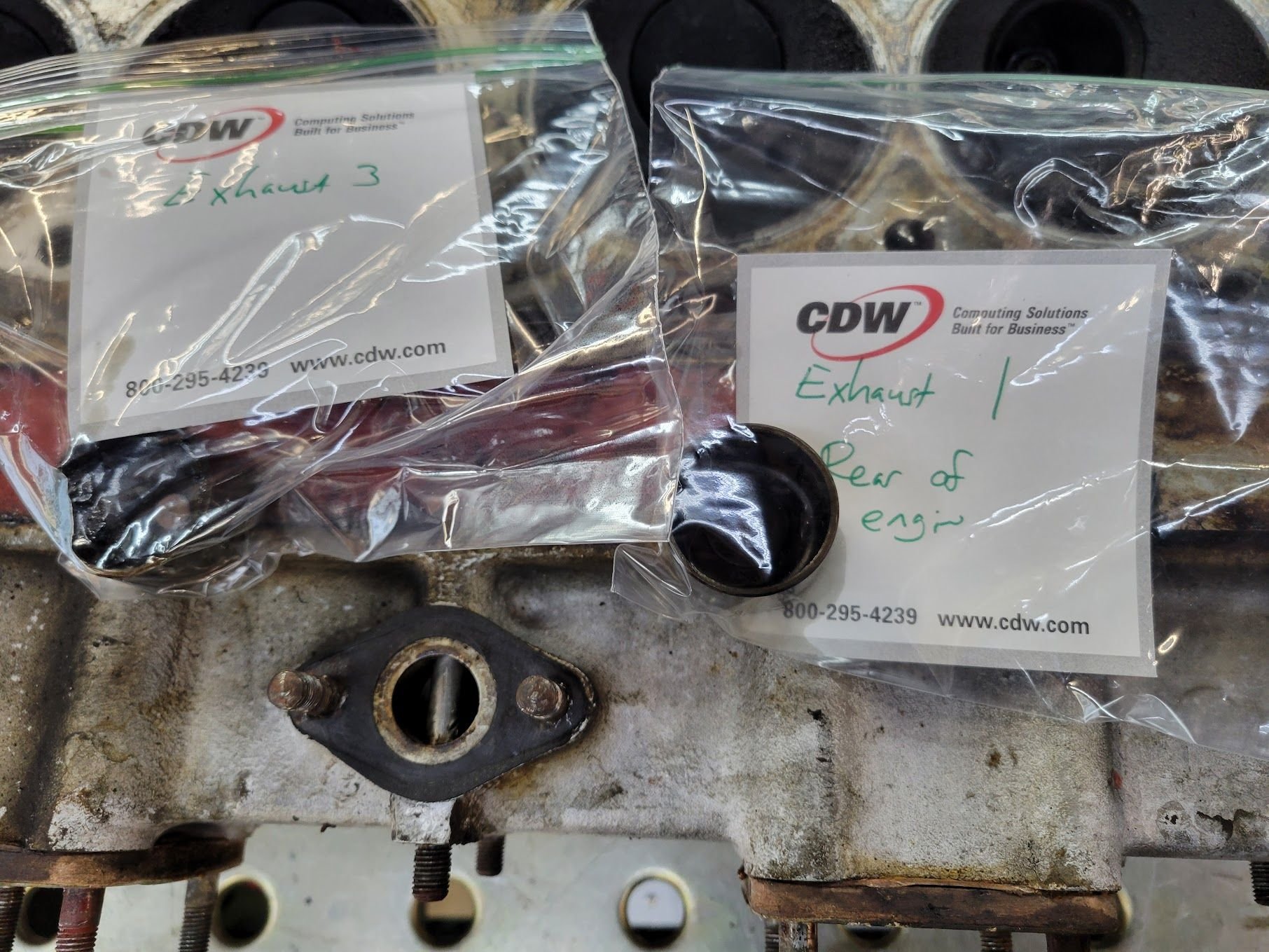

I did make sure to tag and bag each lifter, shim, valve springs, and keepers as they came off.

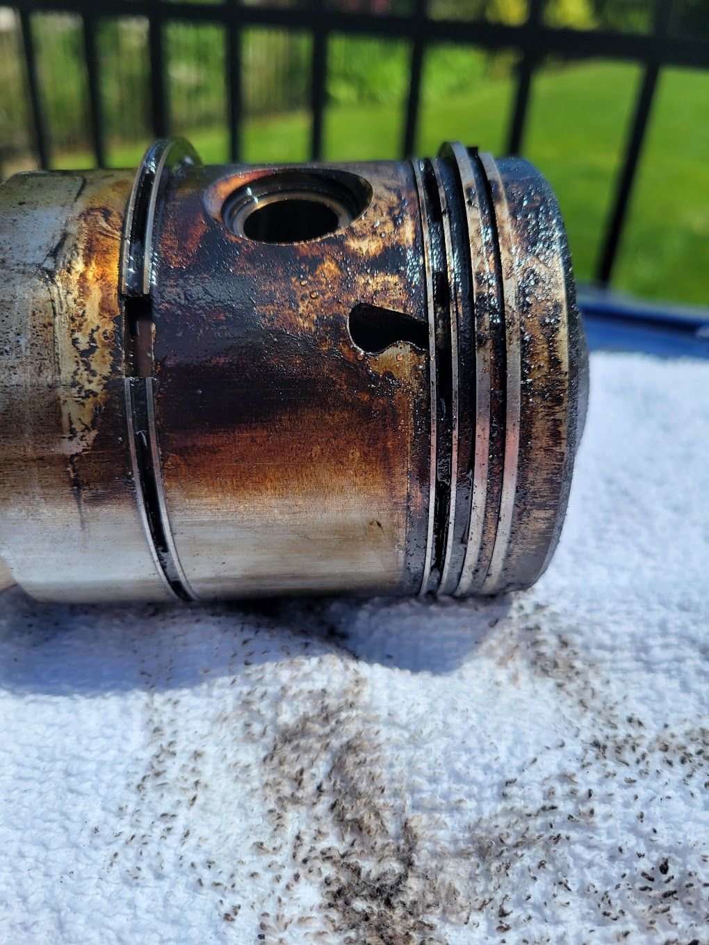

At this point I was frustrated and confused as to why I had no compression so I did what was next. I drained the 2.5 gallons of fresh oil I just poured in a few days ago and dropped the pan. #2 piston came out with only a slight fight.
The two top compression rings were free and rotated smoothly. The top and bottom oil control rings were sludged up but I didn't see any holes in the piston or broken rings that would cause 0 compression. The cylinder wall was smooth with no vertical scoring or holes. The head gasket was the metal version and showed no combustion leakage.

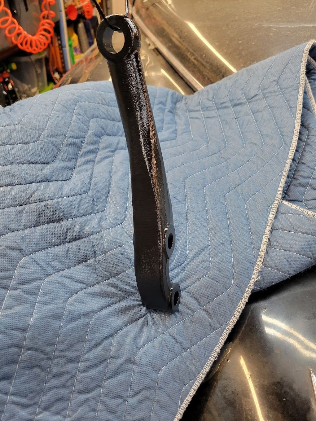

Deciding that the car would share no secrets, I moved on to something easier. The left side steering arm and tie rod came off so they could be cleaned up.
After a trip through the sand blaster and some paint the control arm is ready to go back on. The tie rod needs some more help.
I'm also still struggling with removing the rear hub. Does anyone have any secrets to removing these? I ran a 1" x 14 tpi thread cleaning die on the threads, put on a new 1" x 14 nut, then used my three jaw puller again. It didn't even thing about budging.

How did it get a hole in the side of the piston like that?
