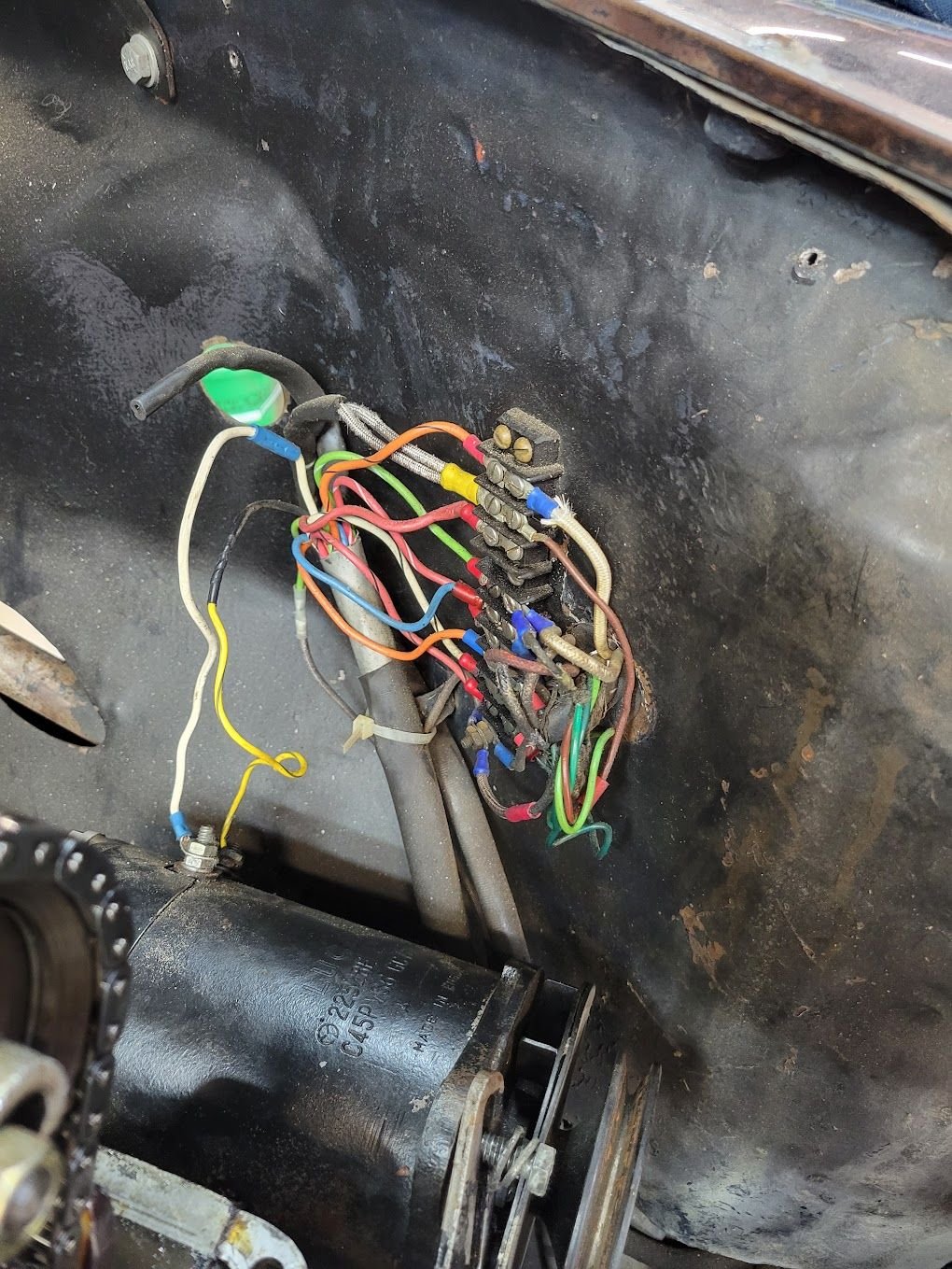

Are these terminal strips at the front of the inner fenders factory? There is a mix of old and new wiring with an abundance of newer crimp connectors.

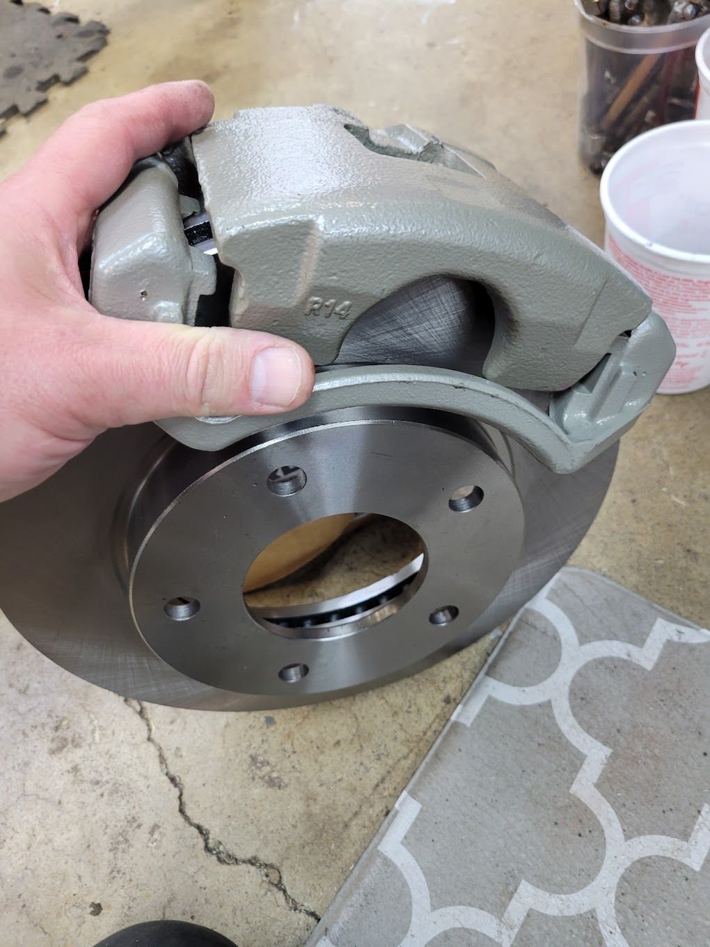

Moving on to the brakes, the UPS man delivered the calipers today. For the front I am going to start the process with a set of calipers from a 2005 Buick Century 3.1L V6. At only $20 a pop it was a cheap gamble.

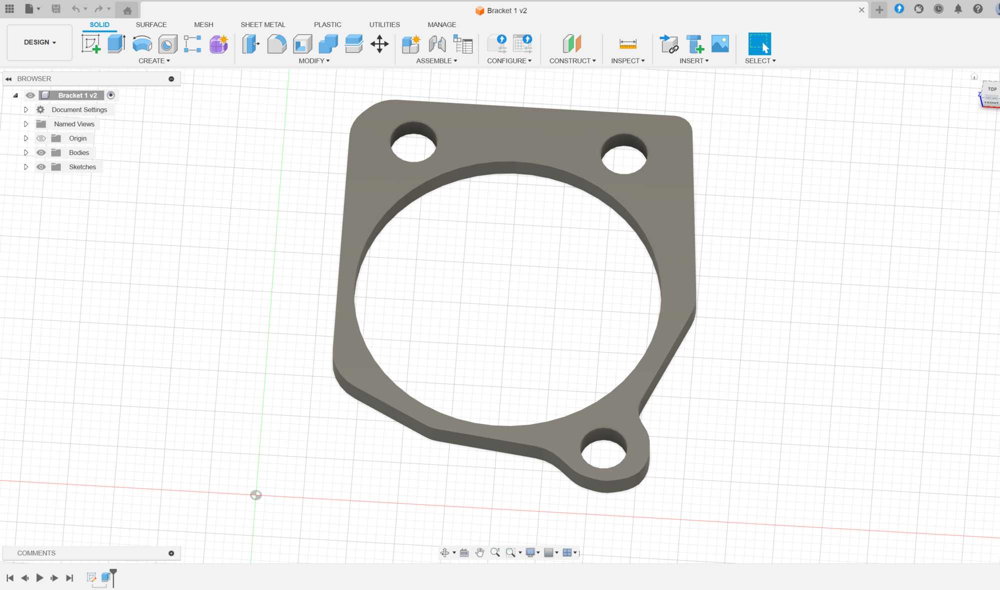

To go from drums to discs I need to come up with a bracket that bolts to the upright. I measured everything out at lunch and fired up AutoDesk to make a model to check my bolt spacing.

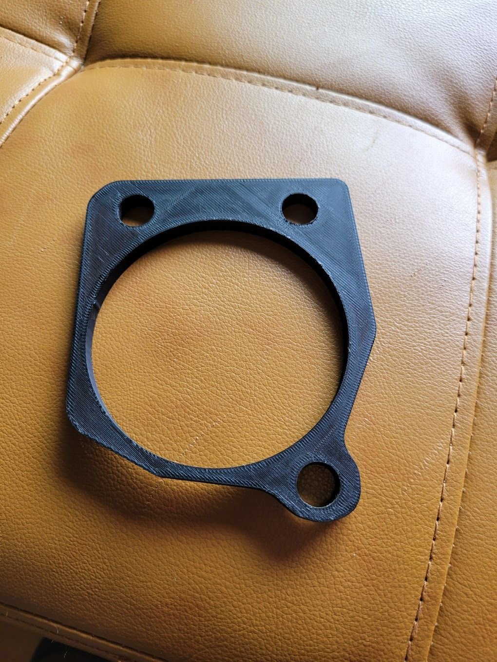

Over the last several I have been using SendCutSend to cut my designs out of metal. I will still use them for the final version but my nephew had a great idea to 3d print the test versions to save money and time.
He was right - this printed in about 30 minutes.
I used it to check the accuracy of my design. I will make adjustments and add more on the right side to mount the caliper.
