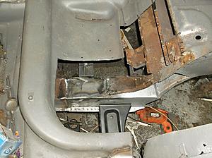

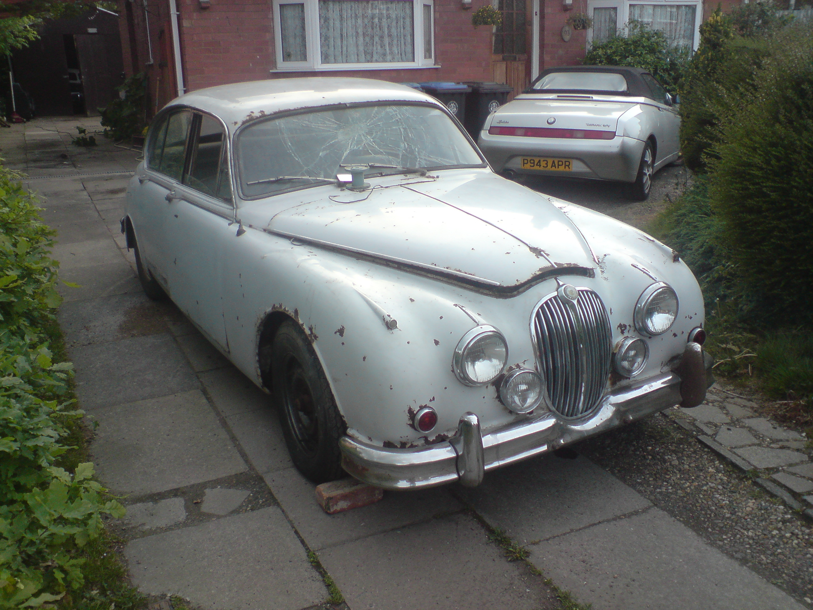

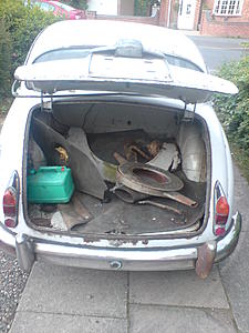

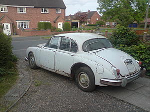

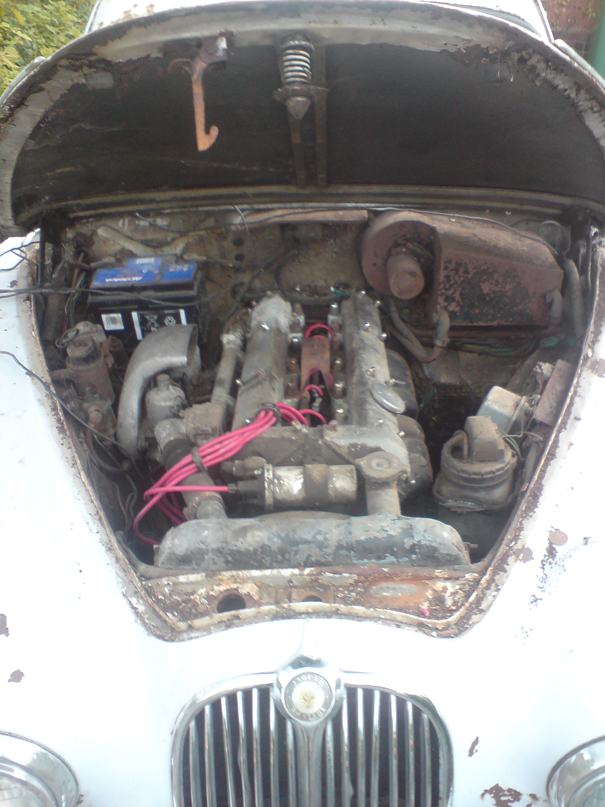

I have attached some pictures of it as found, it was in a bad way and would probably have been borderline if it hadn't been the first one.
I had to cut out the panel behind the back seat (into the boot) and replace this as its was totally rotten. I managed to get one from another shell which I bought from a house clearance.
I don't know why it was soo rotten as the base of the back seat and main floor weren't anything like as bad, I do think there was a mouse nest behind here though which probably didn't help, the little monsters had also checked through the headlining and there was a rat skeleton on top of the engine when I bought it.
When I first found out what it was I made enquires with the major jag clubs (including at various shows) and various historians and no one was interested in it. I thought that it was a piece of history and should be in a museum after being restored by experts but after the lack of interest I thought I might as well keep it and do it myself.

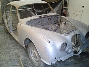

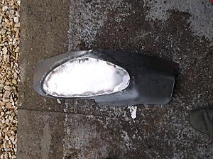

Some more pictures of the bodywork, it needed a lot of work and some of the panels I had to fabricate myself as replacement were either not available of prohibitively expensive and poor quality (like the inner rear arches).
