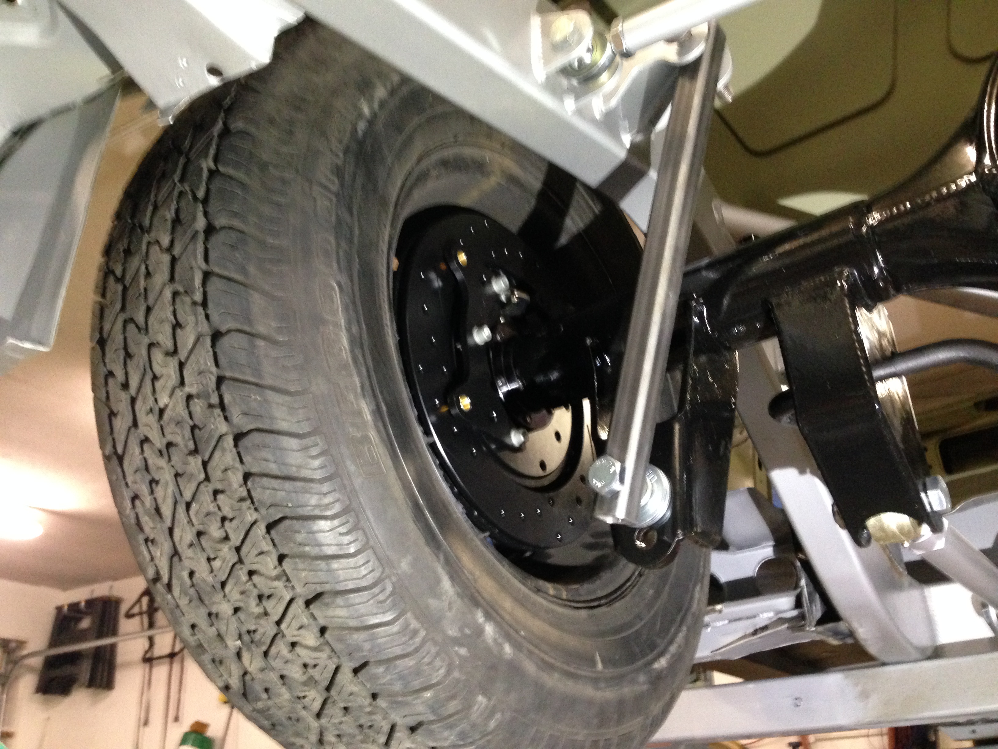

Updates.

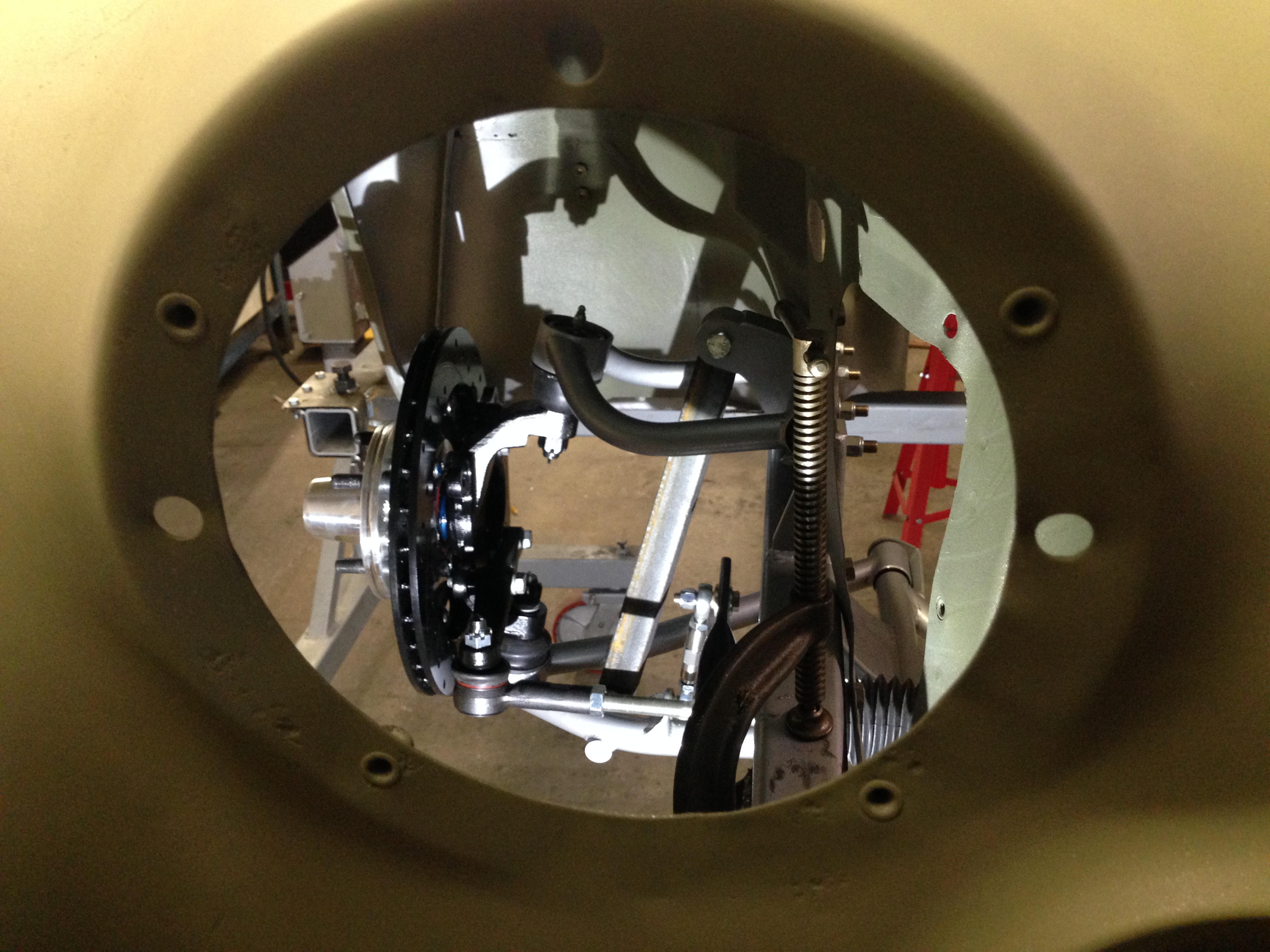

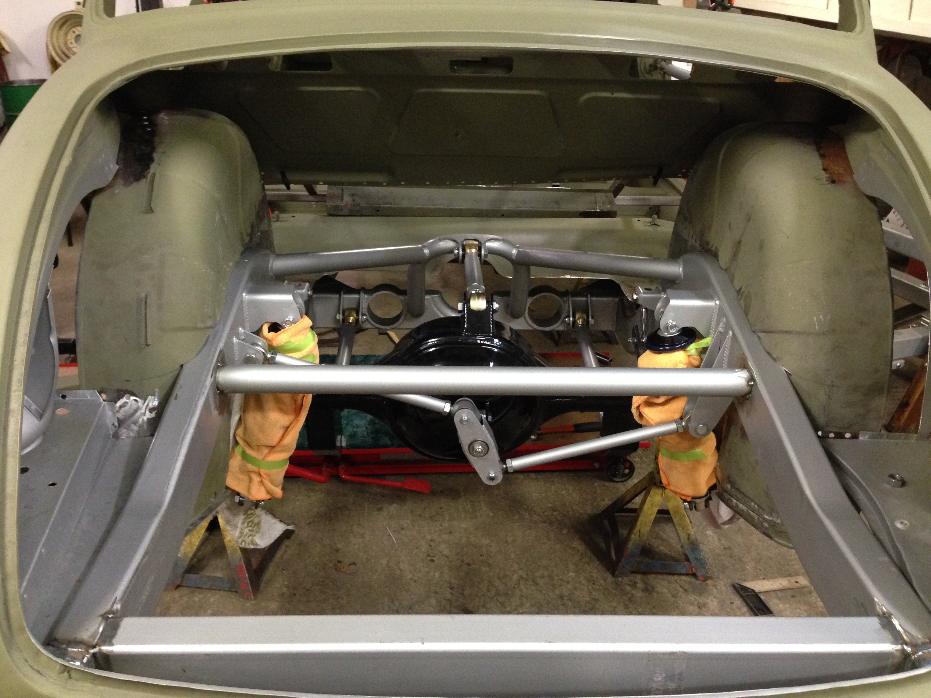

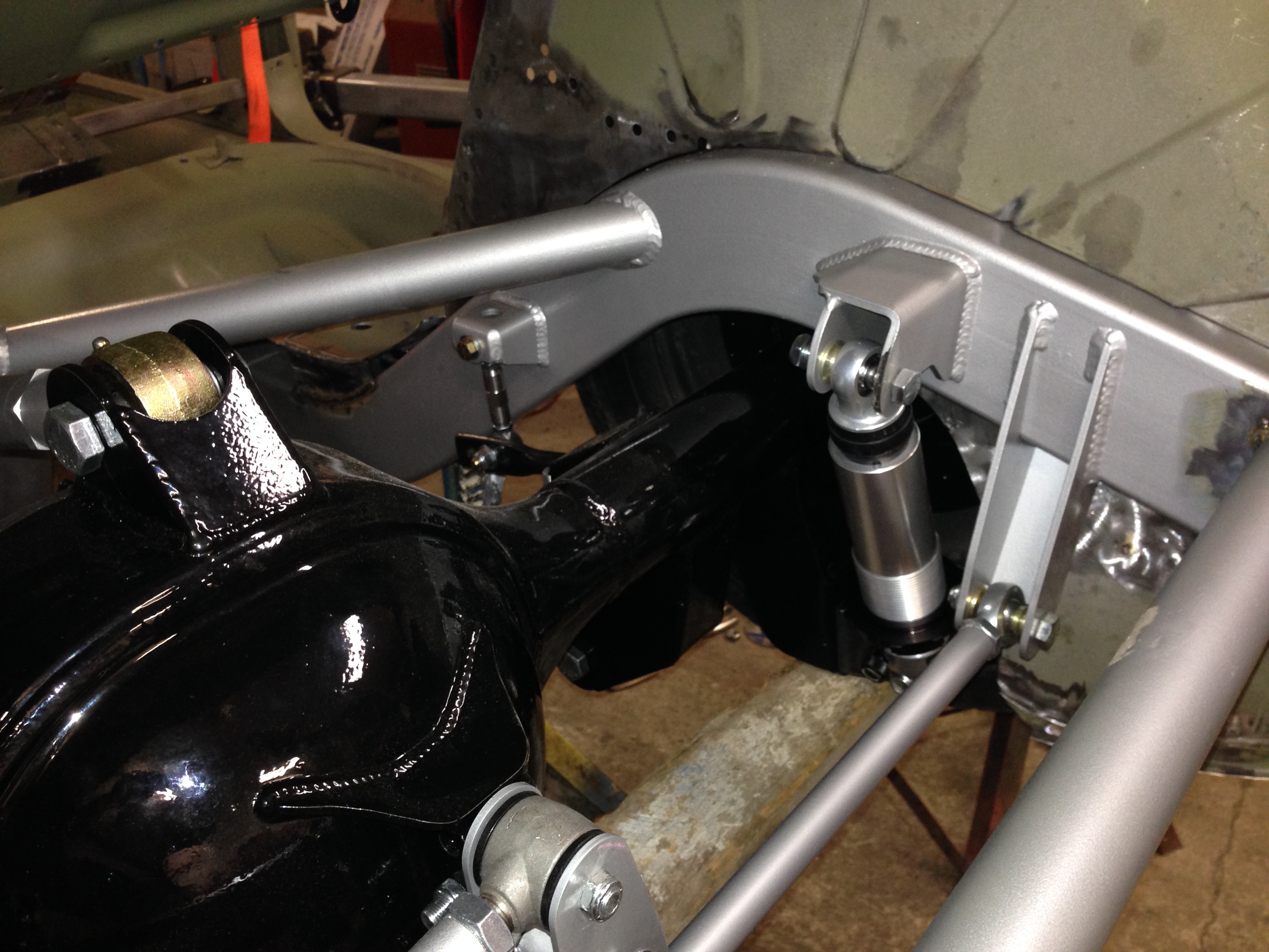

Front and rear suspensions bolted in over the last three days. Not the final in, of course. Calipers not mounted, as they will not fit in the 15" rims. Front sway bar frame mountings brackets need final fit and welding.
Can't take it, coming off the lift tomorrow, and we'll take it outside for pictures.
100% happy with the wheel positions. More measuring and maybe a front fender lip roll, prior to ordering the wheels.

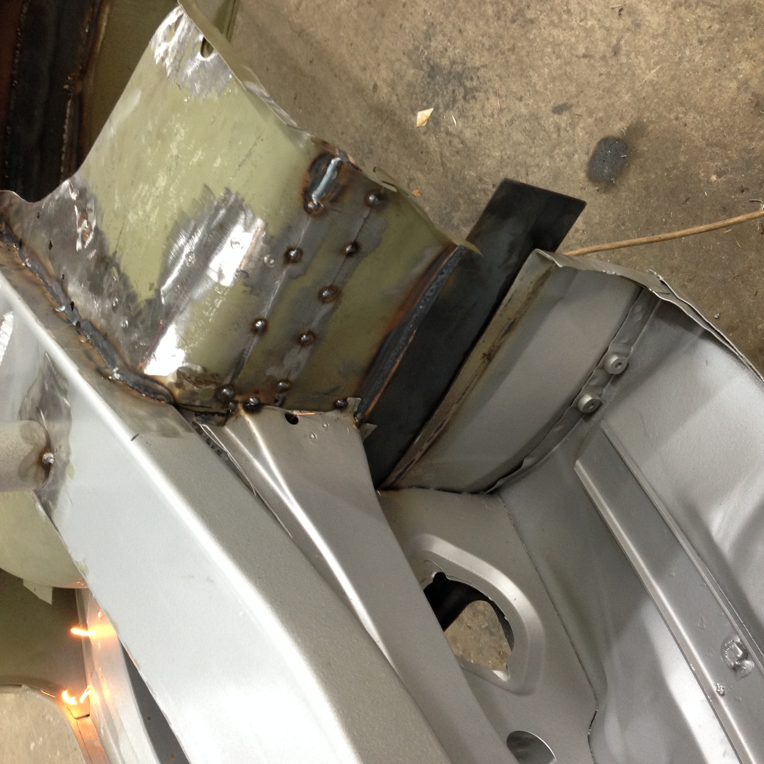

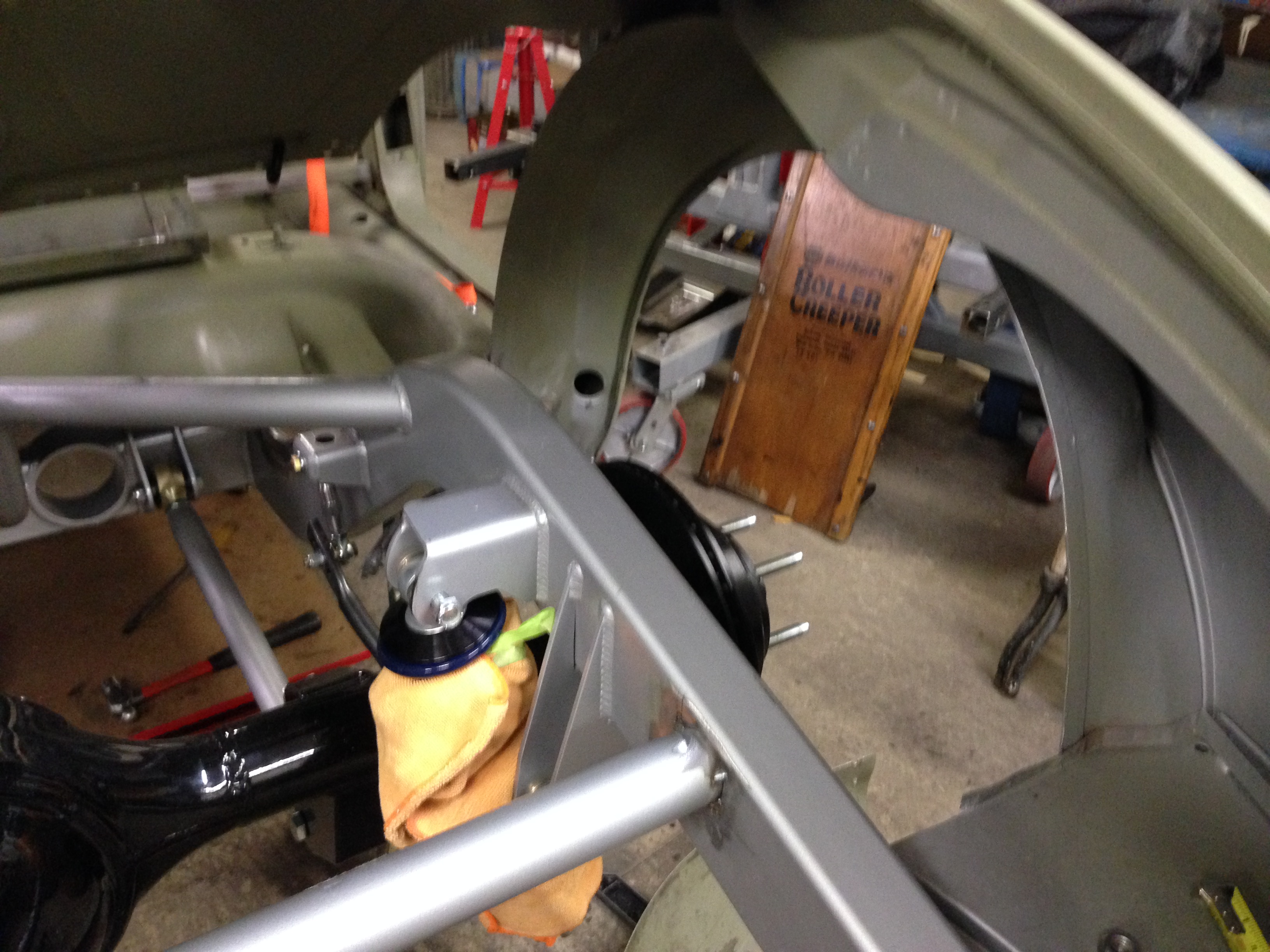

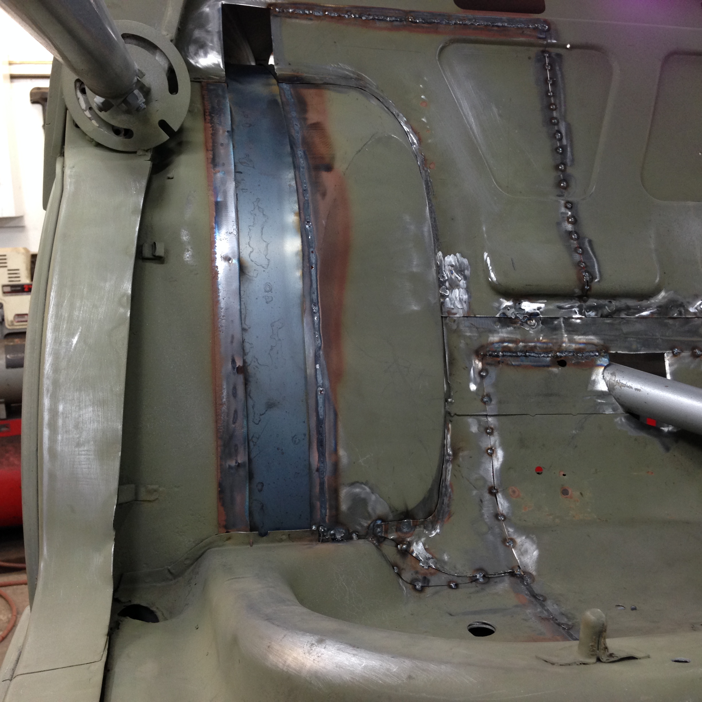

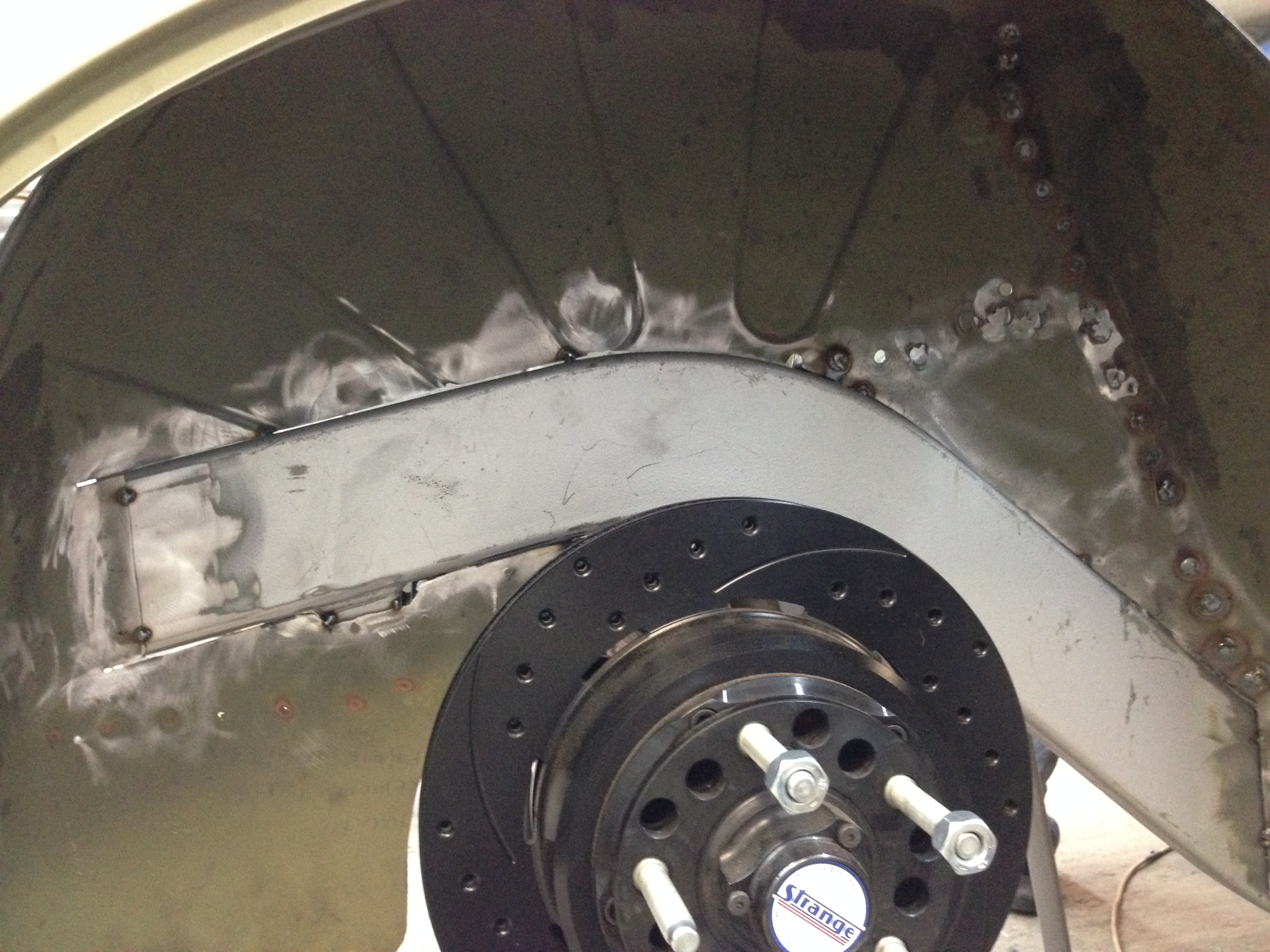

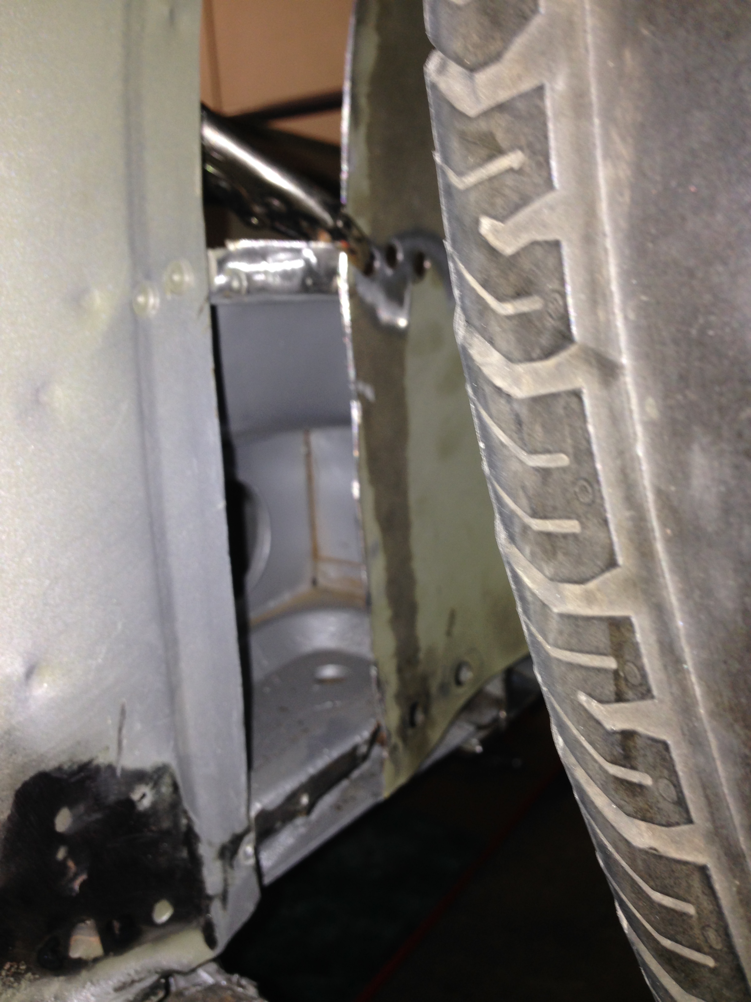

This week - more Swiss Cheese, and cut and paste. I'm trying to use as must of the factory stamped panels as possible, knowing that after they get positioned back it, I'll cut some more out.
Wheel wells are moved in 2 1/8" each side. Tried to prove if I can go with a 9.5" rim in the rear or not. Print calls for a 9". Put suspension in four positions with the shocks - full up, full down, one wheel up/one down (see orange ratchet strap), then reversing sides. Looking more like 9 x17, after talking with the wheel company.
Rear seat pan to the center link hoop has been the most difficult to fit and decide where that cuts need made. Cuts and boxes will be needed to allow for the upward travel of the center link that attached to the top of the differential housing.

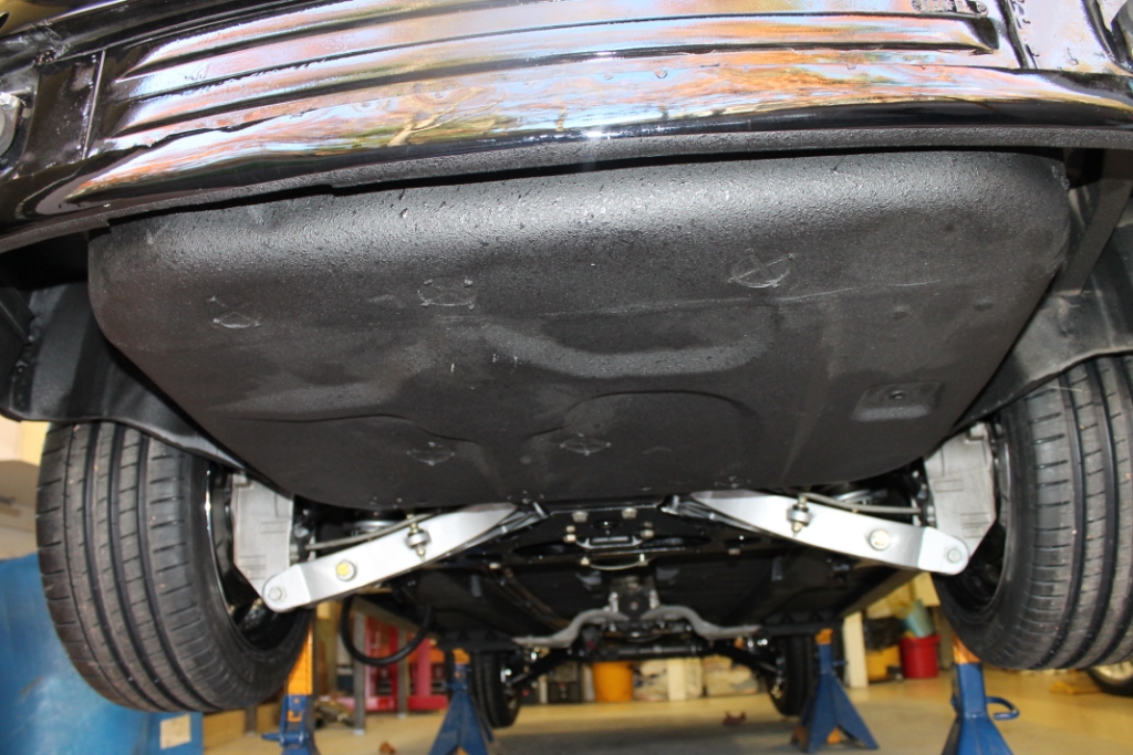

Looking good Clyde. I've learned that fitting complex panels around obstacles is no easy feat, so my hat's off to you - it takes a lot of time to get it right.

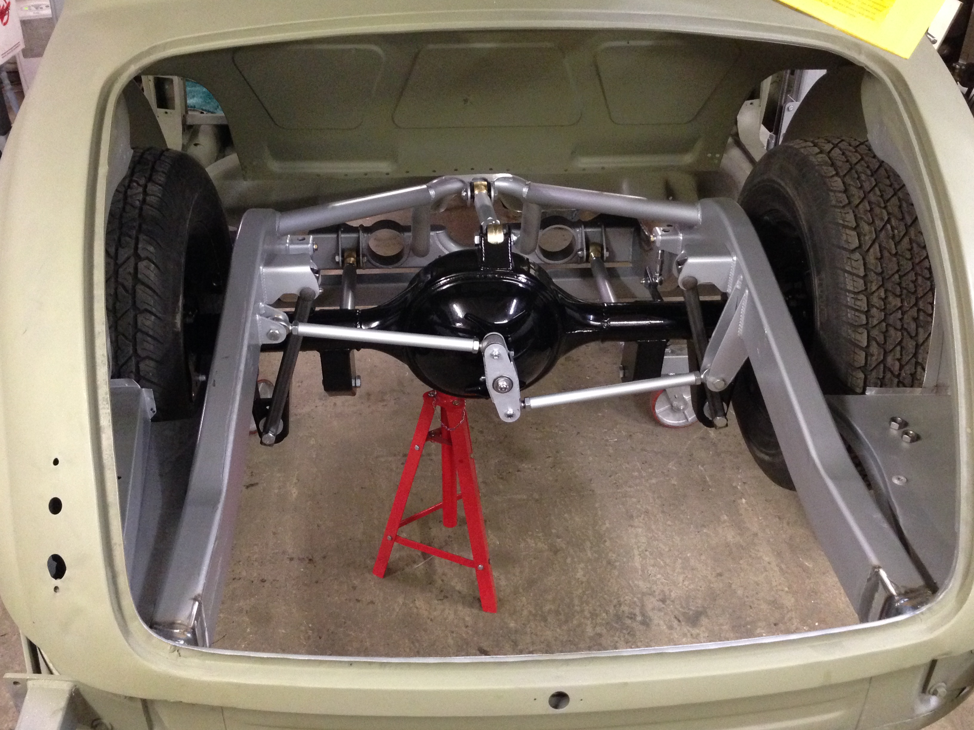

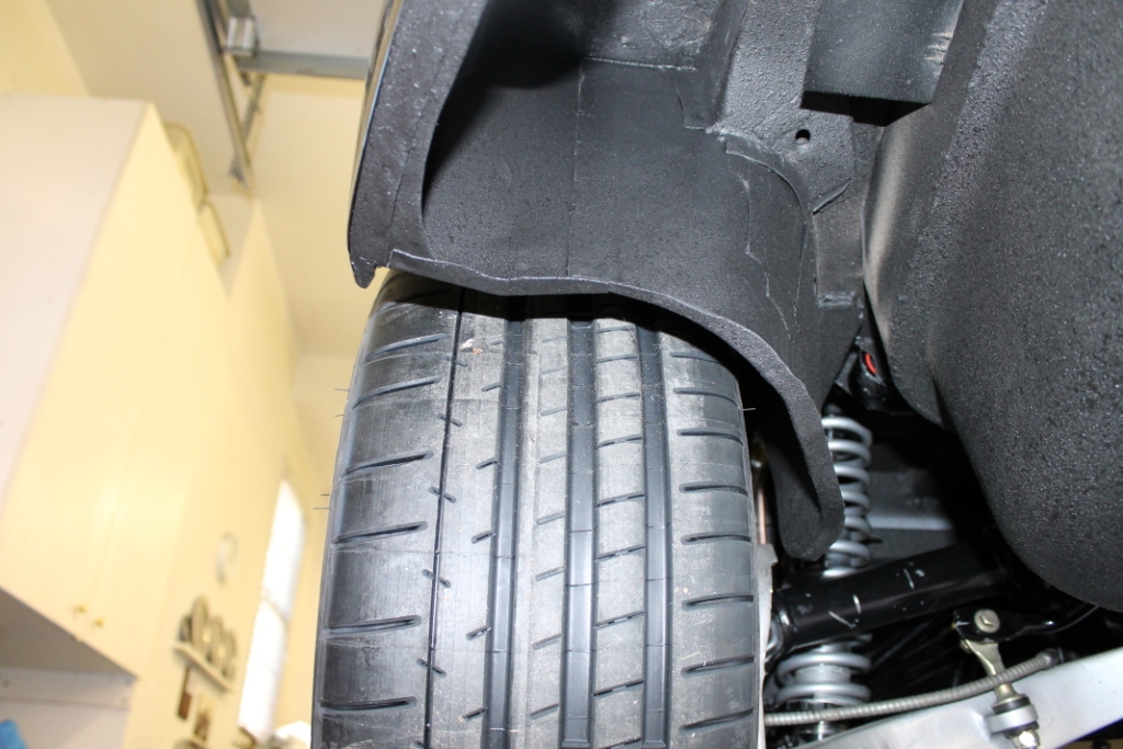

I'm posting a couple of pics of the beast's rear end to show you the clearance I have with 17 x 8 wheels. At full drop of the IRS I have a full 2 inches from the inner tire/wheel to the inner fender - the only exception is the lower rear inner radius which would need to be boxed a bit. I'd have no problem fitting 9 inch wheels in the stock wells. With a live axle and an additional 2 inches from moving the inner well I wouldn't think you'd have any problem fitting 10 inch wheels. It looks like your frame rails may be the limiting factor? If you haven't already, purchase one of those Wheelrite jigs which you can set for your offset and wheel/tire size and rotate at different suspension positions to check clearances - they're cheap plastic but they work.
Attached Thumbnails 1960 MK2 not a restoration, not a rusto rod, just a Bonus Trap-rear-1.jpg   1960 MK2 not a restoration, not a rusto rod, just a Bonus Trap-rear-2.jpg

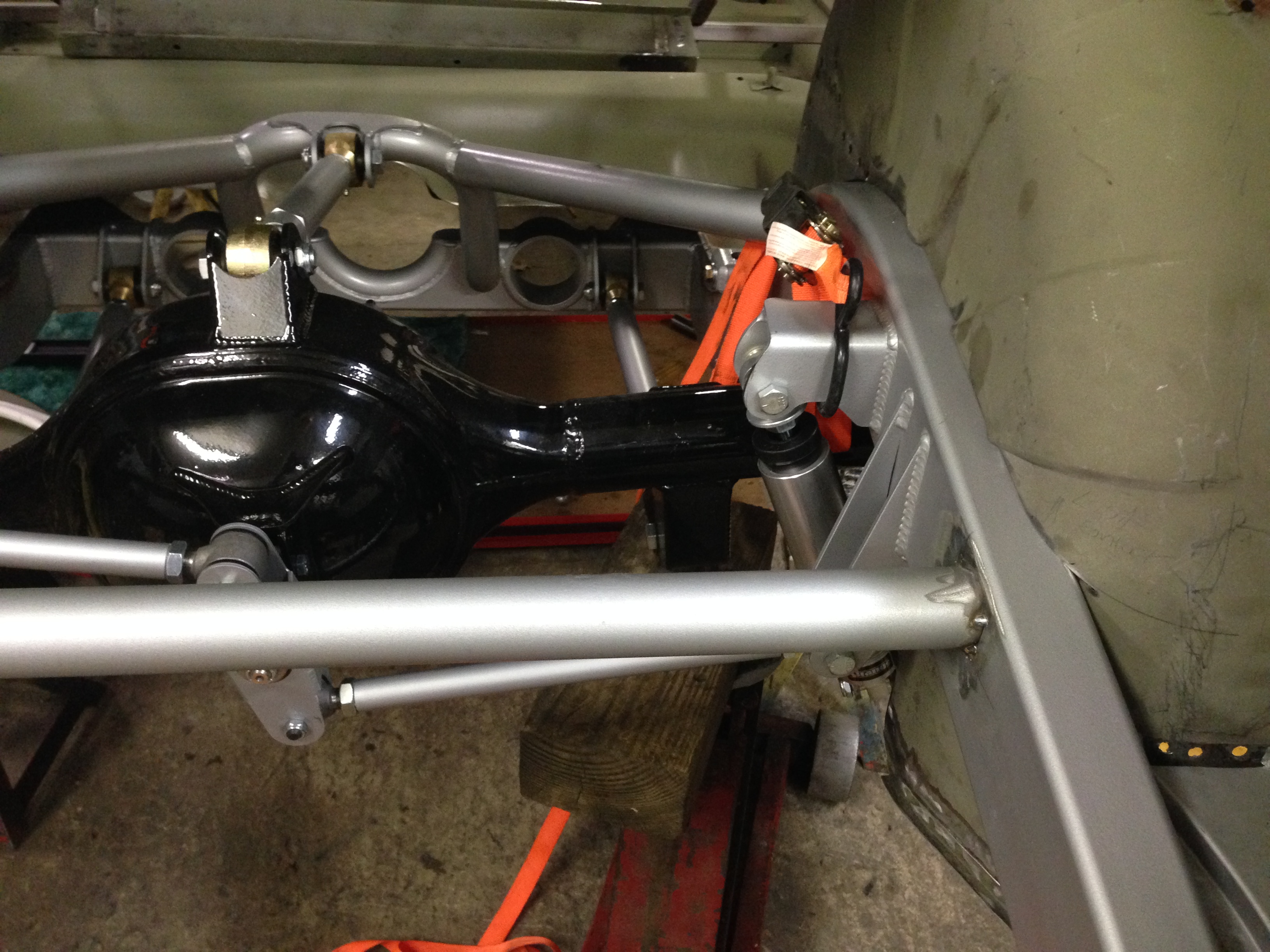

Because it's a straight axle I have to deal with what I would guess to be a greater swing in and out at both top and bottom, depending on the axle at full extension and compression on opposite sides. I'm going for one more round of measuring, now that I have lip to lip measurements on the wheels.
I've dubbed myself "King of Take it Apart", but it is taking the "Three Kings of Put-it-Back-Together" for reassembly, not to mention the additional advice of the "Knight of the Arc Welder".

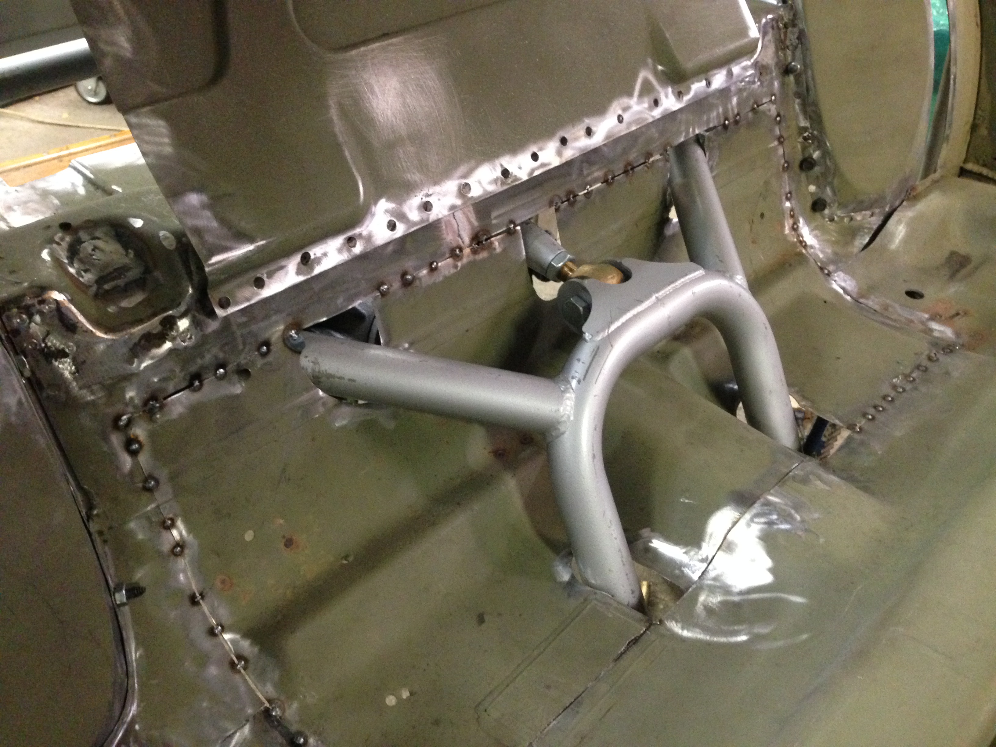

Default Wheel and tire fitment/second check/ back seat
Packing in as much work as I can in three days a week. Doing the dishes and the laundry seems to get in the way.
Doug,
Thanks for the recommendation of the Wheel Rite. Purchased the Percy's Wheel Rite. Turned out to be a must have and a must do. Modified the bottom inside of the rear of the rear wheel wells. Looks like the rear is good to go with 17 x 9 1/2" wheels with 275/40/17 tires.
With 17 x 8" wheels and 245/45/17 tires in the front, it is likely the sway bar is the steering stop. More measuring and calls to AME.
Standing by for a close look at the new Nitto 555 G2's.

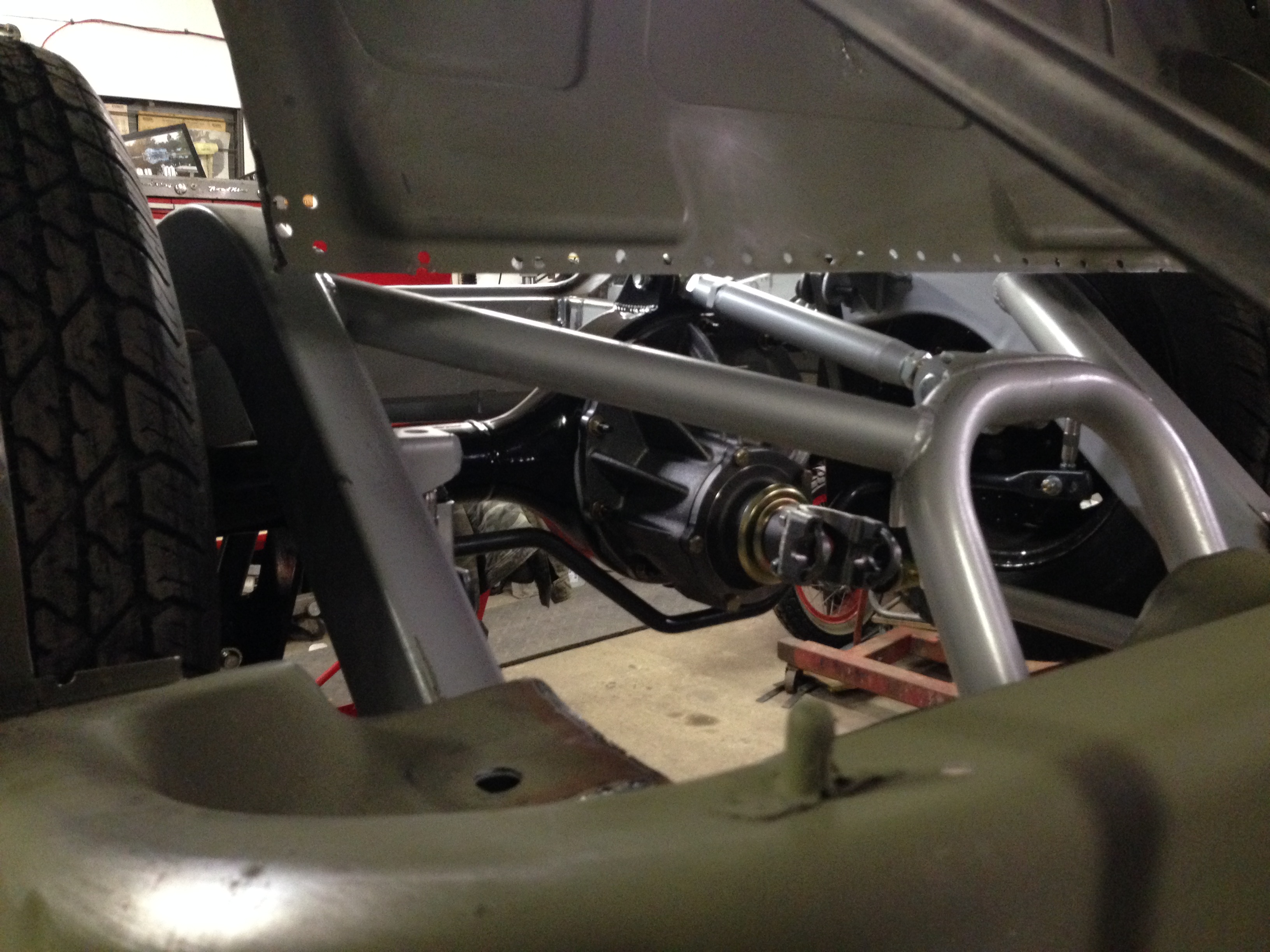

Rear seat pan, rear seat wall, wheel wells are tacked in. Will likely drop the rear end back out and pop the tub back on the rotisserie for final welds on this portion. Also going to close the gap where the wheel wells were moved in.
Picked up a pan and block for mock up. New set of challenges with this portion - putting it mildly.

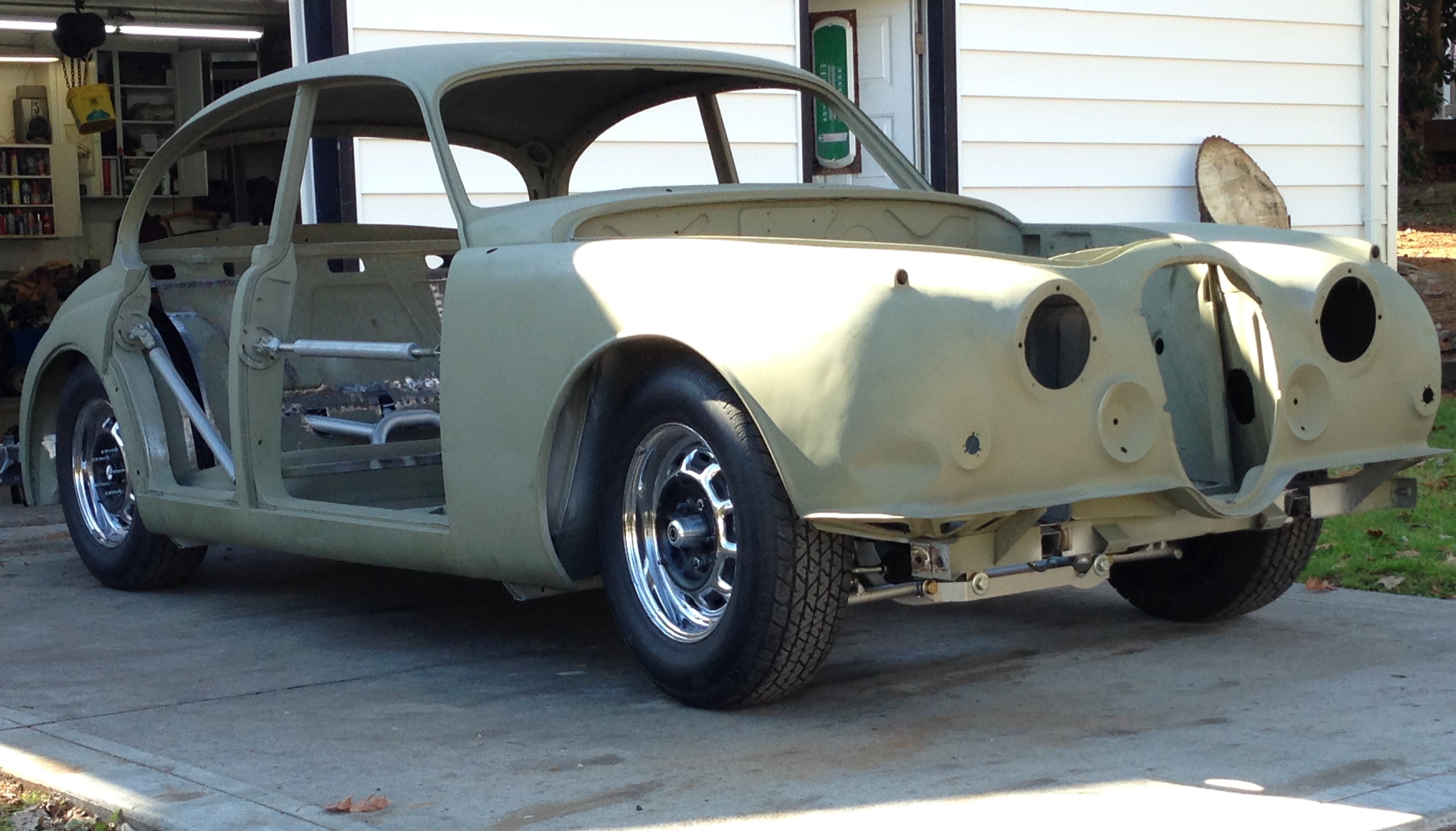

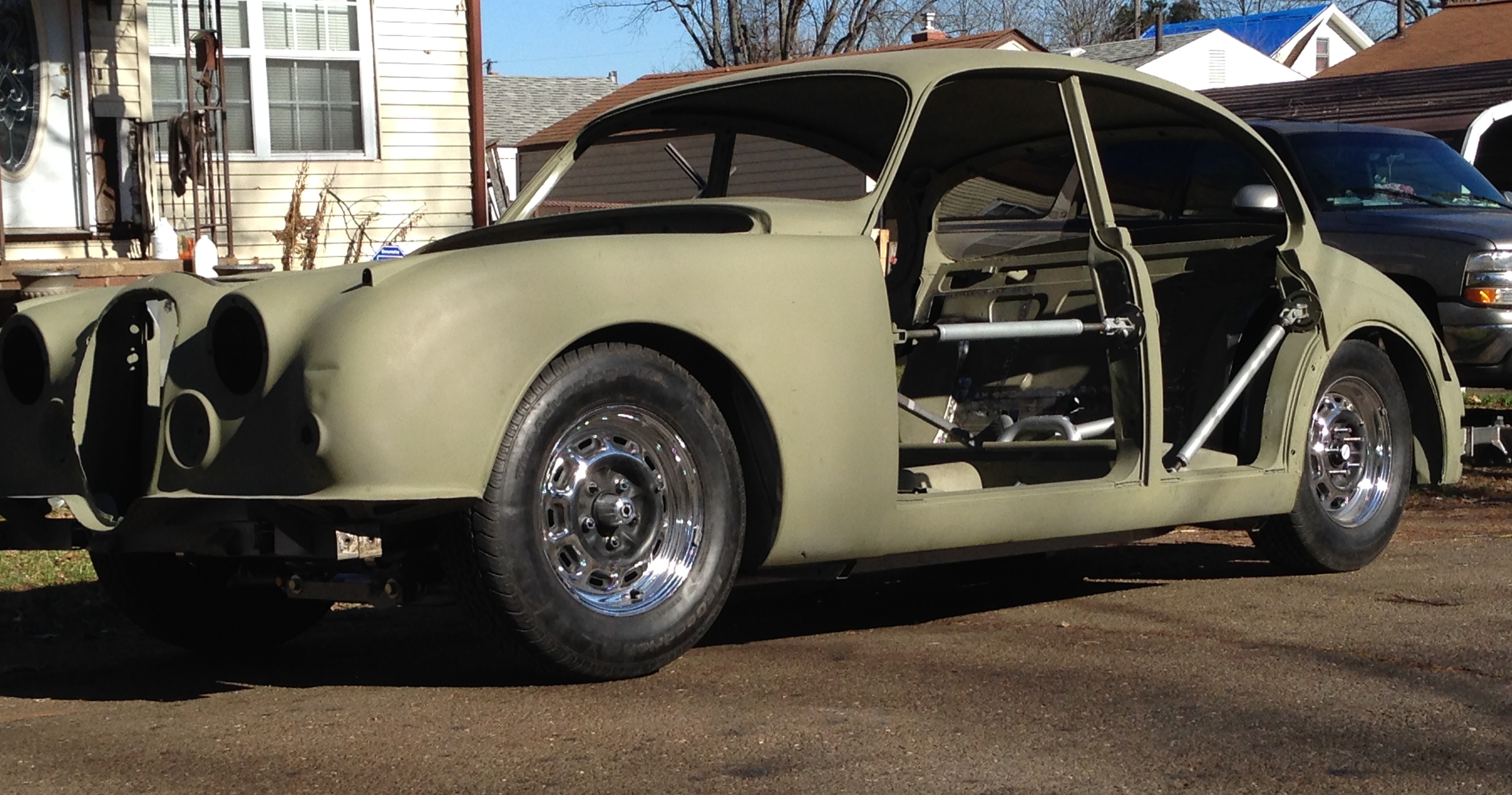

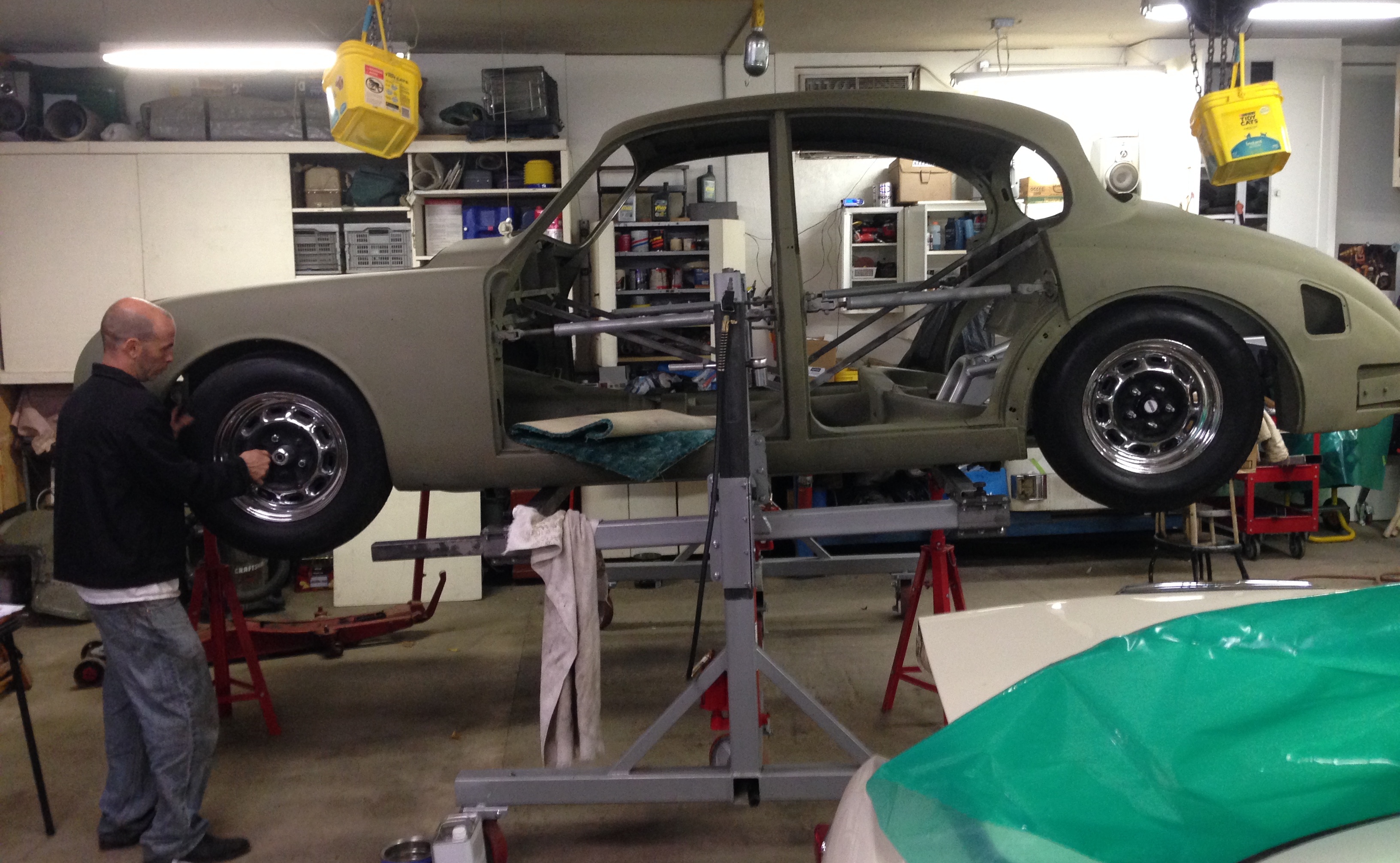

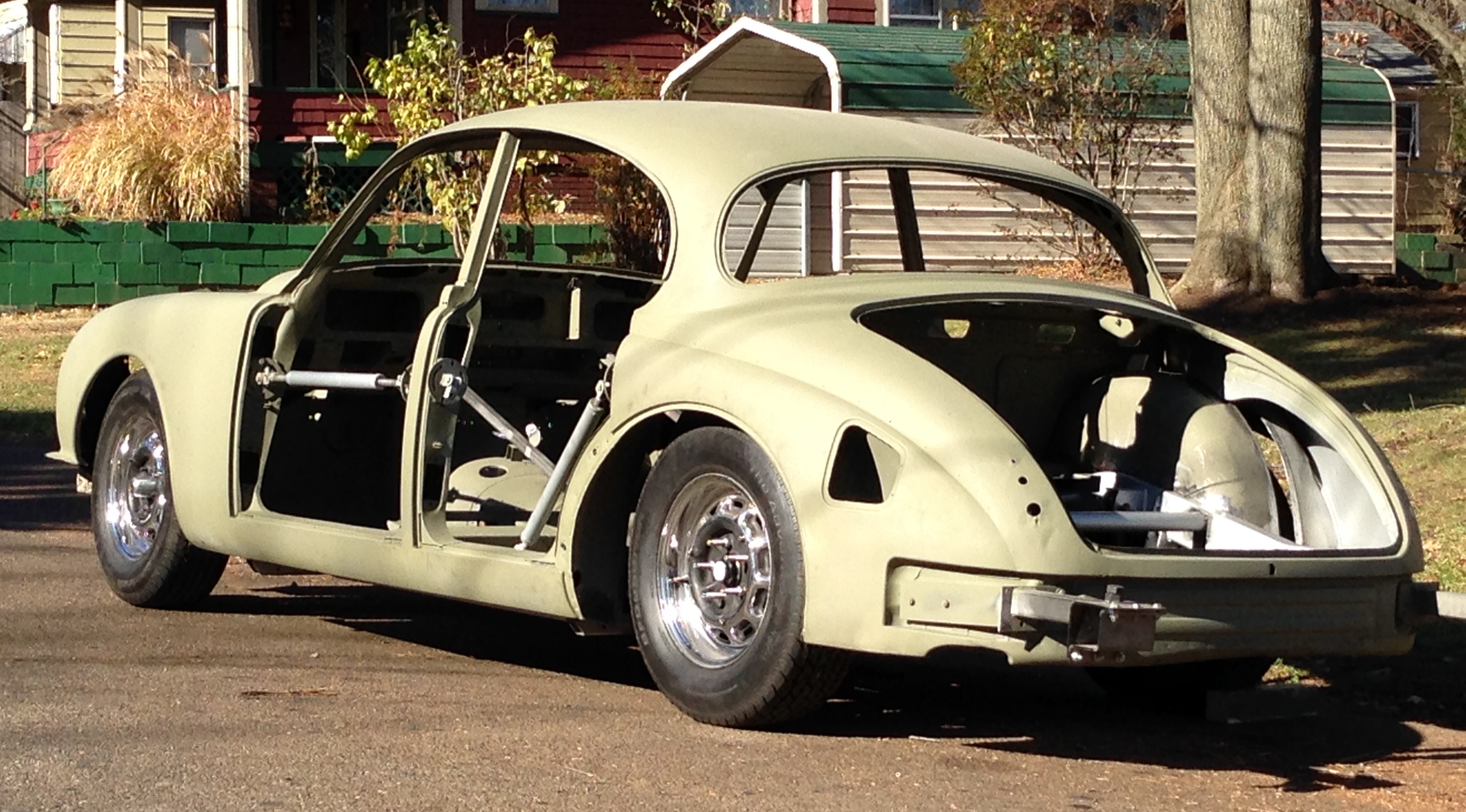

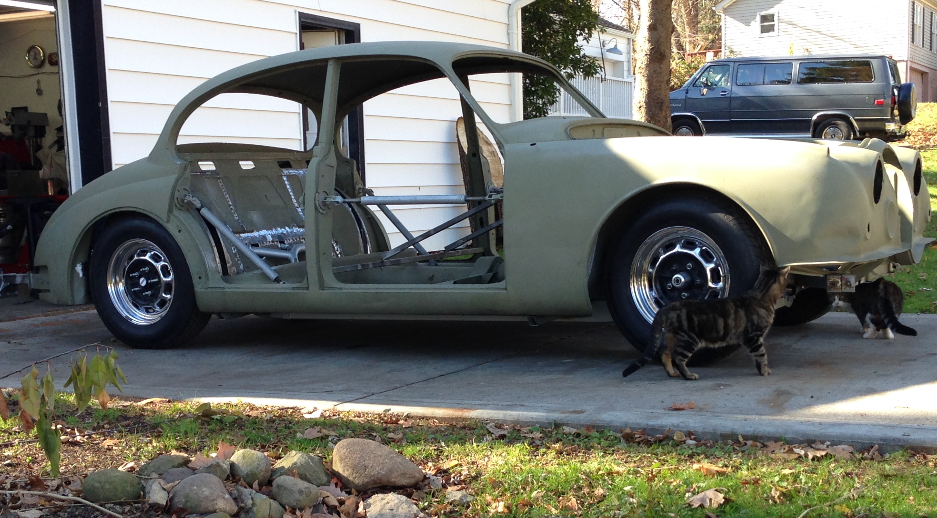

Had to put it on the ground, take it outside for pictures. Great day for these pictures.
Tires are taller than the ones that will be on the car. Stays are in place instead of shocks, so higher in front.
It's back inside on the rotisserie, rear end back out. Welding for seat pan, seat back, and wheel wells should be complete by the weekend.
Thanks for looking.

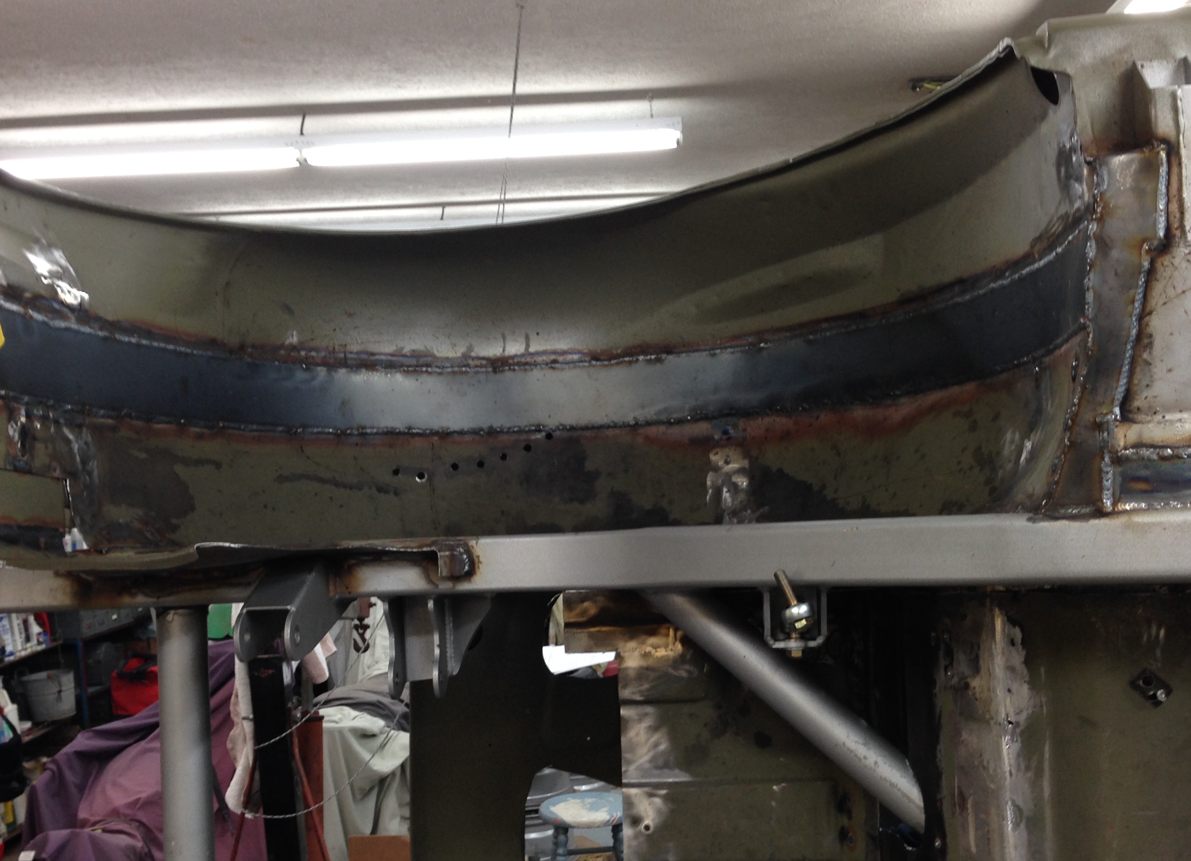

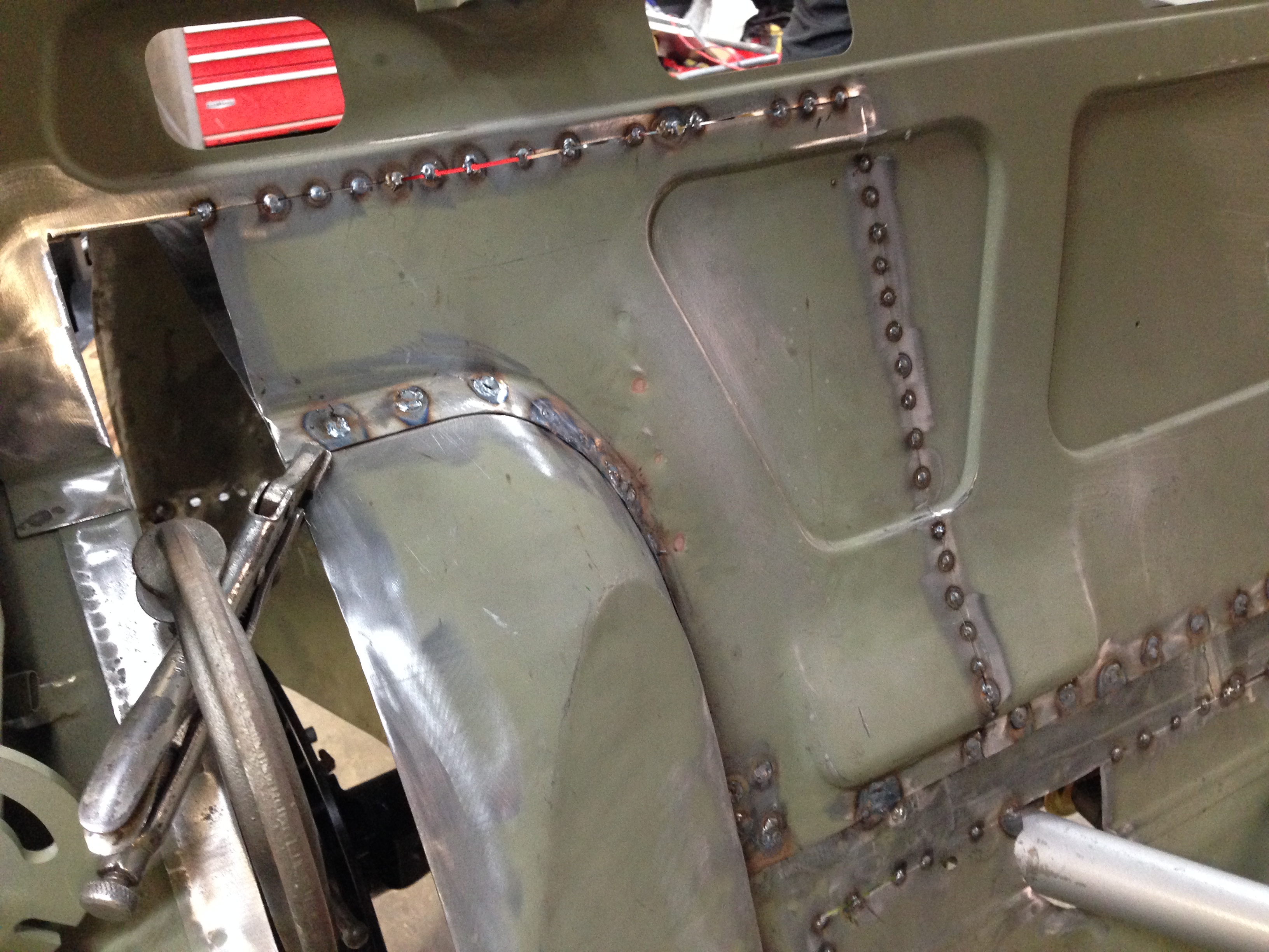

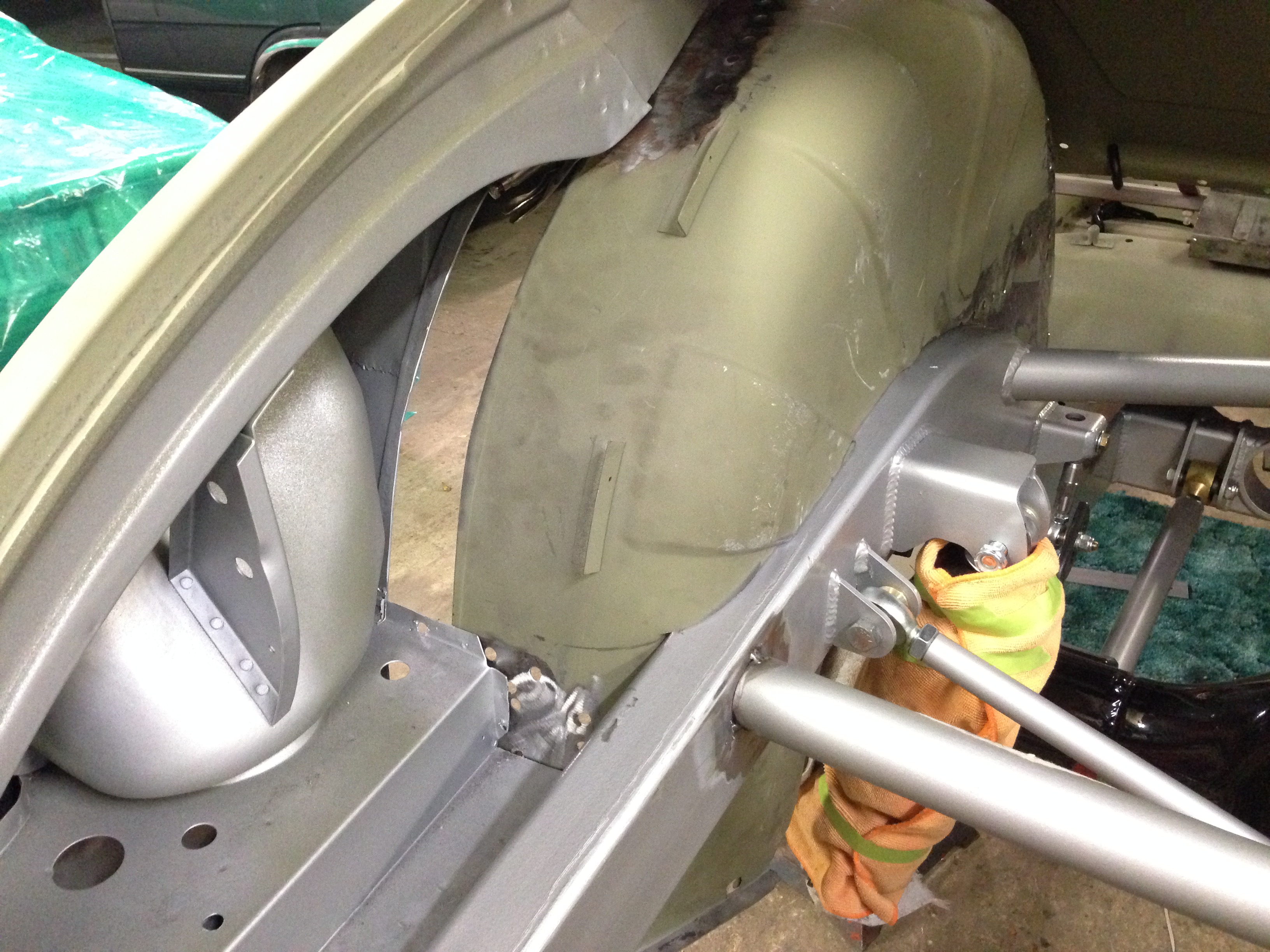

Trying to swear off of the project for a while, as if that will happen. Time to fish or cut bait on the transmission, as it is nearing time for the transmission mount and engine mounts.
Here's the latest on the tubbing. Welder says it is not tubbed, just a mini tub.
Attached are pictures of the "Mini Tub", and jacking boxes. Removed the inside lower curve at the bottom of the rear wheel well. Picture appears to be upside down, car is back upside down on the rotisserie. This makes for more tire.

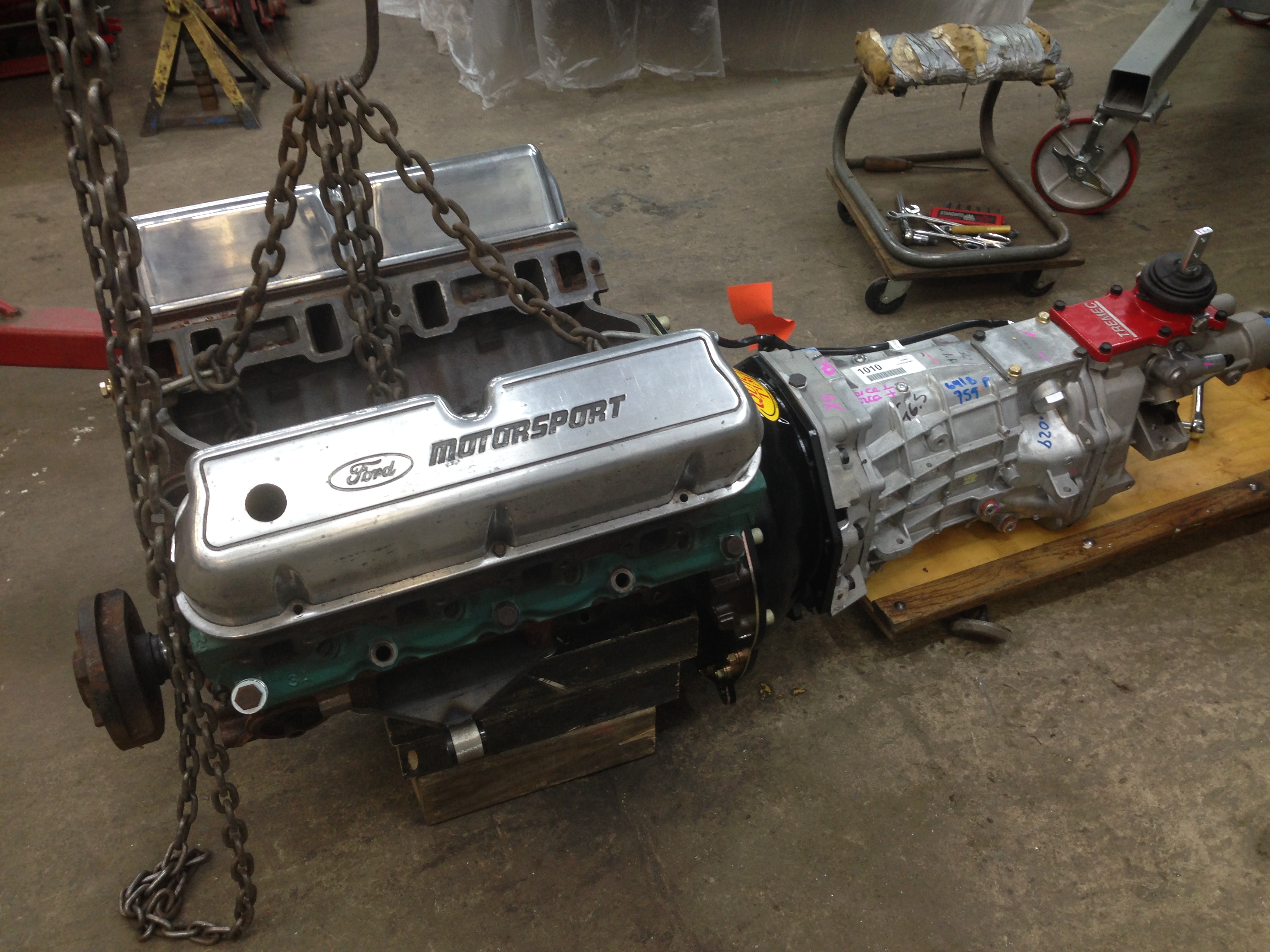

Made a trip to the machine shop to pick up the mock up engine - block, heads, crank, damper, and tall valve covers. We are hoping the only cutting for clearance will be to the top inside corners of the foot wells, instead of moving the entire footwell section back. Pictures found on the net show Ford 302's just fitting. 351W's are taller and wider.

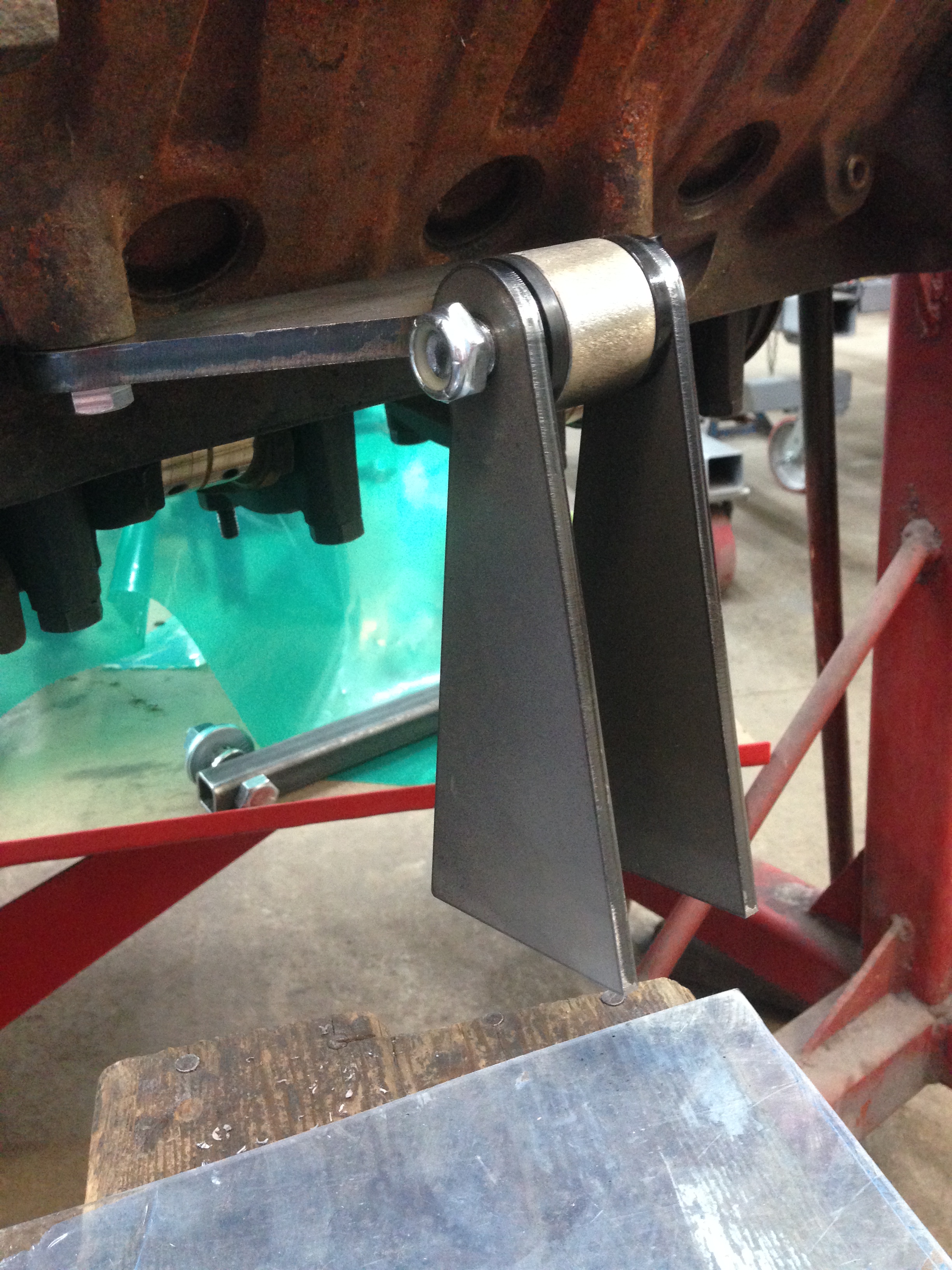

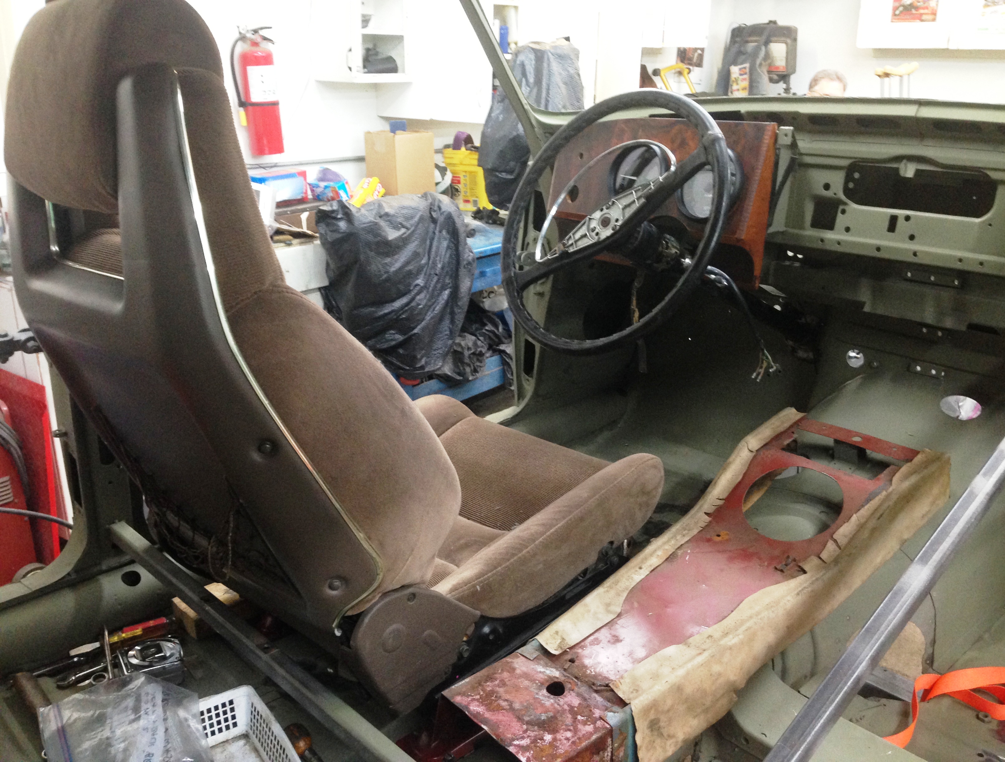

Default Mock up week

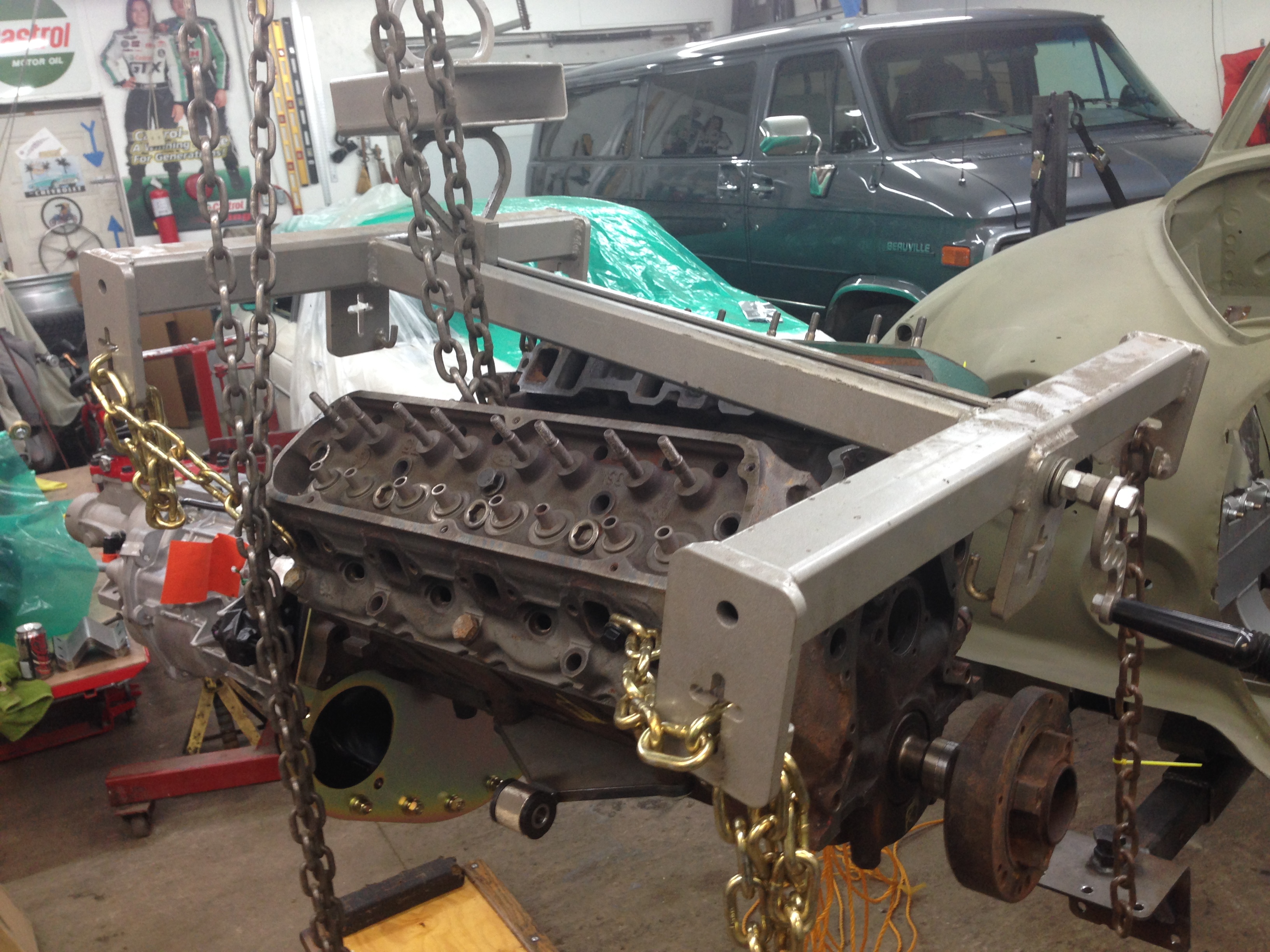

Calamity of errors this week - all engine hoist false starts. Ended up with one from everybody's favorite with a 25% off coupon. Still need to move the shifter to the center position. More parts shopping.
Trunk floor has been fit, not welded. It's in five pieces. (no pictures).
Engine mount is a "Paul Horten's Welders Series", no affiliation, high quality.
Tested seat, gages, and column today.

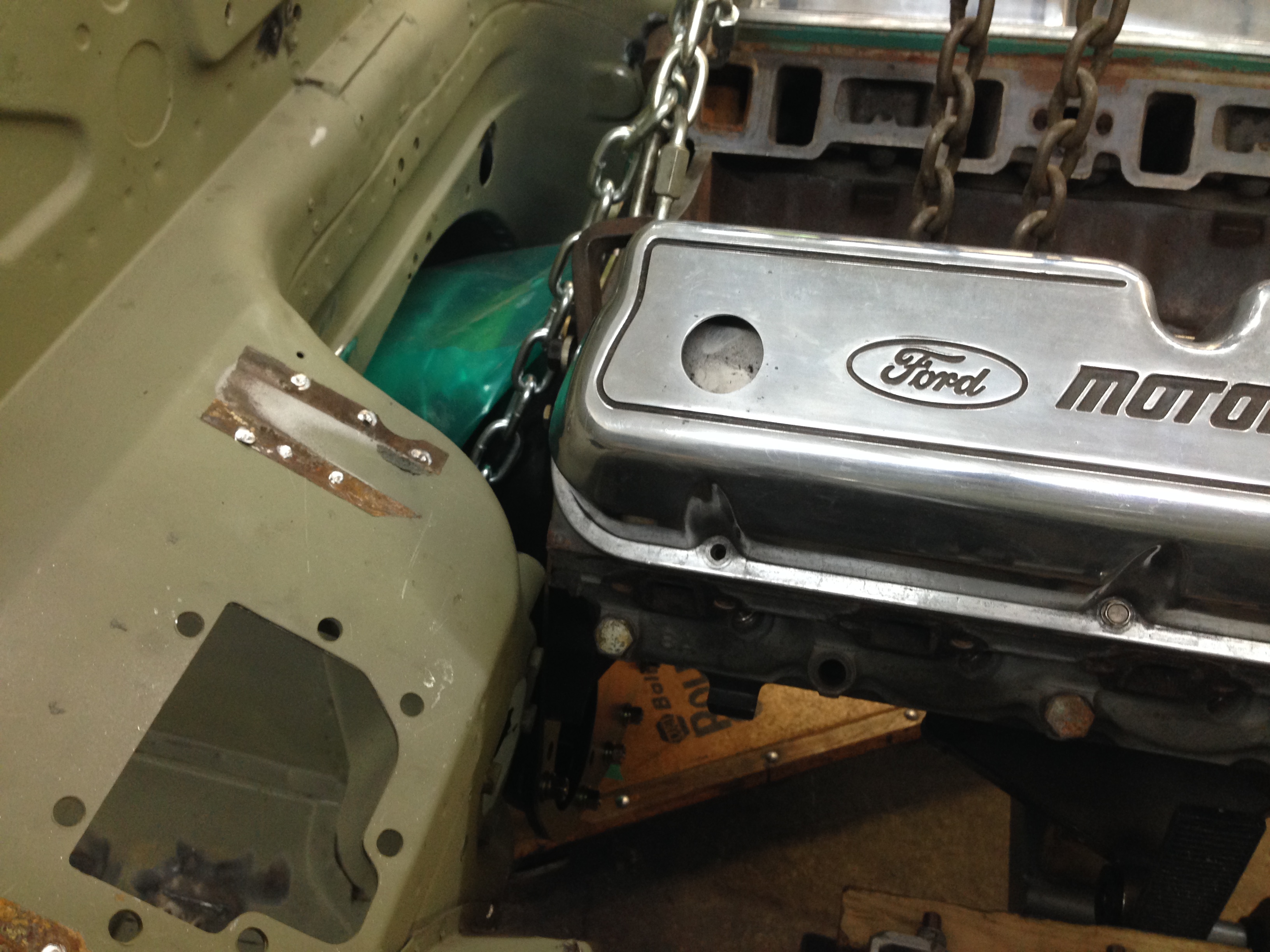

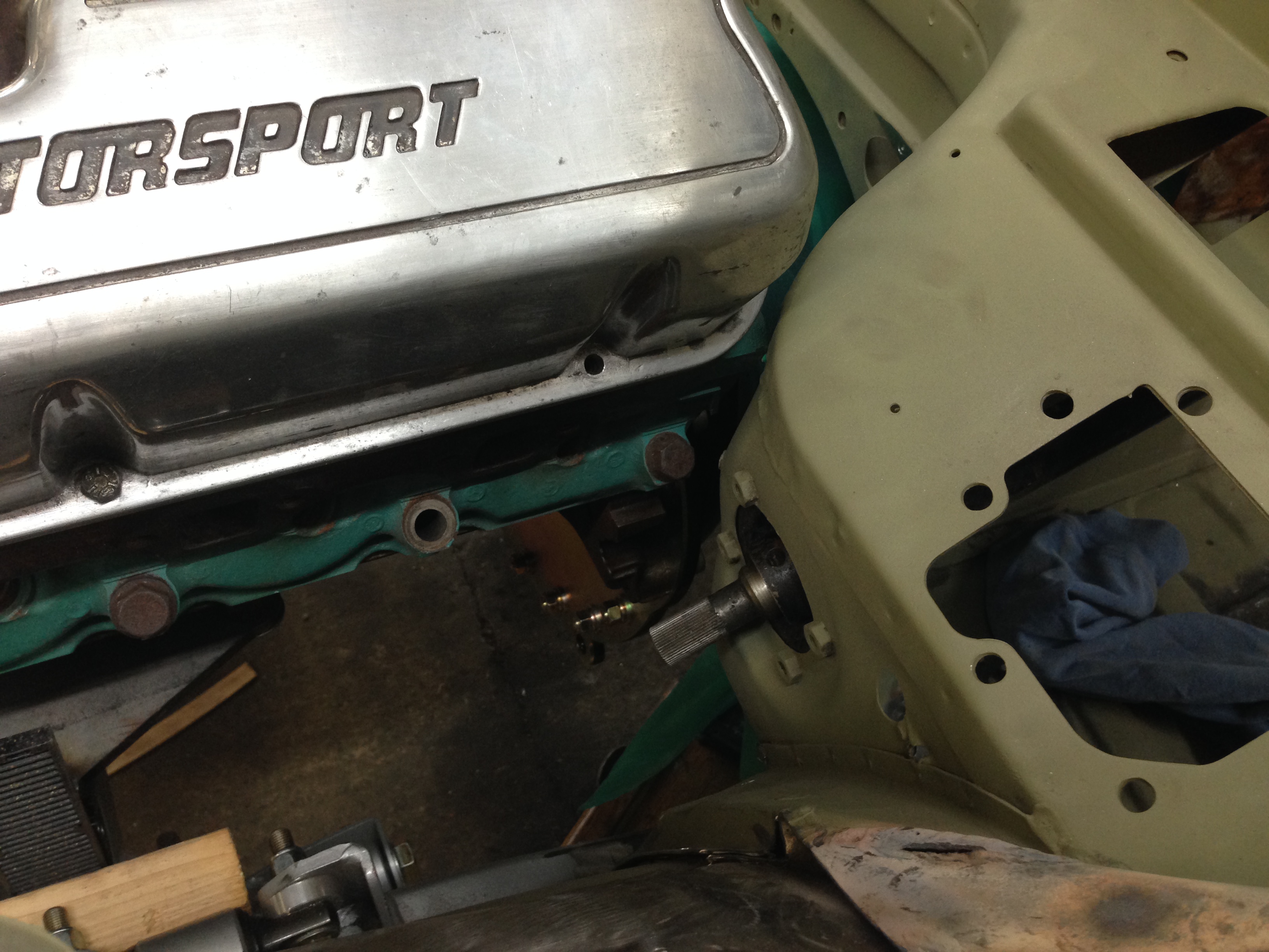

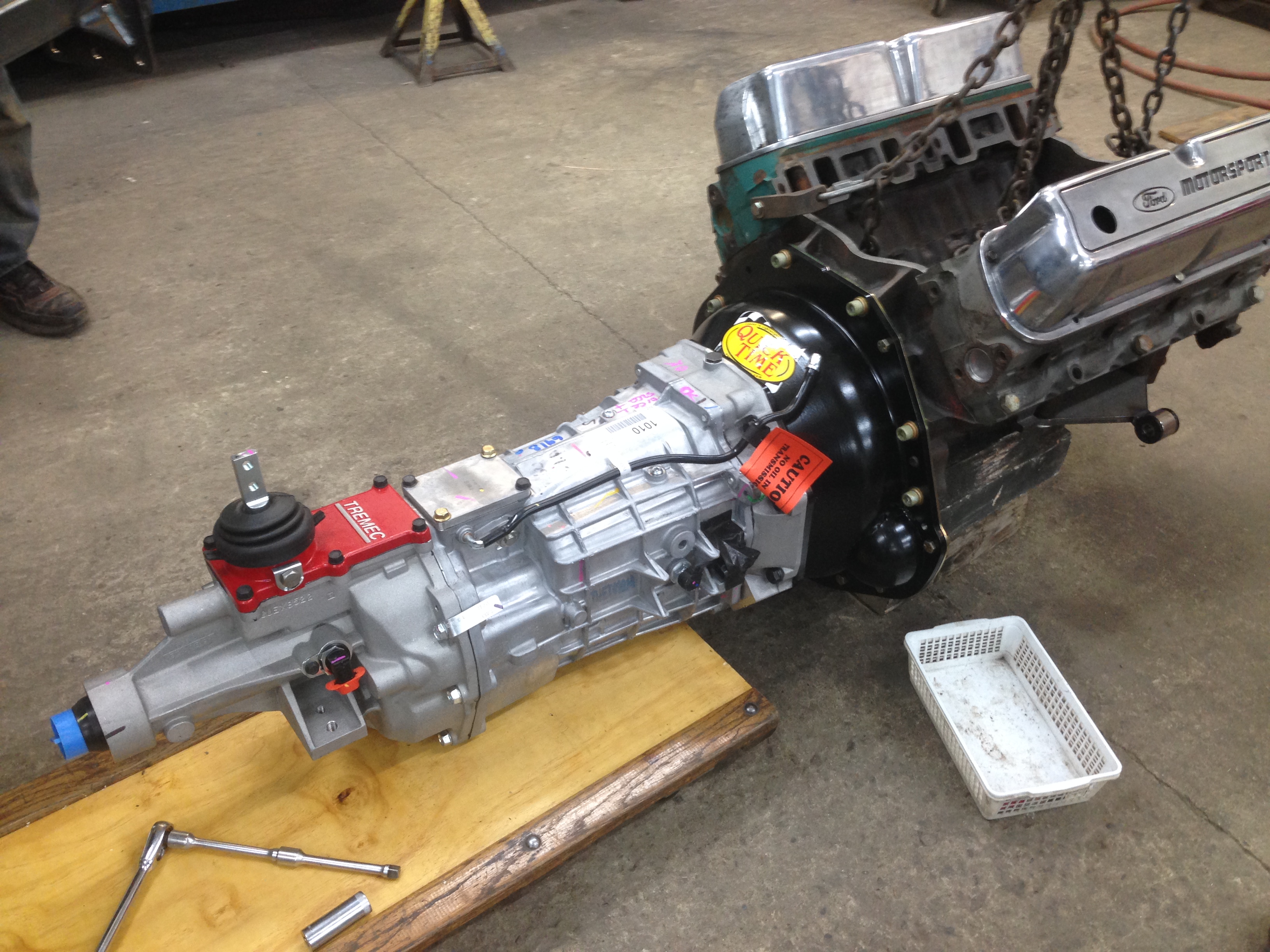

The Ford 351W is in for the first look. Had to remove the rear 1/3 off of the transmission tunnel, plus we removed the top of the drive shaft tunnel back to just behind the e-brake mounting pads. Forgot to cover that surgery with a photo.
What I think we know so far: 1)going to carve the front cross member close to 1/2 it's depth and invert and weld in the removed piece for strength; engine mounts I have are not likely the ones I will end up using; found some engine mount possibilities on the INTERNET - phone calls will be necessary; can't go any further without the pan - it's suppose to be here on Monday.
Working on carving decisions for the tops of the foot wells. We might move the steering shaft opening ~1/2" outboard.

Looks like you spark plug access is OK _ at least at this point.
I watch this sort of stuff on TV and many of them use a styrofoam casting of the engine.
I don't know how expensive something like that is though, but it certainly would be allot easier that using the actual engine.
