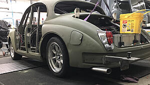

Thanks for the additional nudge. The on the ground pictures were taken November 2015, yikes. Got a phone call from the glass blaster about two weeks ago, wondering if I still had the rotisserie. I had to sheepishly reply that the MK2 was still on the "spit". I want to complete about 5-7 holes in the firewall, lay more wire in its final direction, make a final assessment of the underside, and put it on the ground again. If I really "turn to', this should happen shortly.

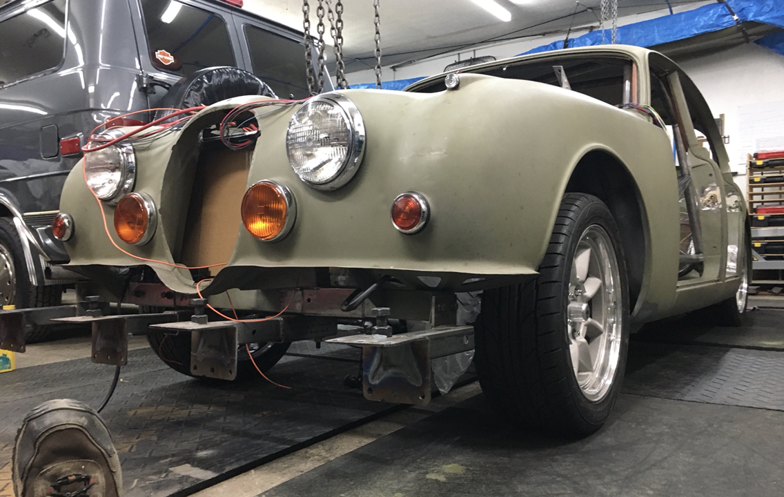

Well after five years on "the spit" (as my brother-in-law calls it), I set it back on the ground tonight. Shocks are set at minimal load. Ground clearance is better than expected - 5 1/2" in the rear. Wiring is laid in, not connected. I'll be dropping the engine in next week.

Congrats on touch down, Clyde - the wheel/tire combination should look perfect at ride height. Do you plan to finish the rear wheel openings, and what was the final decision for bonnet clearance?
Is that a rotisserie bracket at the rear or a Wheel-E-Bar mount? All the best with the project - can't wait to see some video of this thing launching.

Default on the ground five years later
Doug,
Wheel openings will bee with just lips. It would me grins with the spats, but under certain conditions they would likely rub. It may need wheelie bars.
More pictures from today. Wanted to have similar shots to the outside pics from five years ago. Friend is photo bombing in several shots.
likely will rub. shots for grins

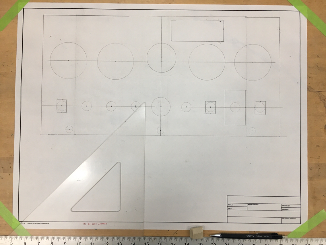

Many fractional mistakes yesterday day while converting the central panel to 1:25 to 1.

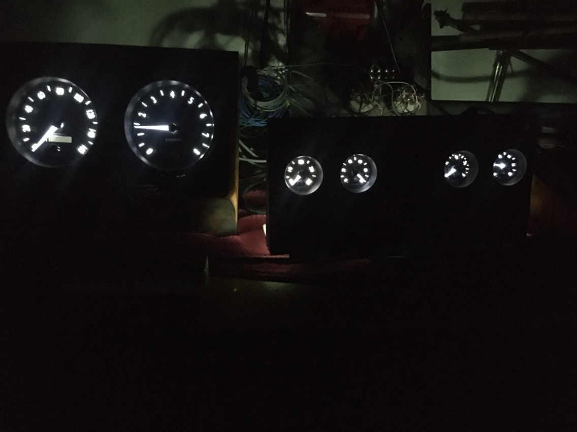

Panel test on the bench.

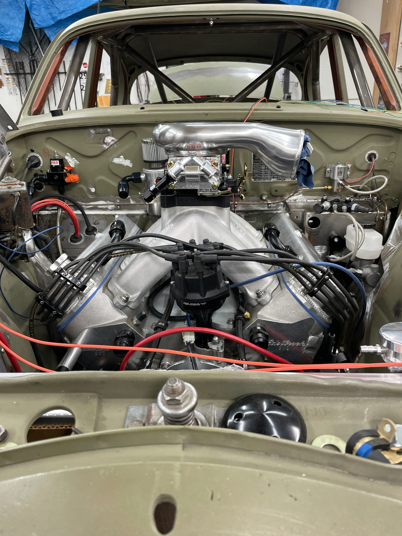

Bored with wiring. Carb, spacer, and air intake will not fit under the bonnet/hood
Attached Thumbnails 1960 MK2 not a restoration, not a rusto rod, just a Bonus Trap-photo658.jpg

Wasn't that a concern right from the start ?

I knew it. I won't know exactly how far until the hood gets cut. My idea of reforming a second hood may not work either. First test drive with out a hood. No immediate worries. I've been at this for six years.

How would it look if you cut a hole for the air intake and have it above the hood, rather then trying to cover it ?
Looks like there may also be a problem with the front part of the upper intake manifold ?

Can the mounts for the motor or front suspension be made thinner?

Maybe an Aston Martin DB4 GT or DB4 Zagato type scoop. Late Series DB4, DB5 & 6 became lower. Or reverse bulge like the E Type?
DB4 GT (short chassis)
DB4 Zagato
DB4 Zagato
DB6 MkII
Early Mk1 prototype had a bonnet/hood bulge. Not very pretty IMHO.
