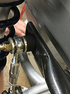

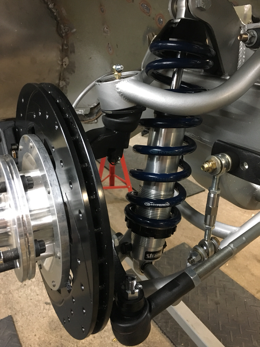

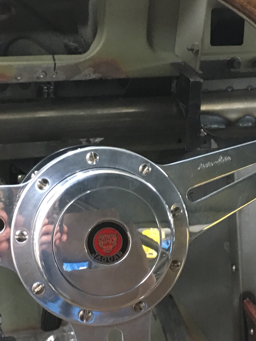

Moving along - front suspension & steering in. Column overhauled with both felt (cut to size) and the rubber bushings. Graphite moly grease on the felt and dielectric grease on the rubber.
Minor screw up on the lower rear shock mounts - Mis-read & over torqued. New bolts on Monday. Tank in for line line installation boot to engine compartment.
Old Sep 16, 2018 | 08:19 AM

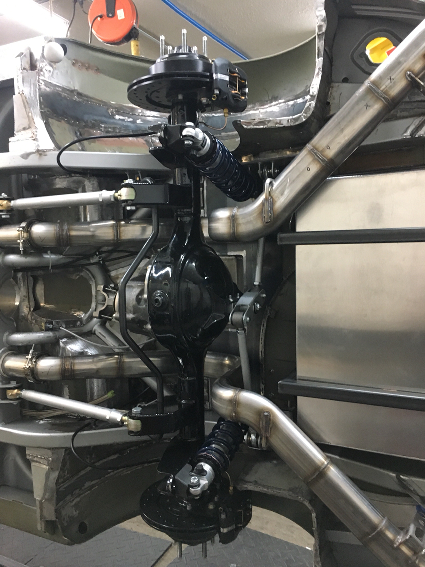

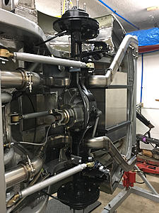

Jamming to Dave Hole radio on pdora, tightening jam nuts.
Rear coil overs in, and rear suspension torqued to spec.

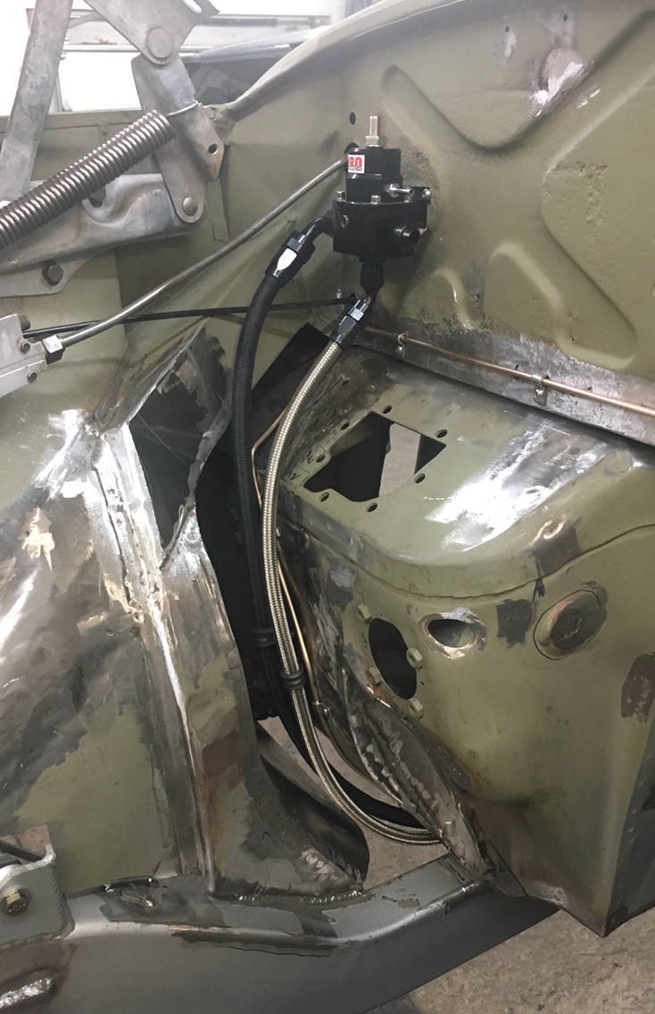

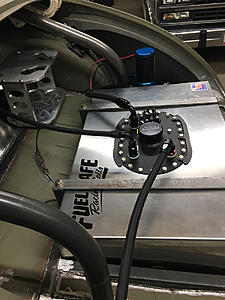

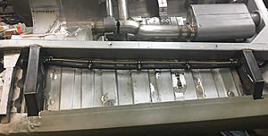

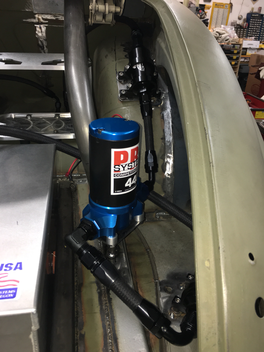

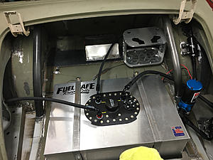

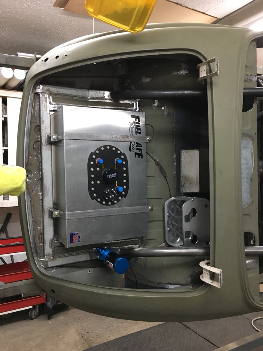

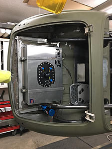

Fuel lines are in from the pressure regulator in the firewall to the tank in the boot/trunk.
100 micron pre filter, 440 gallon per hour pump, 10 micron post pump filter. -10 AN Out of the tank, -8 AN out of the pump to the regulator, and -6 AN return.

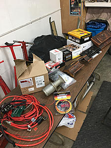

Onward. Electrical next. Filled the table with some of what's next.

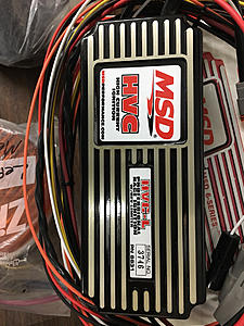

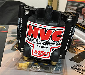

Nice Clyde, very nice. Which MSD controller are you going with as a matter of interest ?
Wiring ah what fun !
Old Jan 12, 2019 | 08:28 PM
  #240
lickahotskillet's Avatar
Posts: 795
Likes: 200
From: Ohio
Jon,
The coil and box are suppose to be good for long hours of operation.
