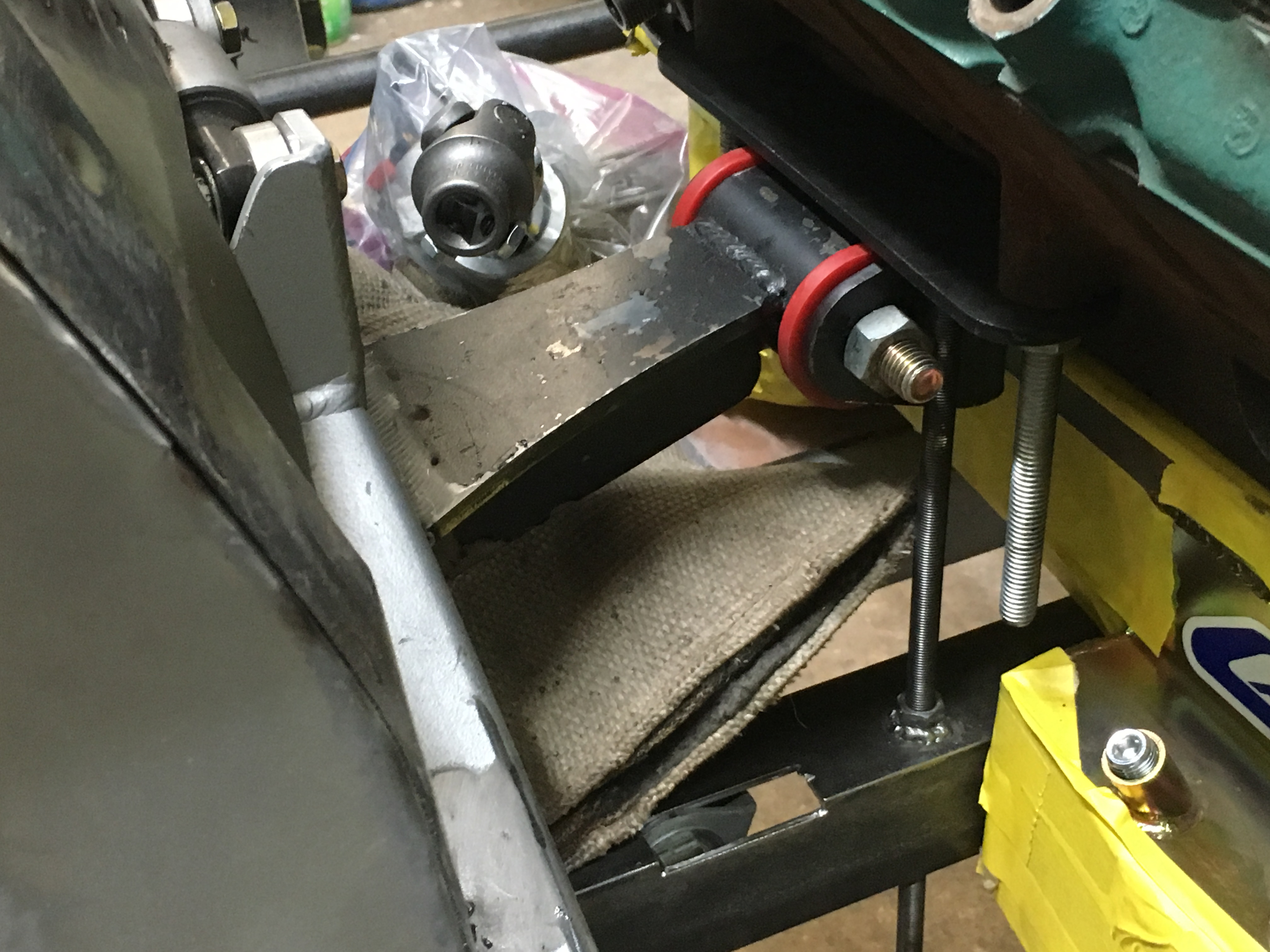

JeffR1 you caught me not paying attention. The engine is going back another 1 1/2" +. The left rear plug may need its own access hole from the drivers foot well.
"As seen on TV". Glad I don't have one. I watch the car shows at my girlfriends house. Foam/poly blocks are ~$300+. I've seen them for sale on Craig's List with stripped threads. My mock block is on loan from my local machine shop - CAMS - Canton Automotive Machine Service. We dropped the engine and trans in as a unit. Its a pain in the arm running the crank on the weight transfer screw. Not sure a poly block would have been up to the task of the transmission's weight.

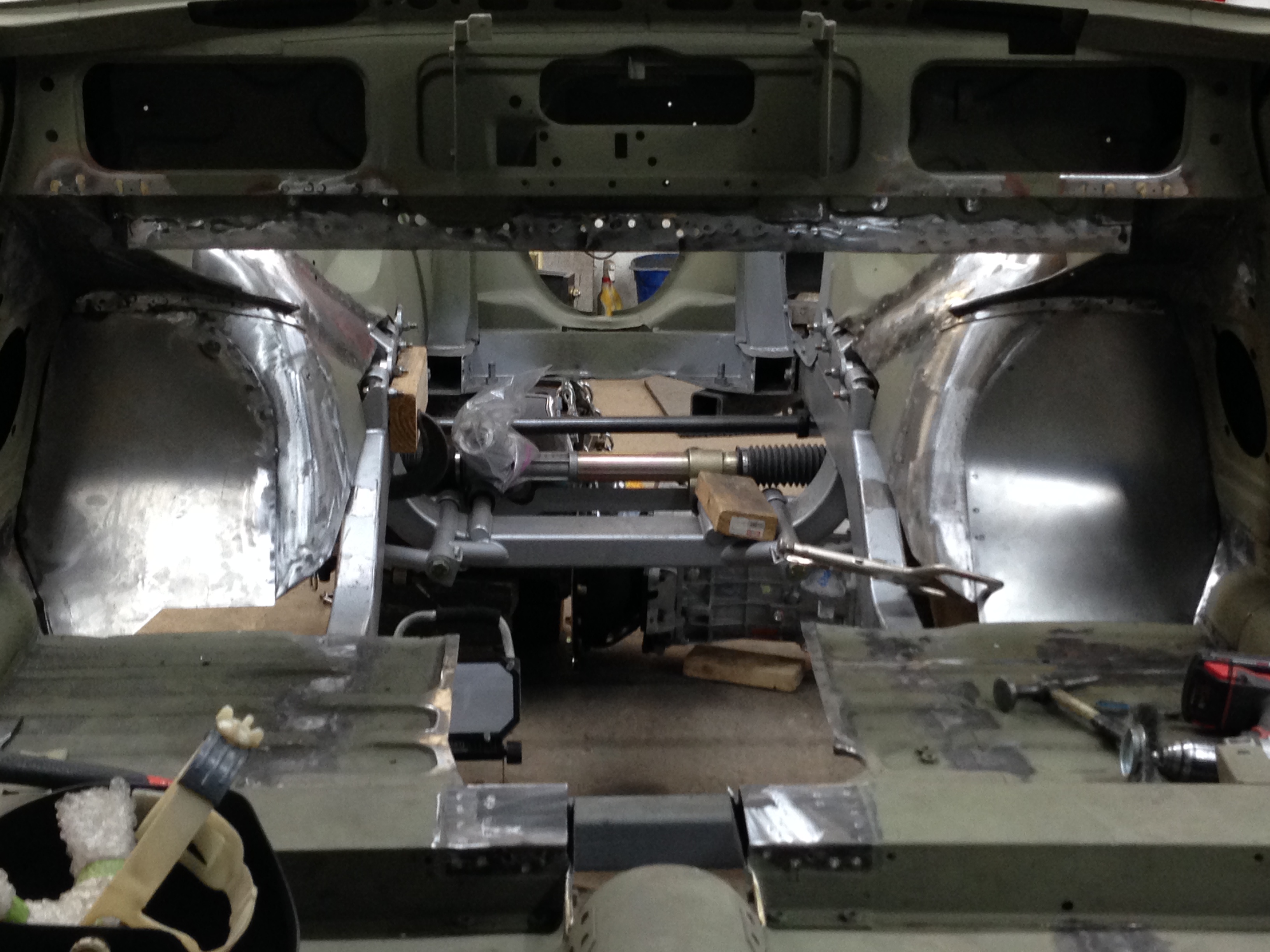

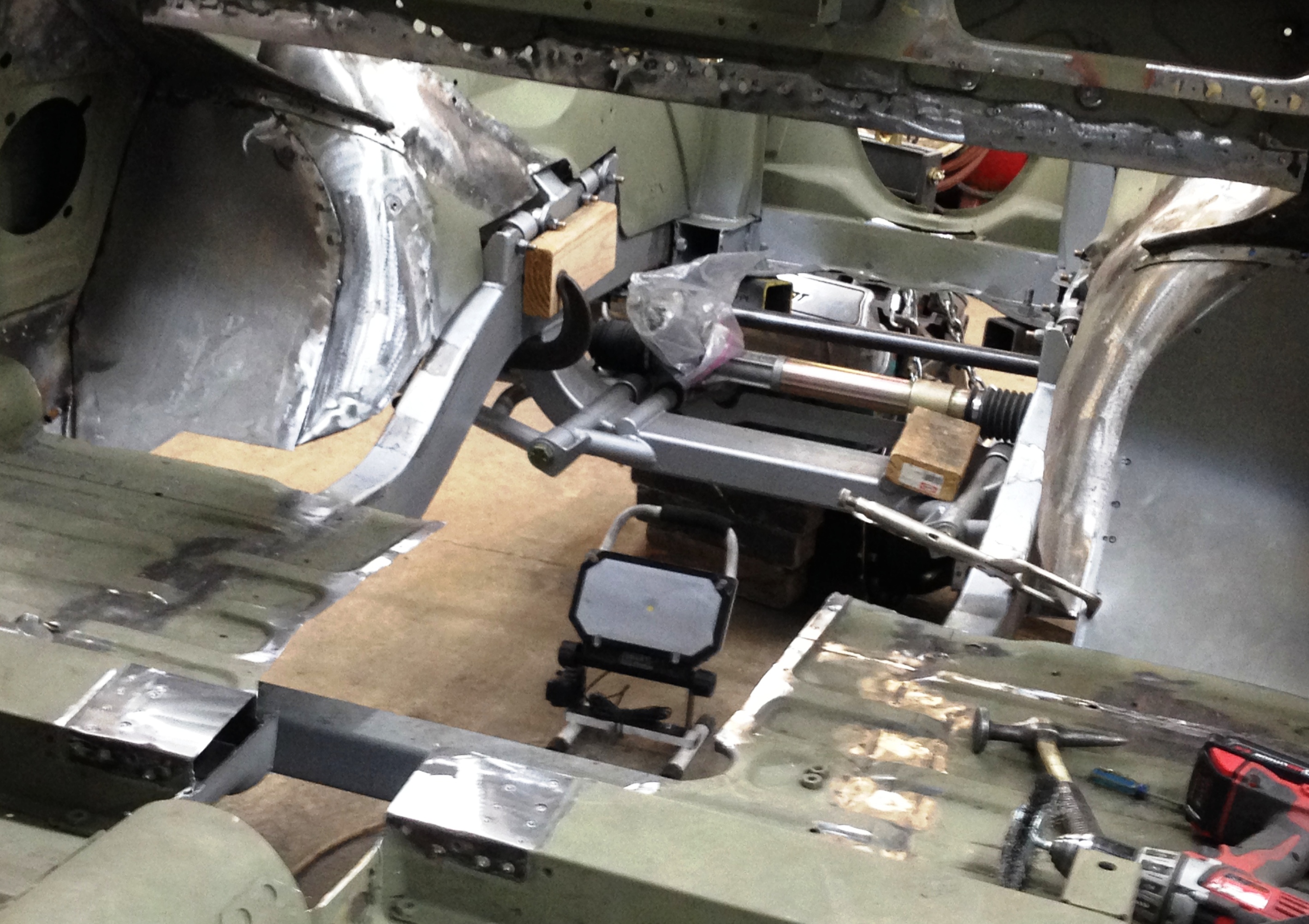

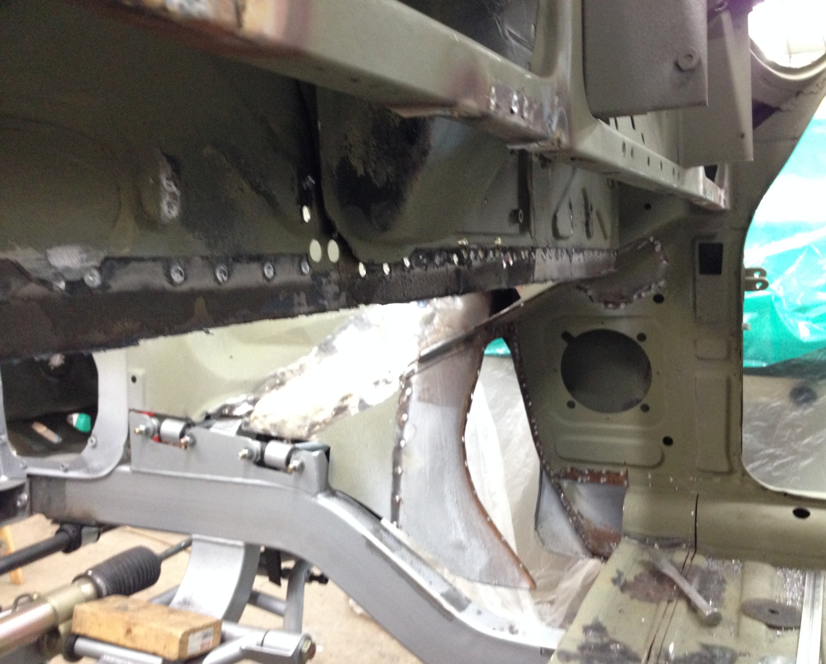

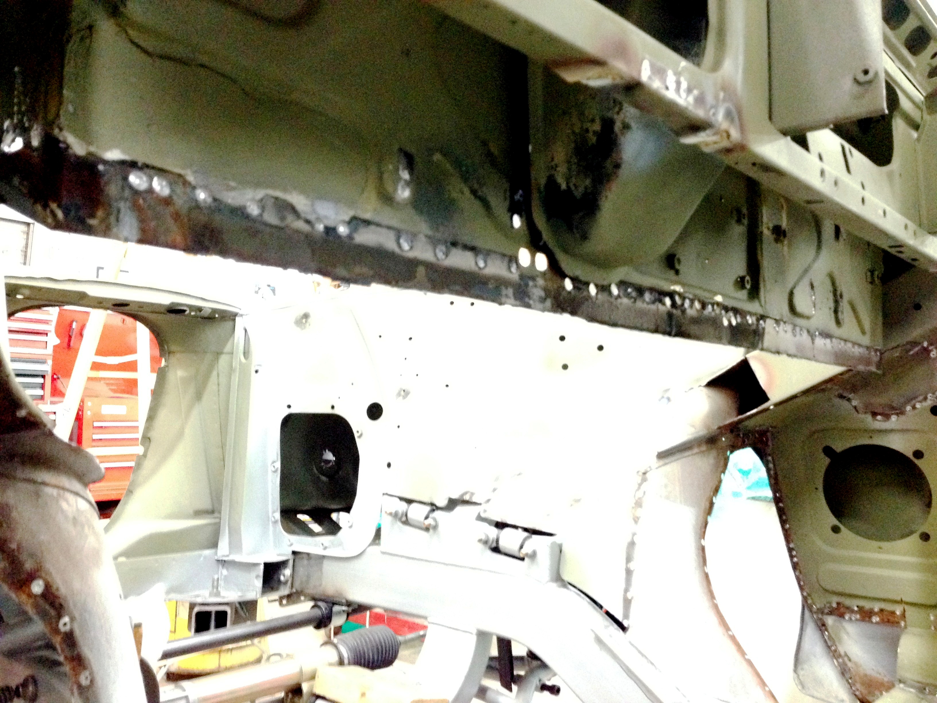

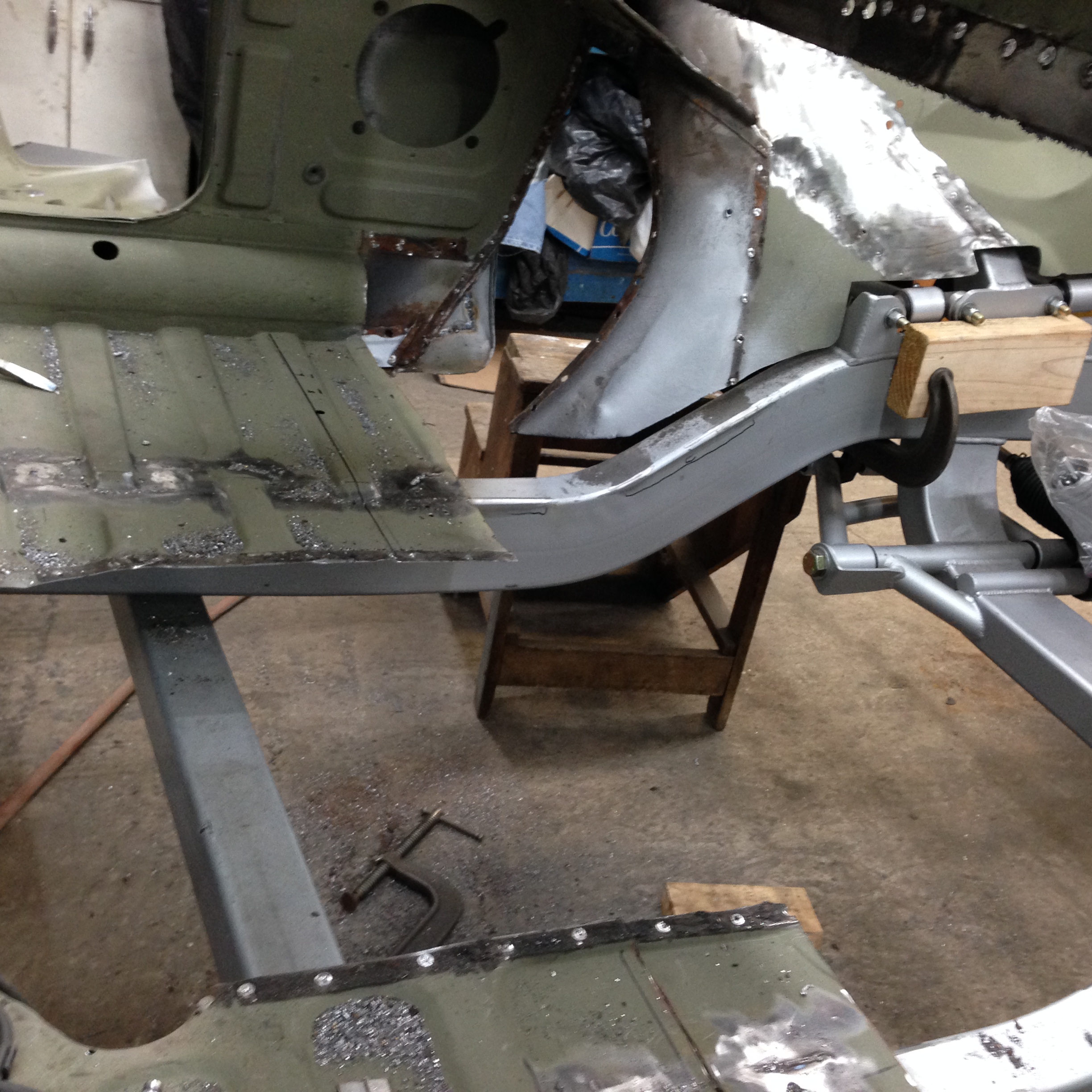

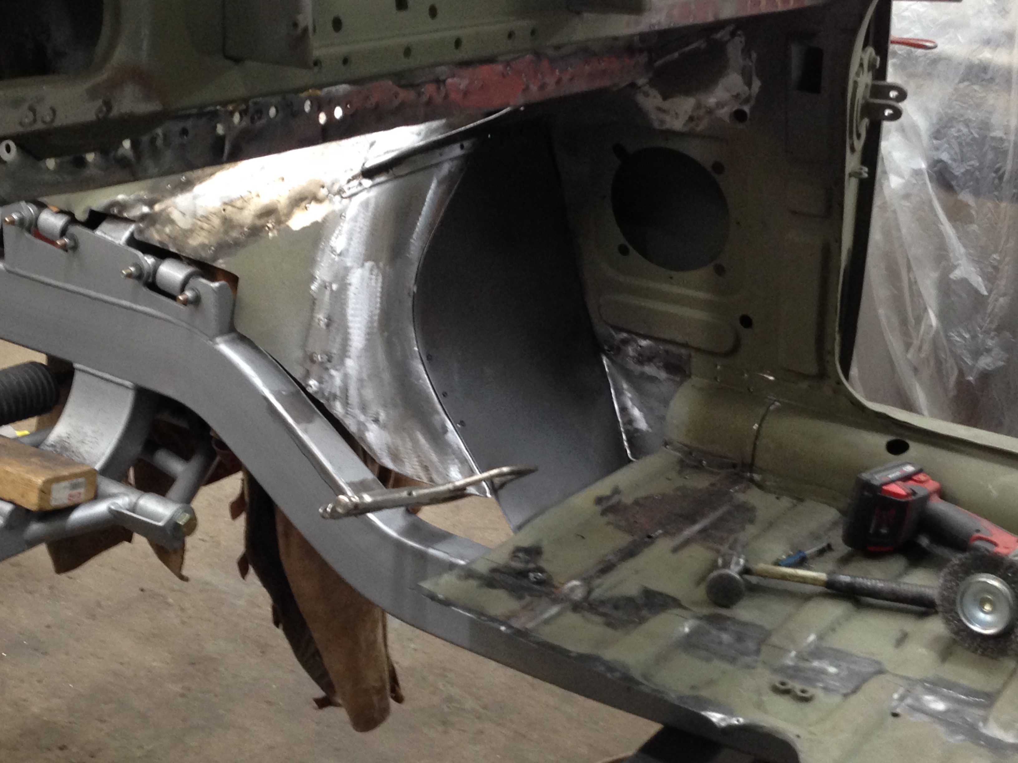

A setback, of the footwell, that is. It is going to be easier to get the engine in the correctly this way. Foot well will end up back 1.5" to three inches. The dash and firewall will remain in the stock position.
Jeff, my neighbor, is the master of de construction. He has also installed new backs to the inner fenders that were the removed footwells.
Wore out the second set of spotweld removers. Made the trip to Hard Krom in Akron, Ohio for more. Last trip, I hope so.
Hopefully, the engine will be back in by Tuesday for another check in the filling process.

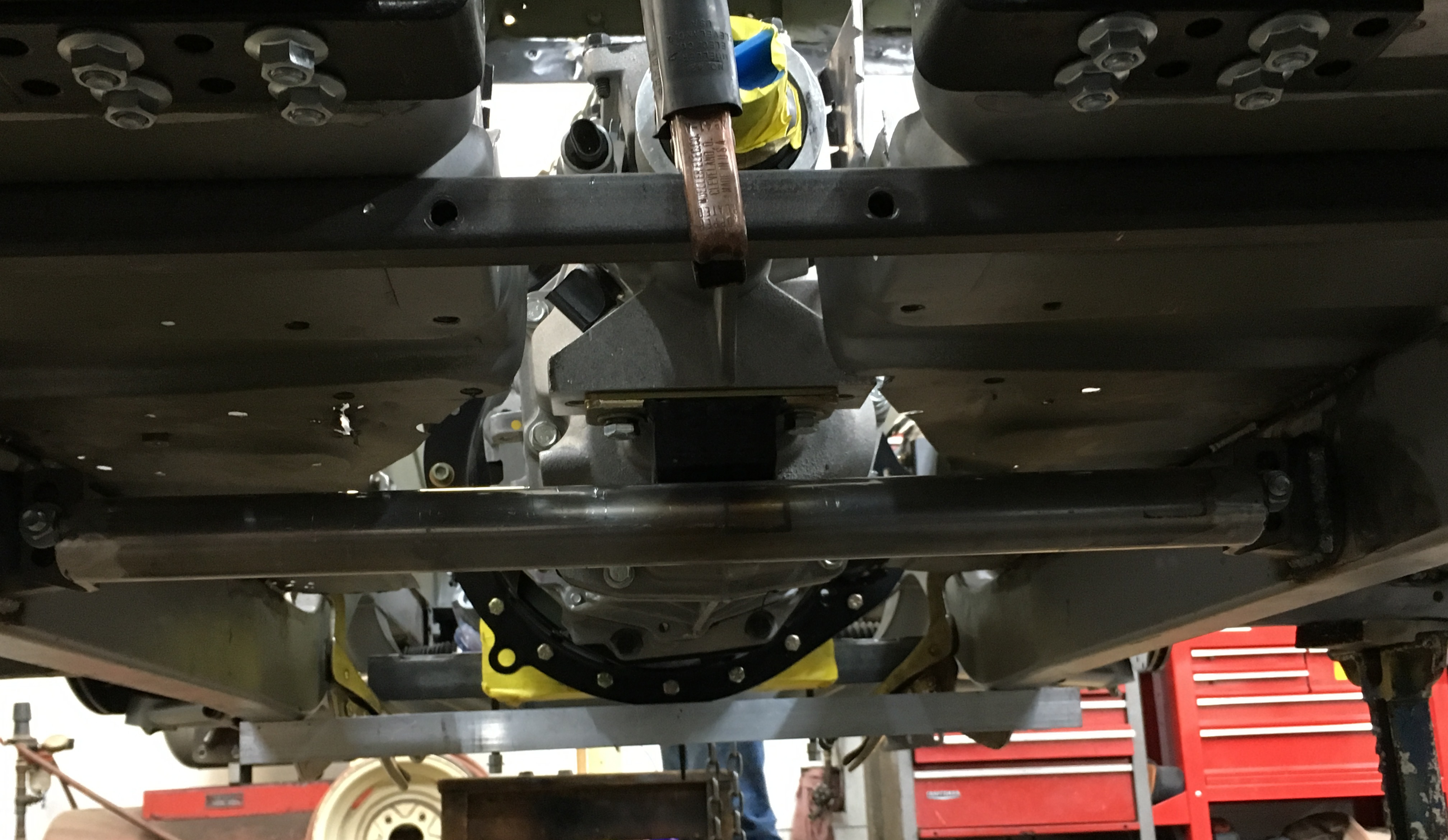

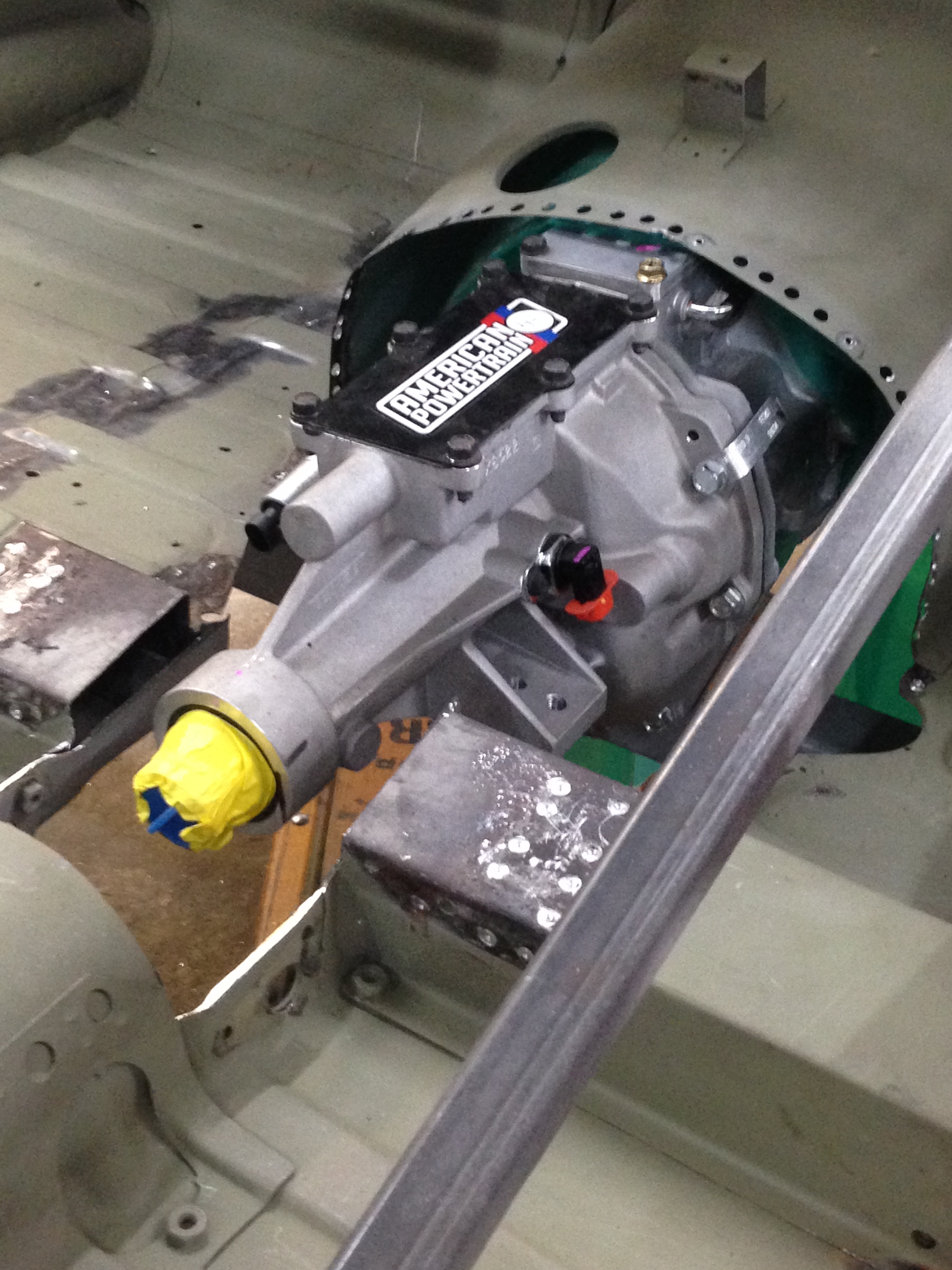

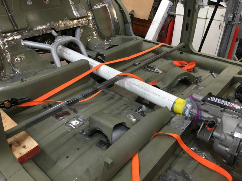

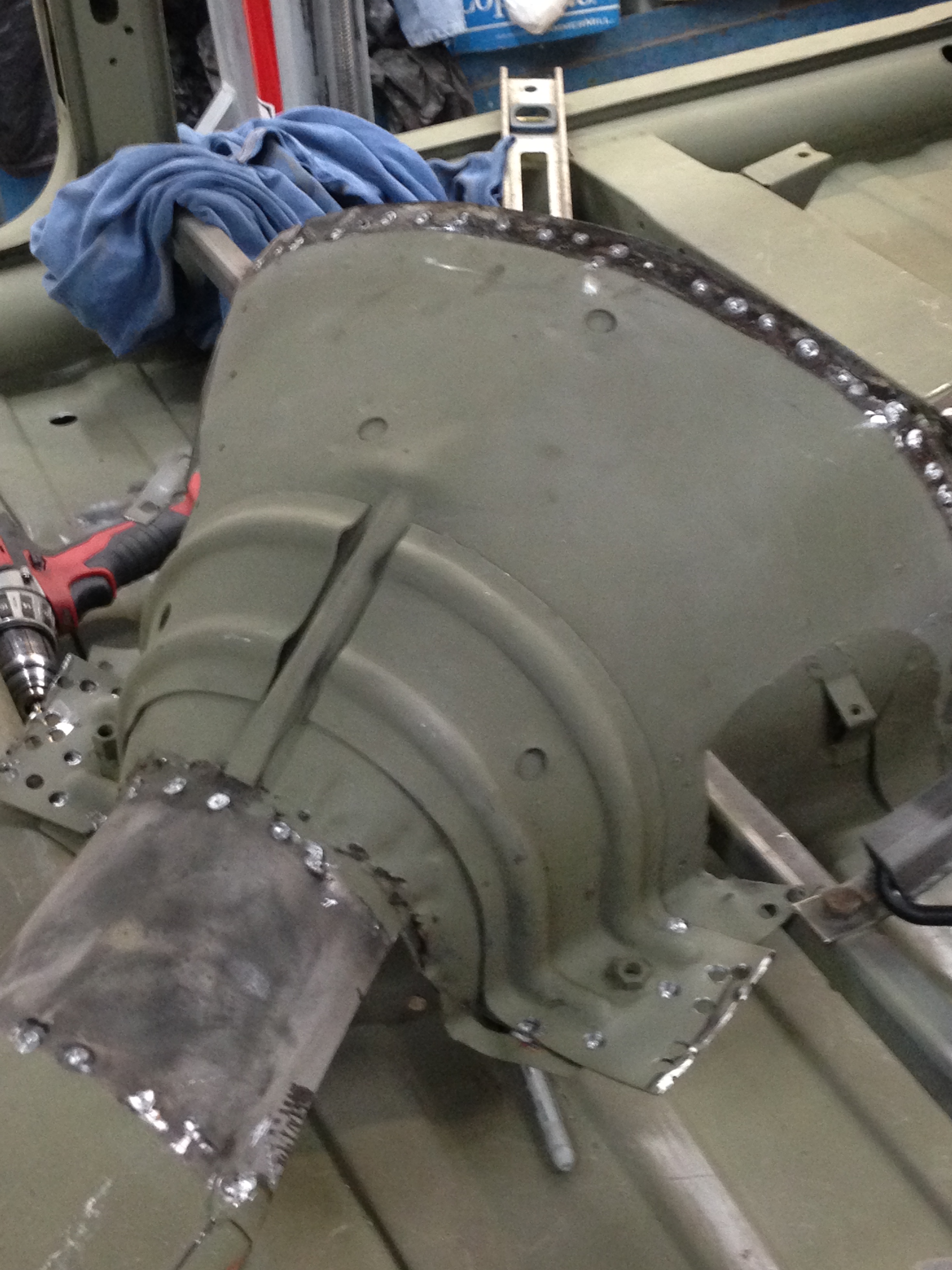

Installed a schedule 40 drive shaft. De constructed the tunnel from the transmission back to the rear seat bulkhead. Floor of trunk is also being raised behind the seat bulkhead to allow for the upward travel of the center section.
Tunnel is moving up about two inches.
Rear end reinstall and at full compression.

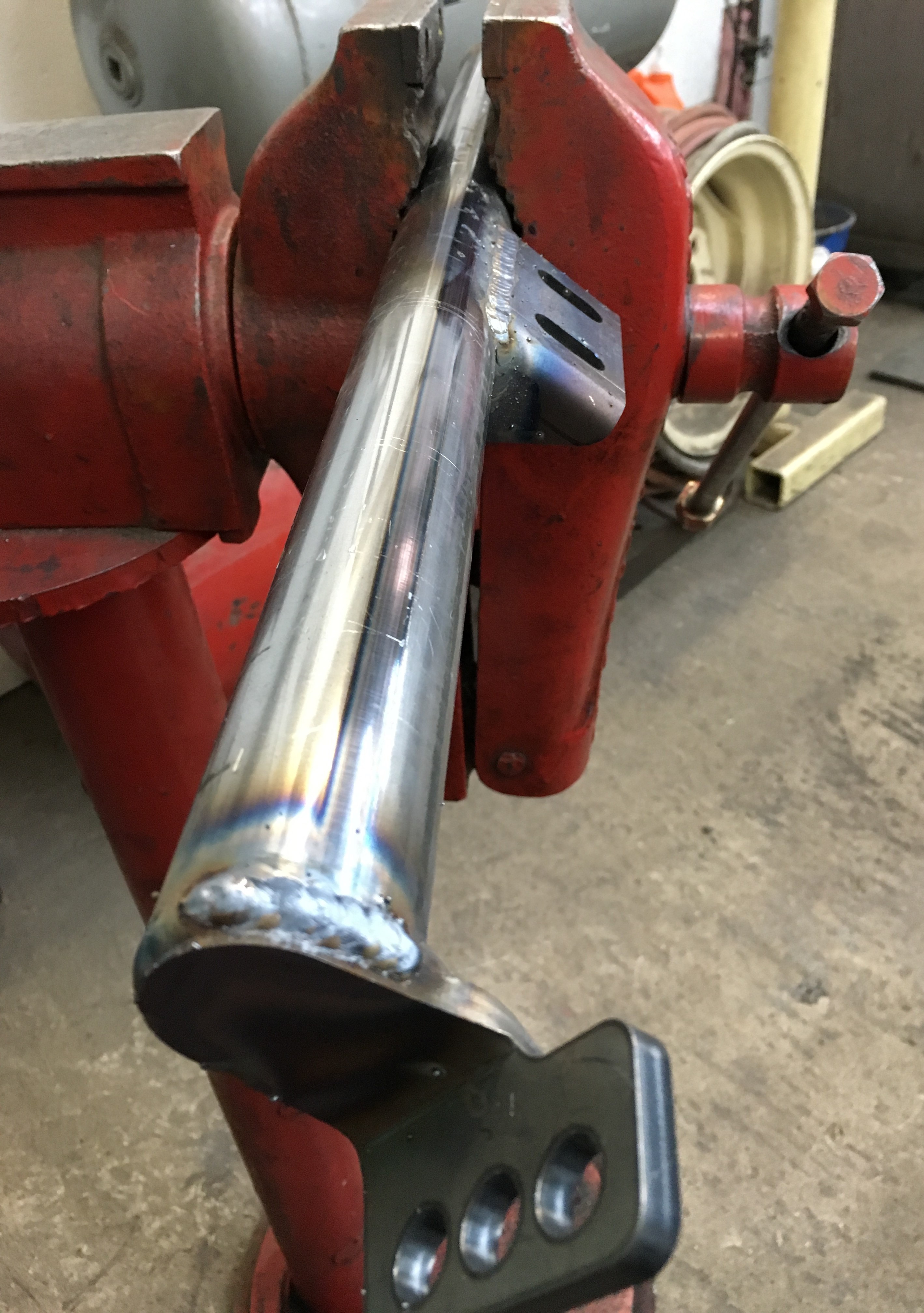

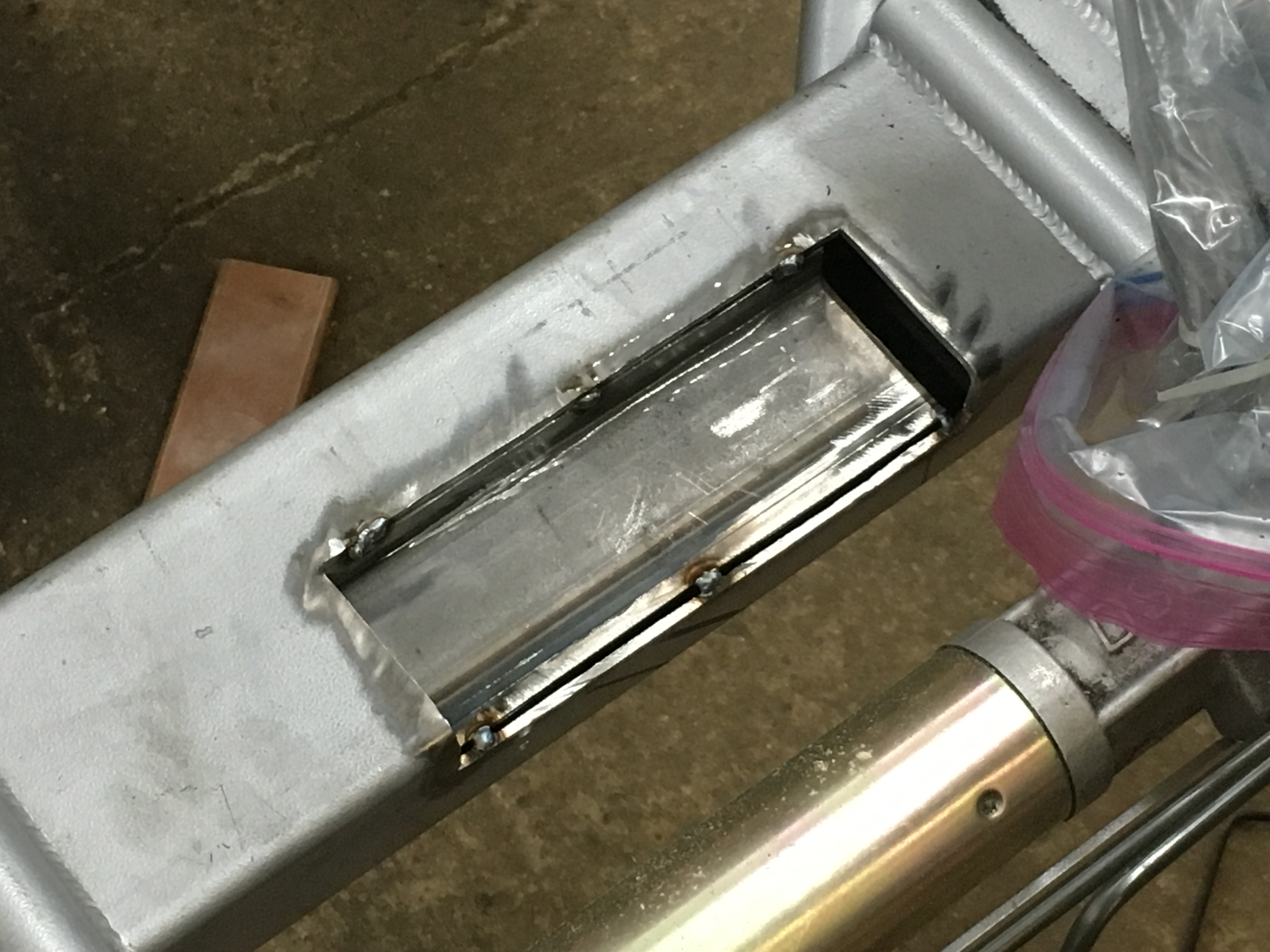

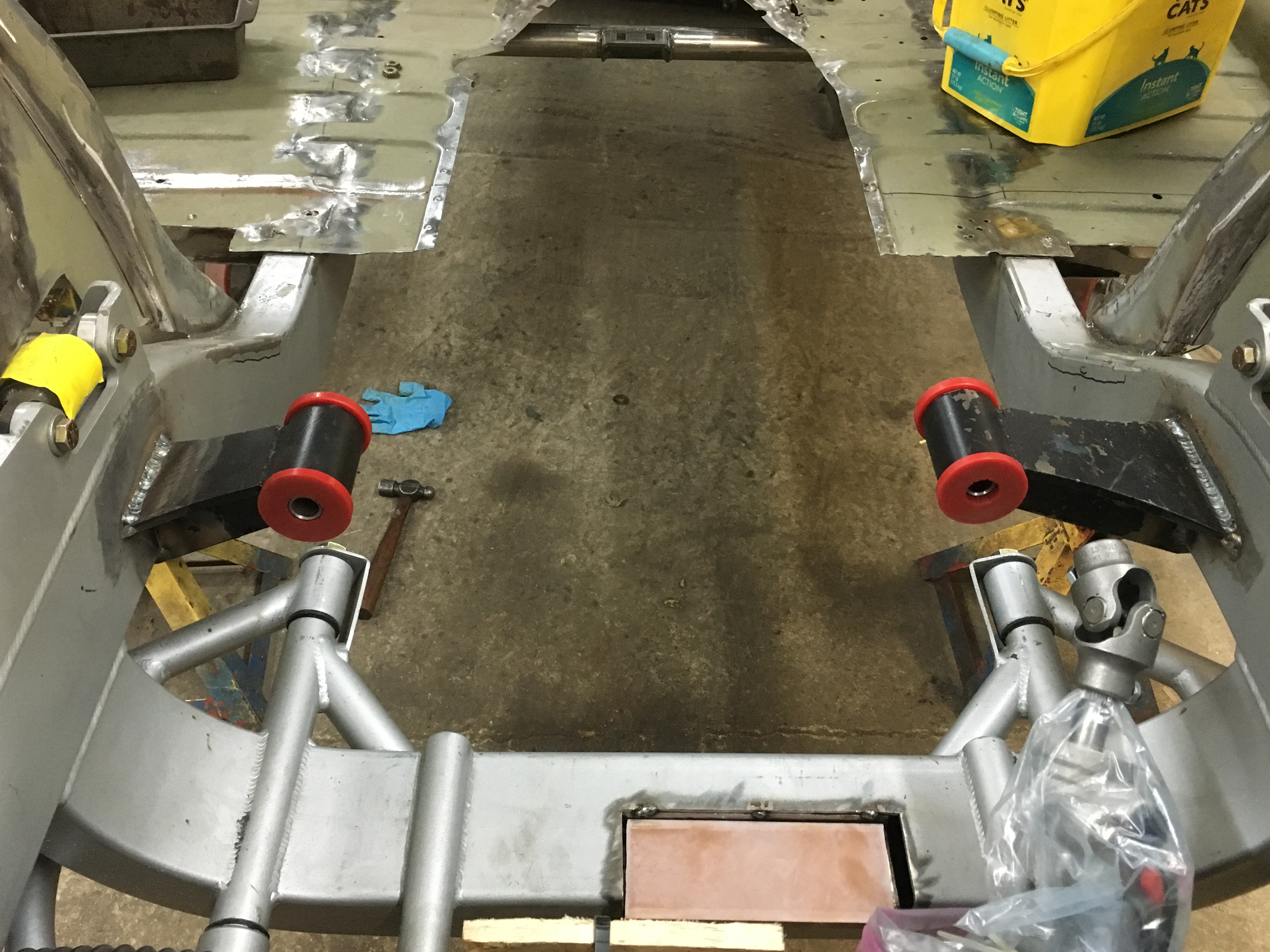

Motor and transmission mounts are welded in place, front cross member is notched for Ford oil pan. Finished up some welds at back seat.
Reminded by the welder it is fit and finish, not fill and grind. I've vowed to do a better job on refitting the firewall.

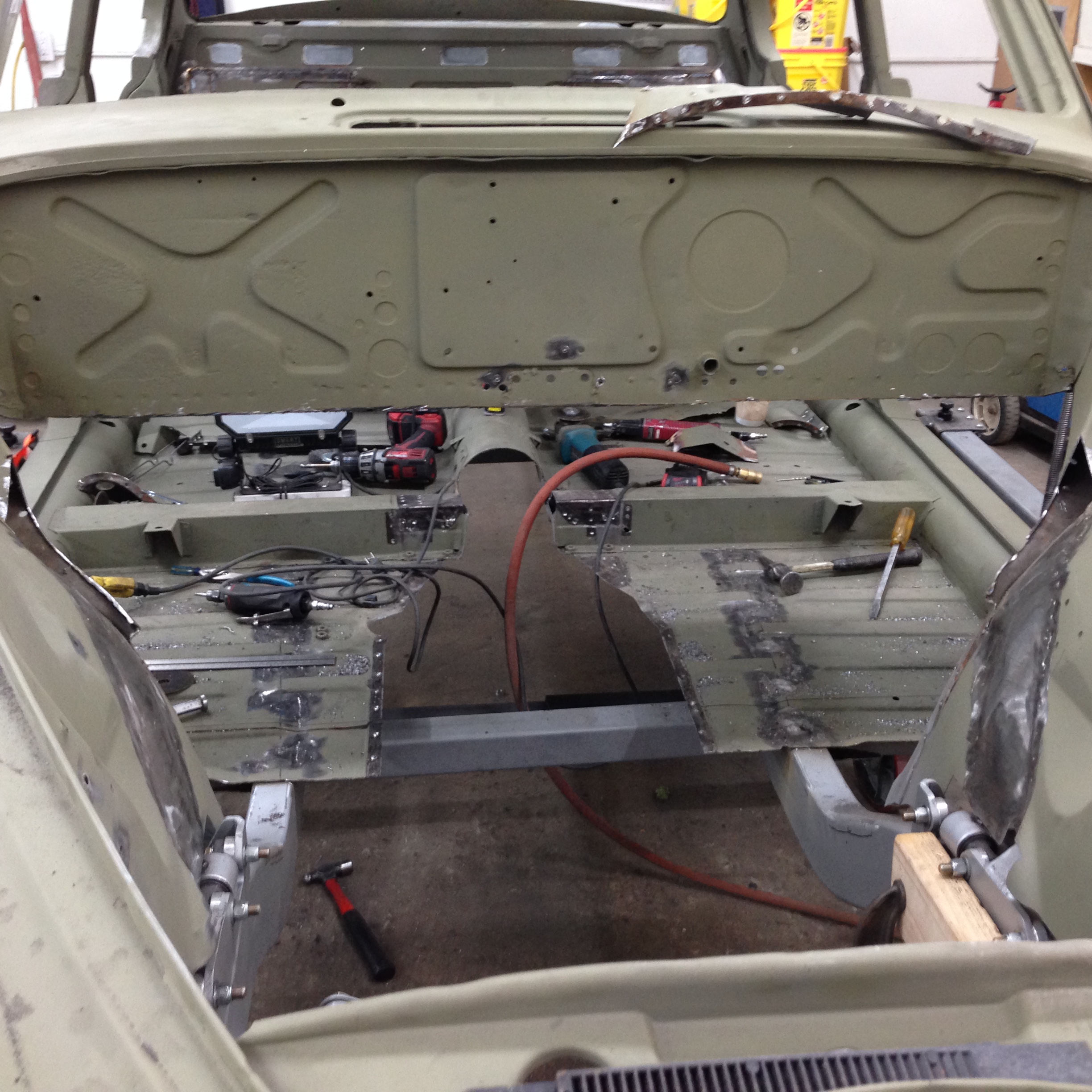

No pictures, but here are some updates. Footwell 85% fitted. Working on pedal box for mustang fox body pedals at the same time, along with new steering column mounts. Moved the right rear floor outboard 7/8" of an inch to compensate for moving the engine and transmission to the right.
Looks like we will be over 700 HP. Victor Glidden II heads and intake from BES racing on the way.
Hydra boost on order from Hydratech. Adding whoa to the go.
Hope to start building the exhaust system in August. I think the car will go back on the rotisserie for the exhaust project.
Old Jul 22, 2016 | 07:17 PM
  #92
lickahotskillet's Avatar
Posts: 795
Likes: 200
From: Ohio
Default Black Walnut Steering replacement

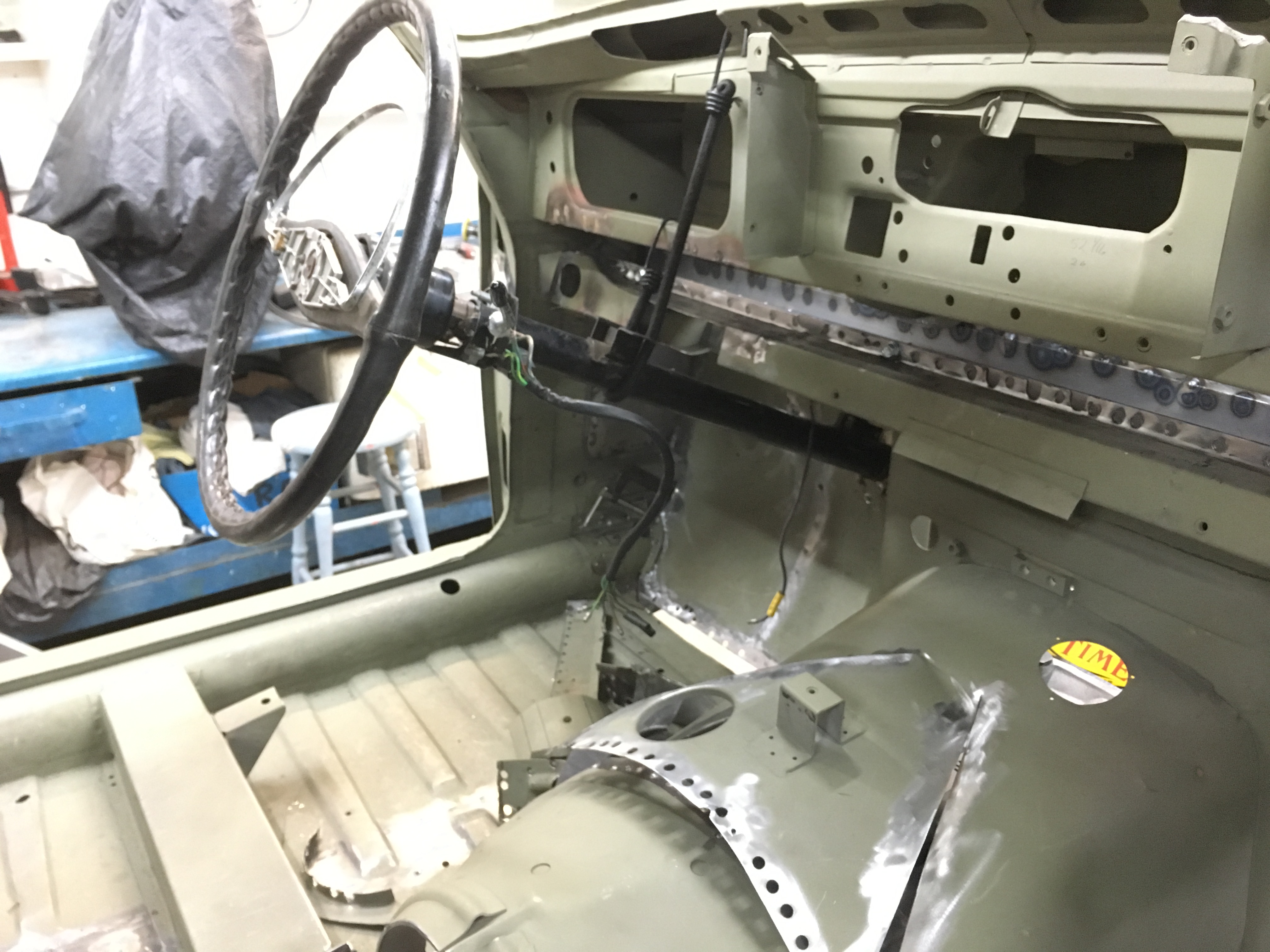

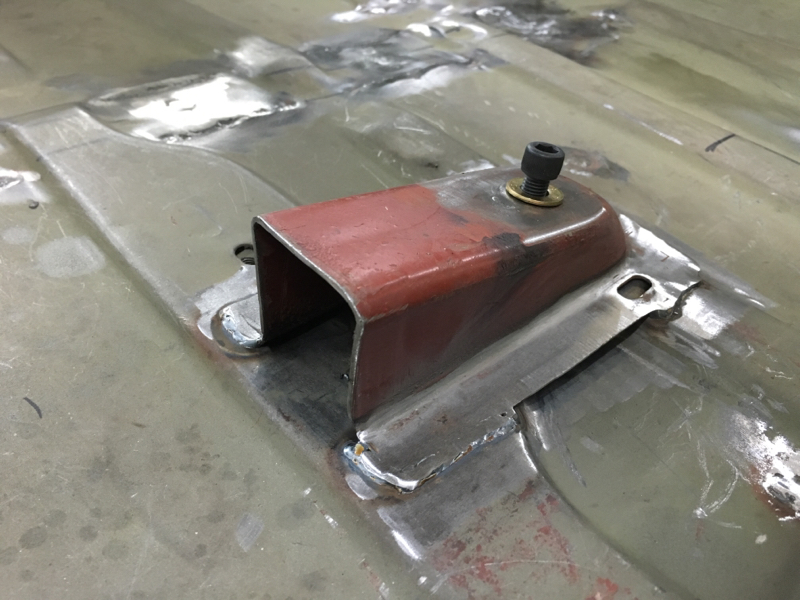

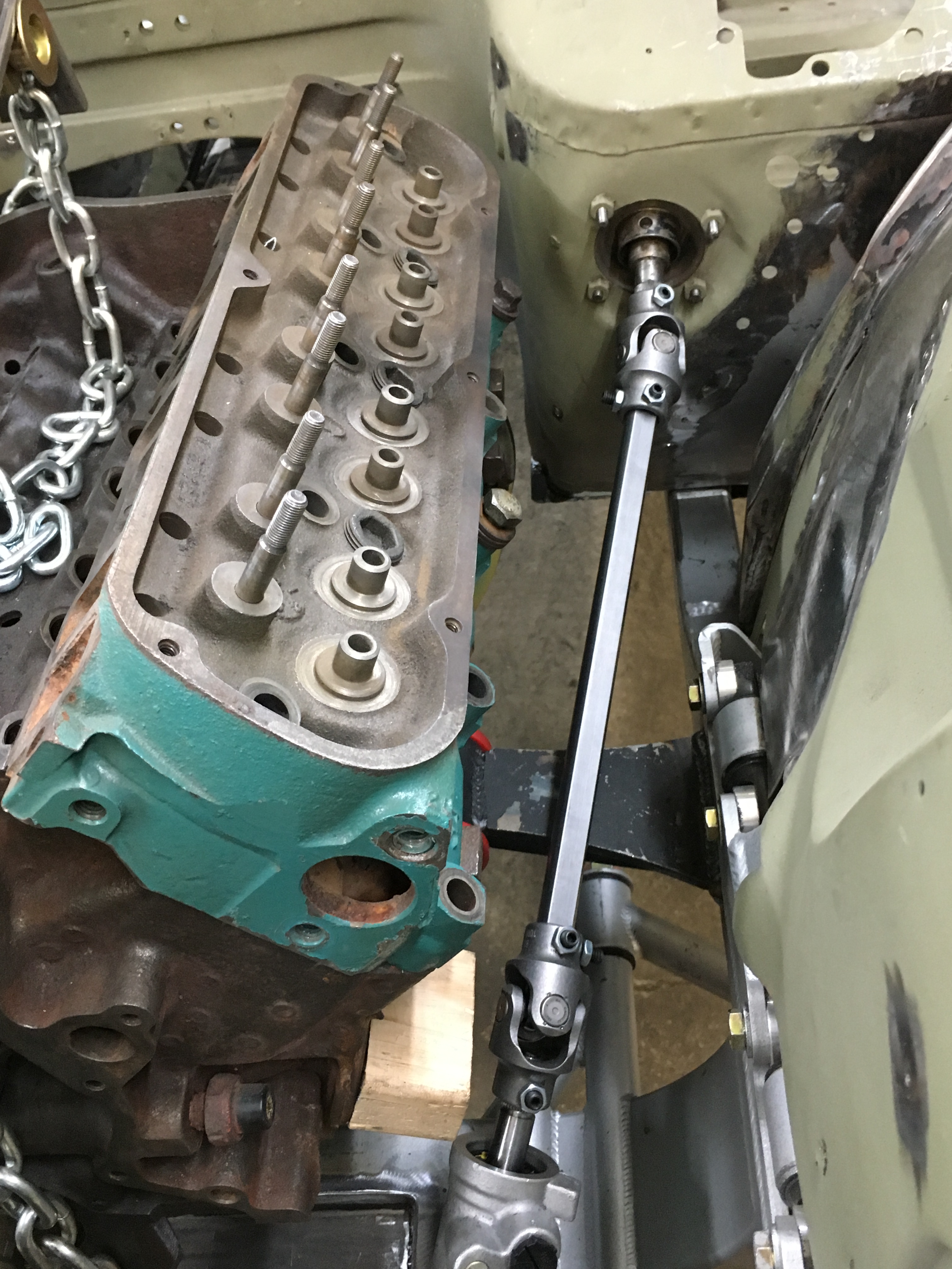

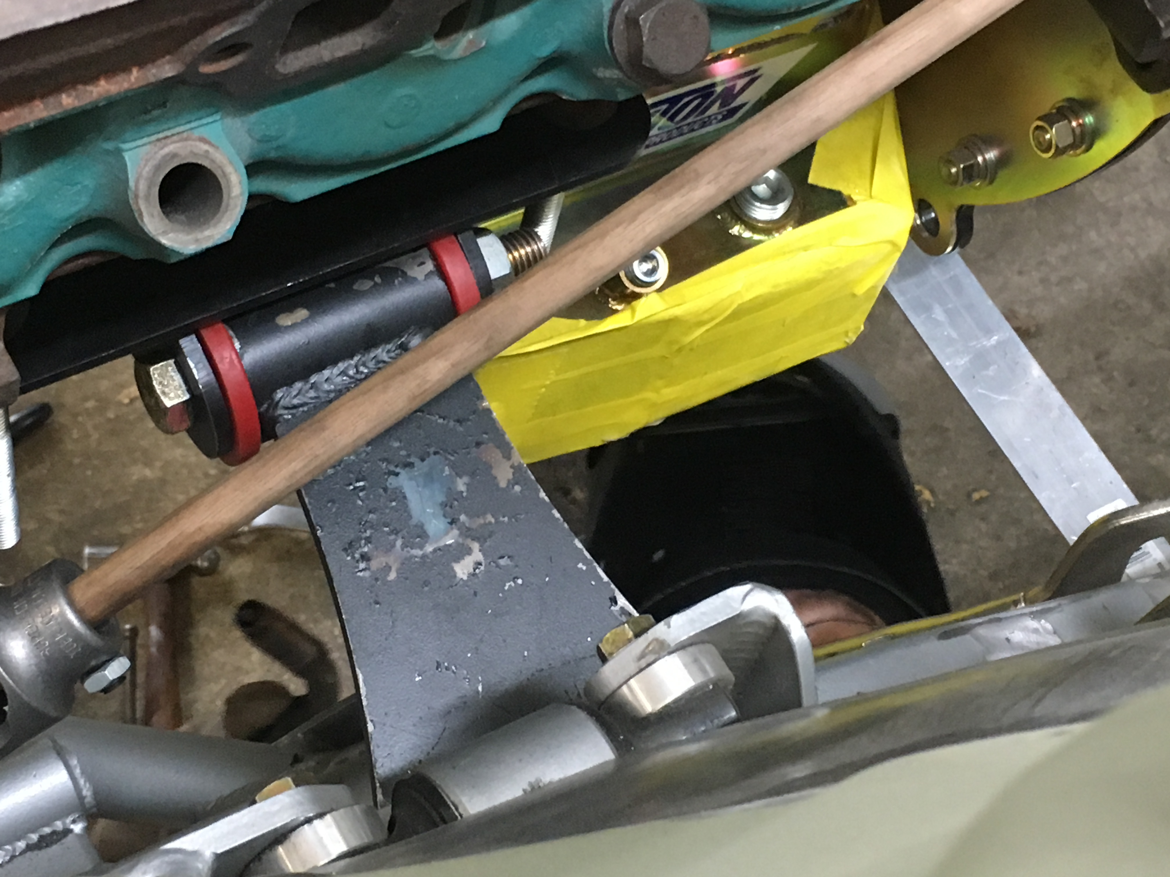

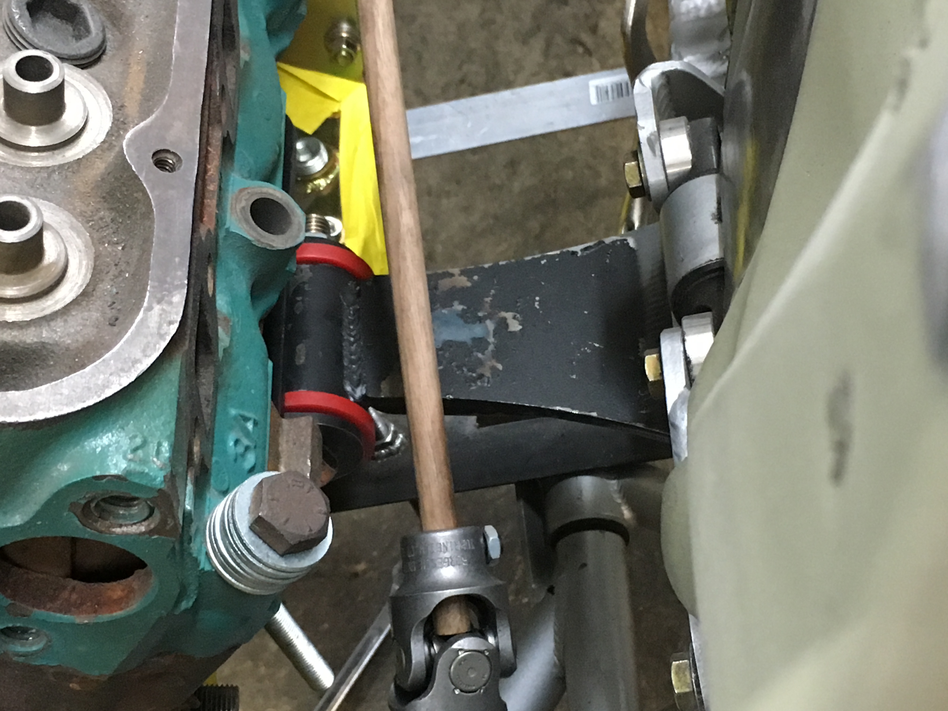

Just adding three pictures for yesterday's comments. New "DD" steering rod replaces the walnut mock up. RR floor pan moved 7/8" outboard. Tunnel piece will have to be rolled to replace original. Steering wheel sits 3" back.
thanks for looking

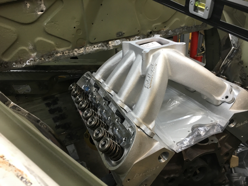

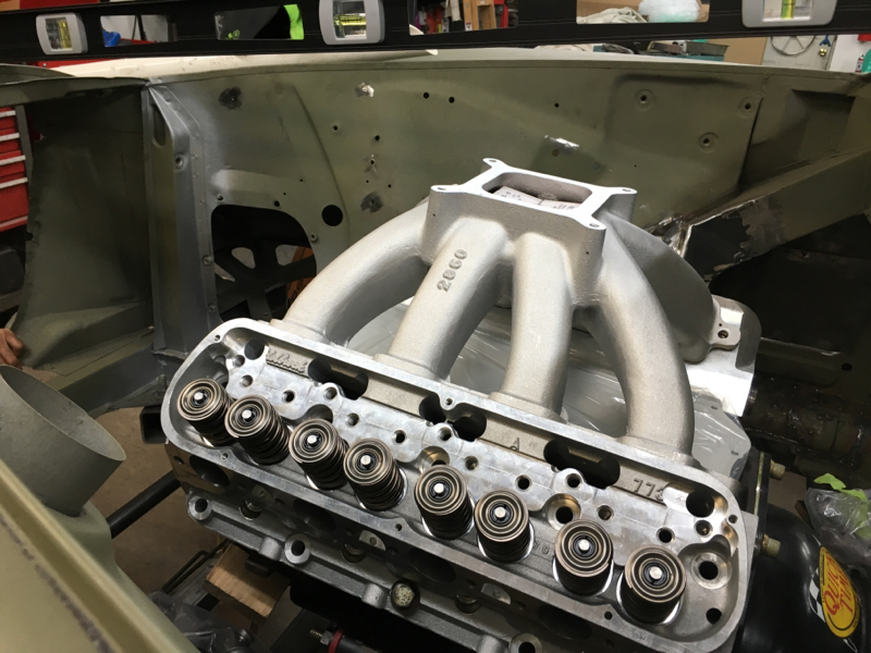

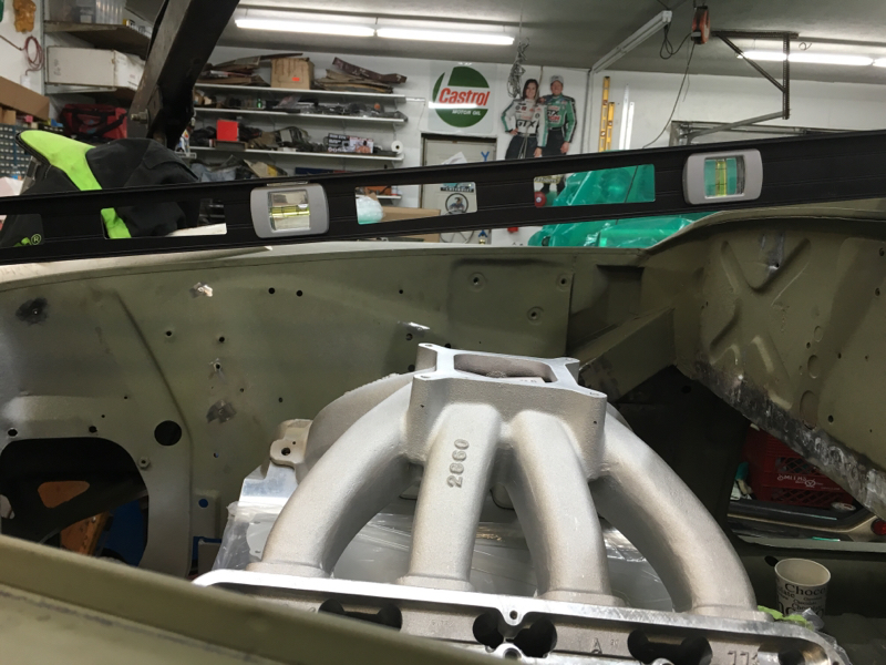

Looks like there is going to be hood clearance issues. Only 4 5/8" from front edge of carb flange to under side of level in the picture.

You might want to consider this intake system instead,
https://speedmaster79.com/au/pce1481...stem-complete/

Primaz,
Love of look of the system you linked. Typically they'll only support up to 600 or so and would not support the heads I've purchased. The manifold in the pictures is ported to the heads.
The battle in my mind is between the FAST System with 8 injectors in the throttle body or a carb.
I'm not fond of going through the hood, or the resulting change in the cars lines, but this time I will.
Thanks for looking. I appreciate the link & comments.

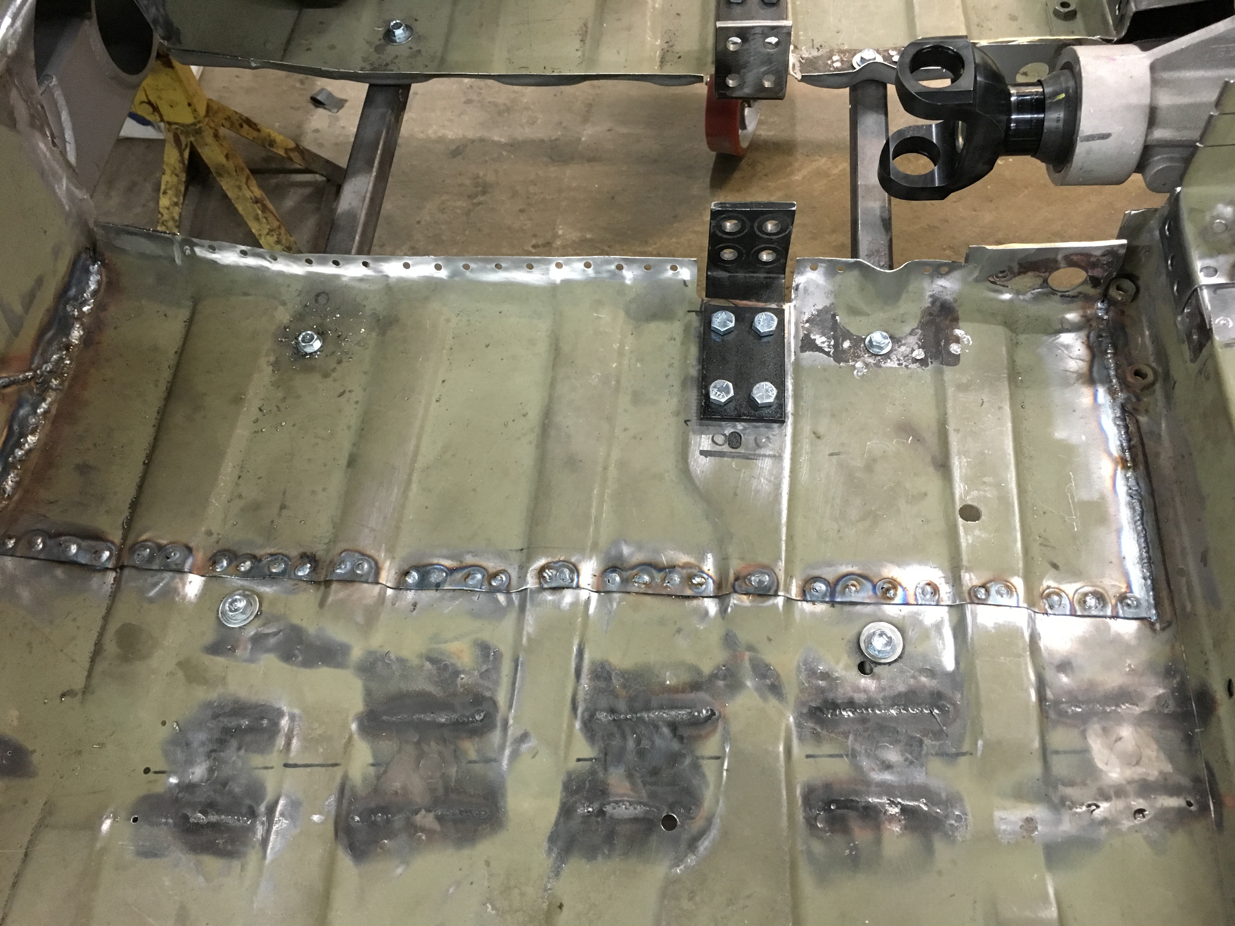

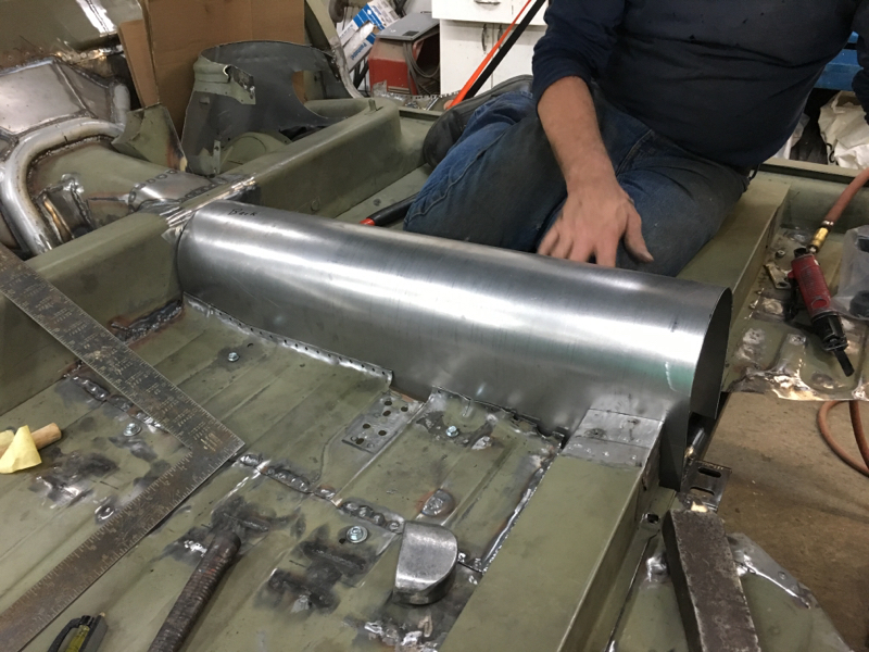

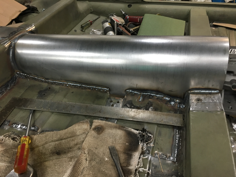

Short week. New drive tunnel welded in place.
1960 MK2 not a restoration, not a rusto rod, just a Bonus Trap-image-358255913.jpg
1960 MK2 not a restoration, not a rusto rod, just a Bonus Trap-image-926637150.jpg

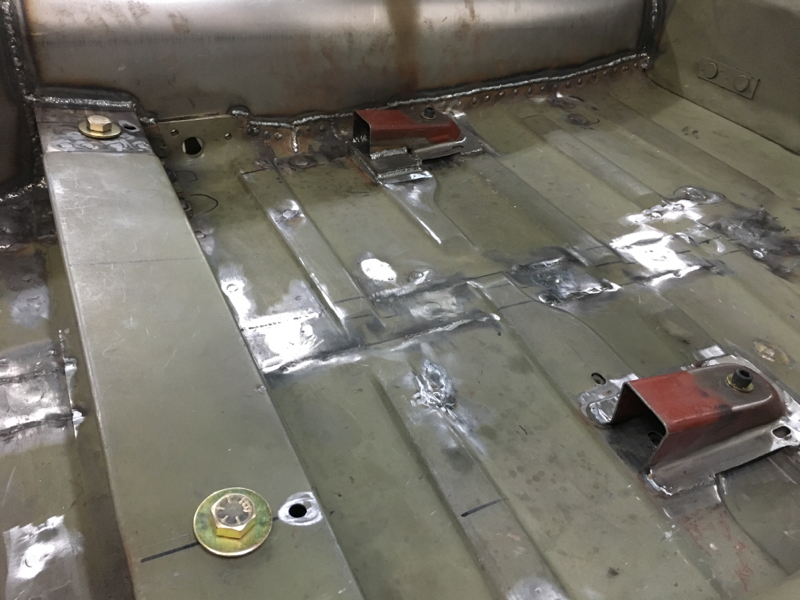

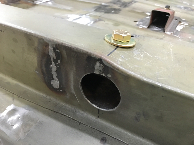

Seat anchor system complete. Toyota Supra seats set back 3 1/2" from stock. Toyota tracks have 2 5/8" more travel than OEM Jag. Seats are narrower than Jag, but sit on a wider base. Set up allows for the roll cage.
