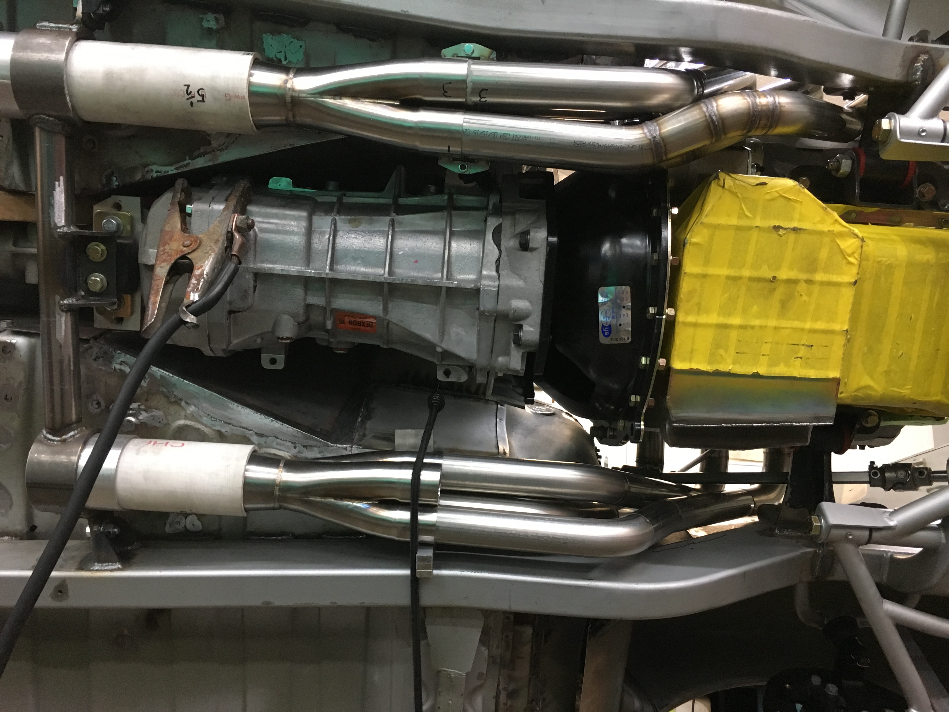

Ahead of that was 3-4 evenings on the rings in the transmission cross member and merge collector positioning.
First and third pipes are removed individually. Pipes two and four come out with the collector.

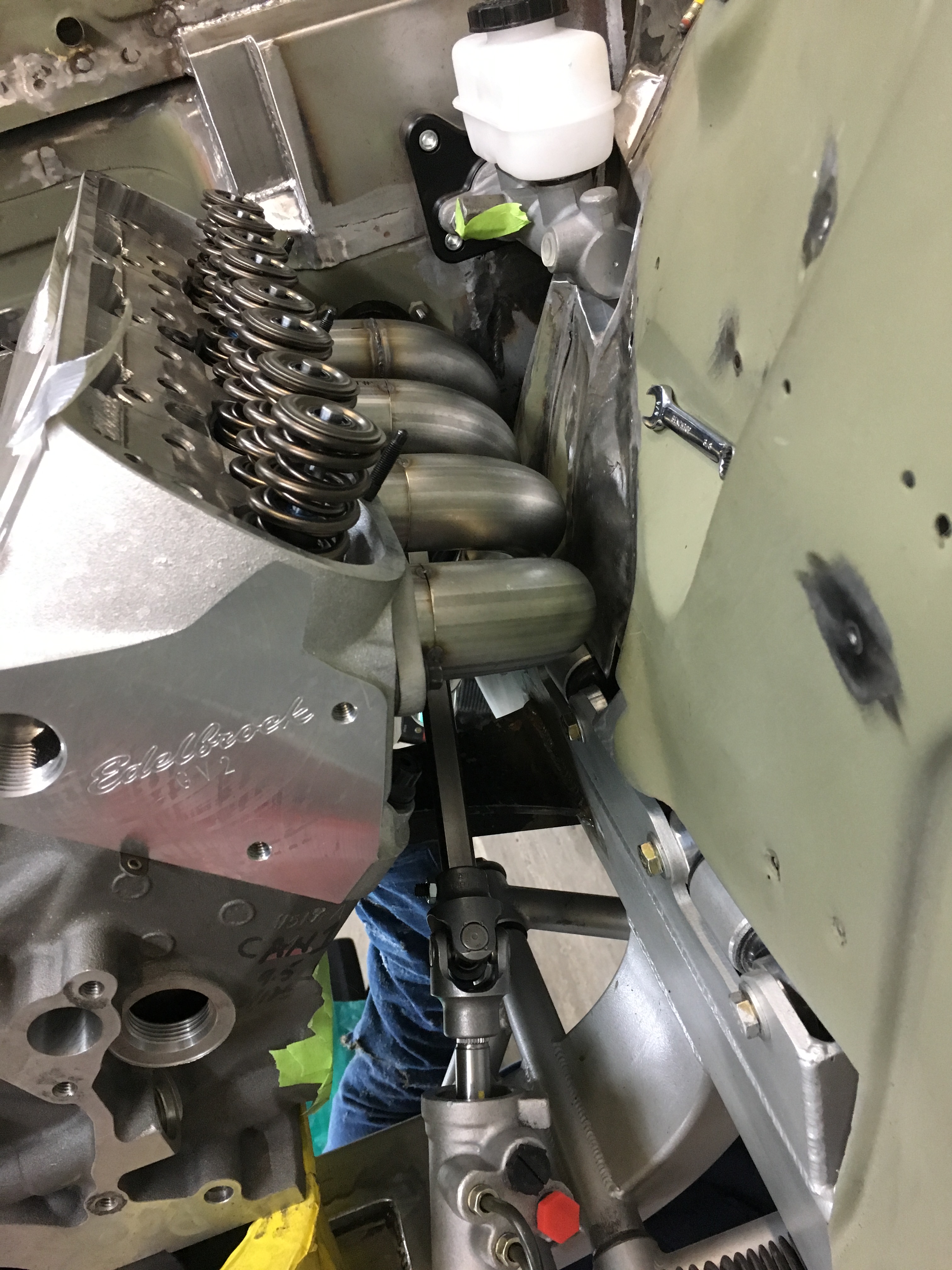

Left side header is tacked up. I missed taking the underside picture of the completed left header. I'll post it on Saturday or Monday. The rear three tubes went to the outside of the steering shaft. The front tube snaked to the inside.

Mike the Magnifico says "you've got to be careful with stainless. Heat makes it move."
Each tube has an individual flange, and is slip fit into the collector. Locking tabs secure the collector.

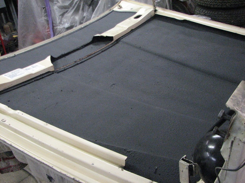

Brake line will travel inside the cockpit through an adjustable proportioning valve. Fuel feed and return will run on the outside of the right rail, I think.
Carb, pump, regulator, and a fuel pressure gage arrived yesterday. 980 wet flow was the projection, but I have not looked at the bench test sheet.
Going to build a mock fuel cell. Hoping to install a 22 gallon cell.

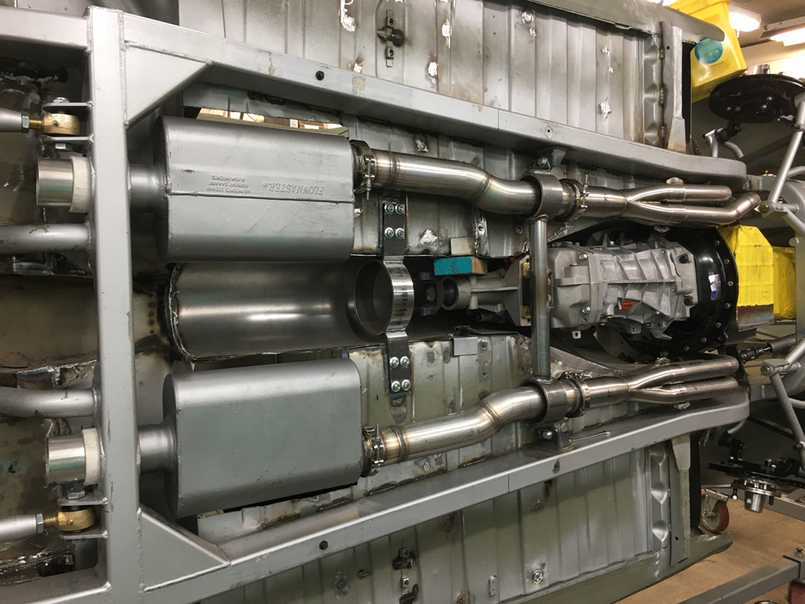

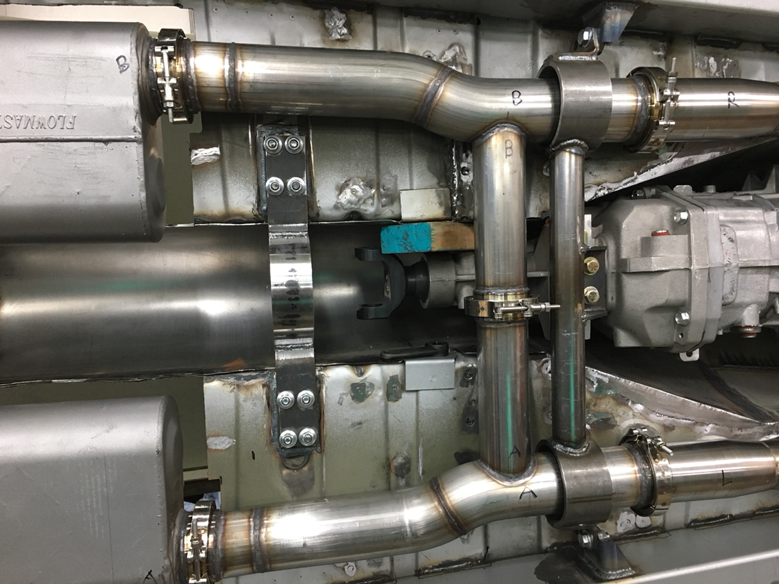

What looks like the "H" pipe is the transmission cross member. Actual "H" will be ~1" behind the cross member.
Lucked out on the e-brake cable clearance due to the engine offset. I'm using the stock lever.
Muffler pockets have been cut into the floors - making two humps behind the front seats.

"H" pipes will help canceling noise, maybe help with economy. I could not find much on "H" pipe theory to determine size. I used 2 1/2". The rest of the system is 3".
"X" piles cancel noise, scavenge exhaust, increase power, & help economy.
There was not enough room for a "X" pipe. I put one on my '77 XJ12L. The Flowmaster "X" (no affiliation) I used has a smaller opening in the "X". some exhaust is pulled through the intersection by the pulse on the opposite side. The remaining exhaust travels the original route.
Tail pipes and length of exhaust also reduce noise. The '77 has more wind noise in the cabin than anything else. All the roar is out the back.
The '60 MK2 will be louder no matter for many reasons - 200 more HP, more compression,
