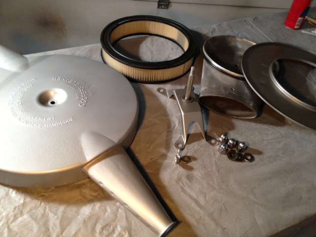

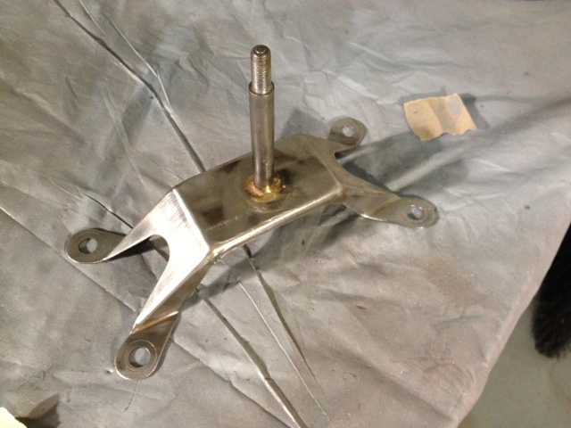

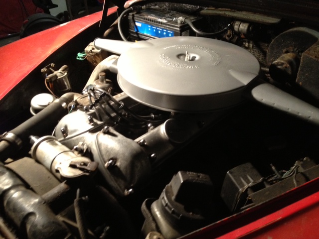

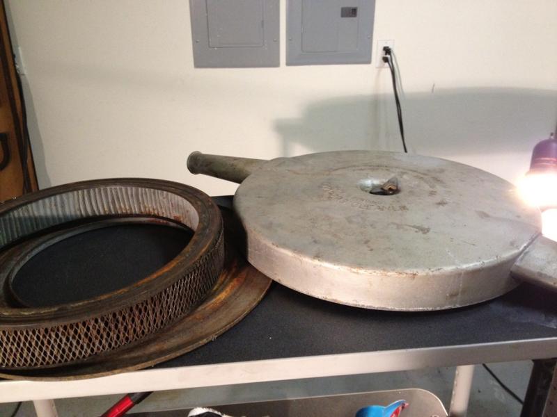

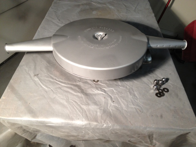

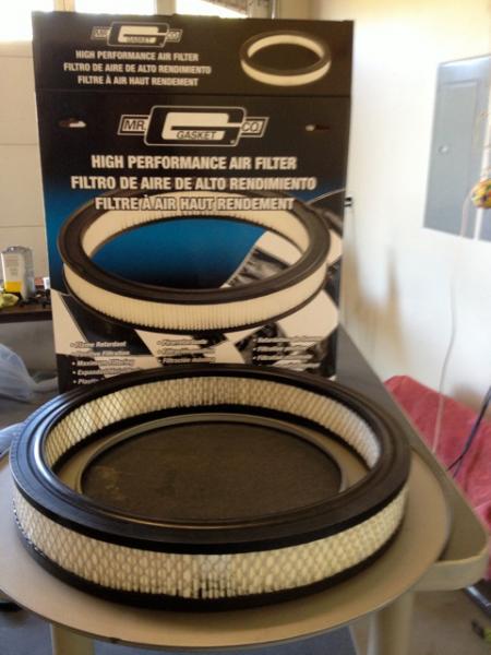

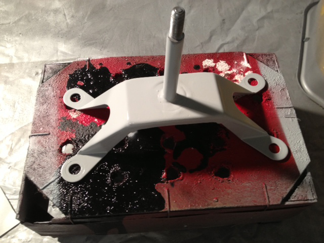

AIR CLEANER: I ordered an air cleaner paper filter on eBay and it is too tall to fit correctly in the housing, just over 2.3". I've ordered a replacement and I will post the result when it arrives. The vendor accepts the returned items. I emailed the OEM of the Coopers filter in France in an attempt to get the original dimensions, since it's a discontinued item, and have received no response. The one I took out that's filthy is OD 13.5" ID 11.75" and 2.0625" Height. Anything over 2" tall or so and the lid doesn't close all the way. I did a lot of searching online and did not find a match to this, but I did find 2 others that I think will fit. Stay tuned.
The air cleaner exterior now has the hammered finish. I used a stainless metallic appliance epoxy on the inside. The rubber is coated in silicone grease (plumber's grease). The whole thing is looking pretty much as it should.
Sorry about making a big deal about the air cleaner support. It needed straightening, too.

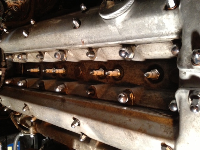

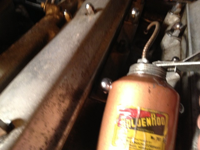

Moving on to the distributor and ignition cables, and spark plugs. I'll drop some oil in the cylinders and attempt to turn the engine over by hand with the spark plugs out, of course.

as far as I know, SNG Barrat USA store has the correct air filters for MK-2 and S type and 420.

Theirs is also too tall for my air cleaner housing. Their replacement for the C16484 is approximately 12.5 outside dia overall, 9 ¾ inside and 2 6/8 height. They also stated, as the eBay supplier did, that "this is not completely as original but it what has been supplied for many years now due to availability issues of any others."
Stay tuned.

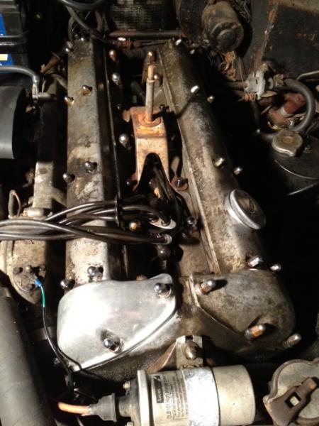

Default Engine start-up prep

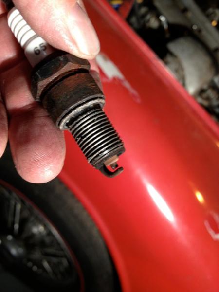

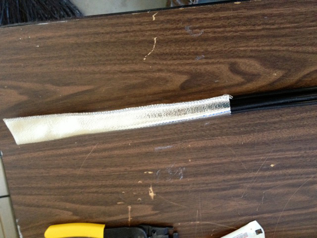

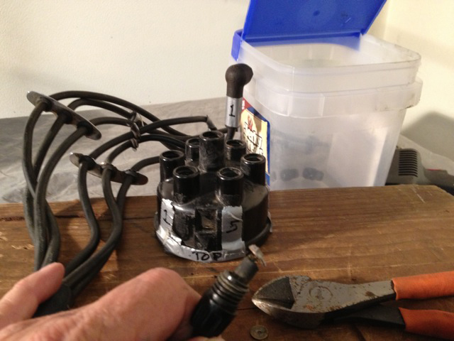

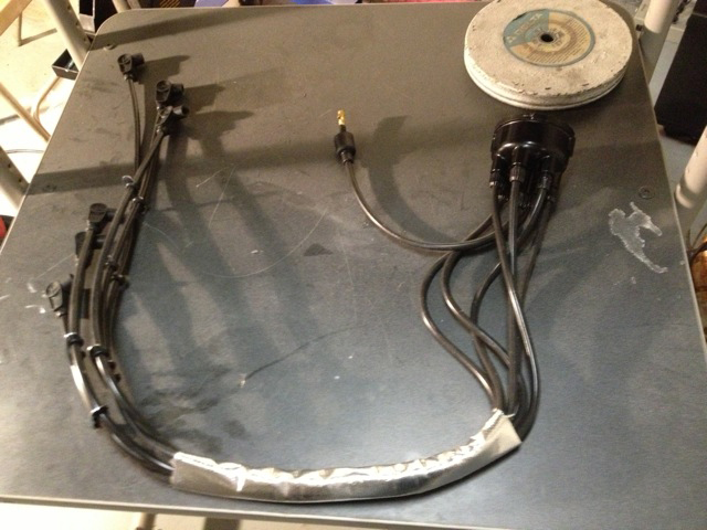

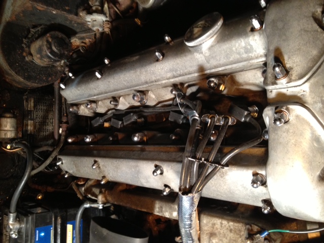

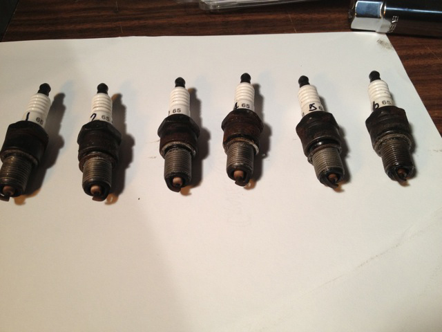

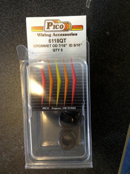

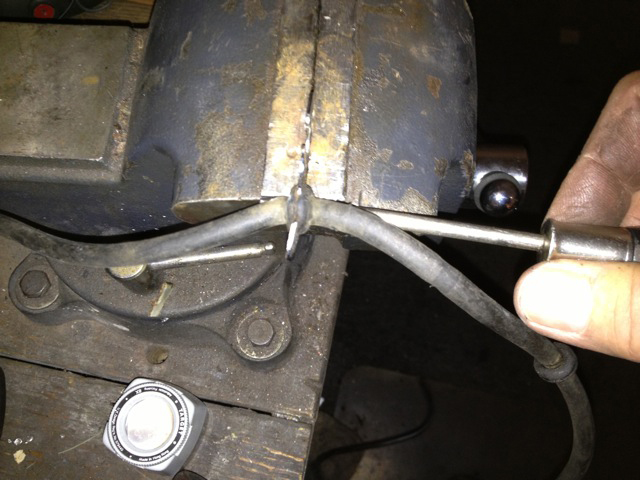

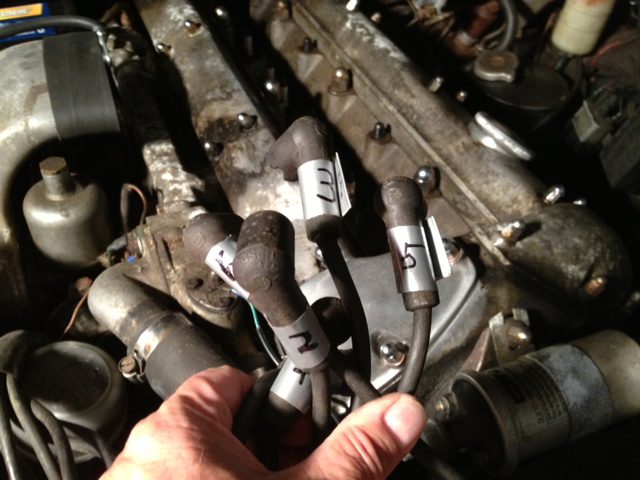

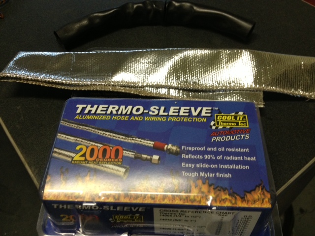

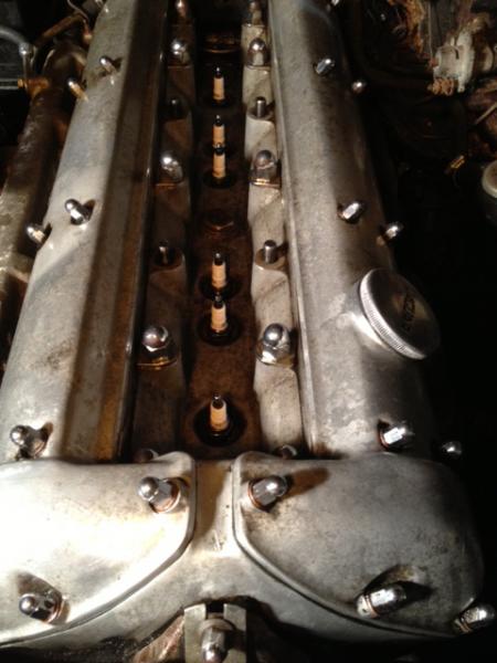

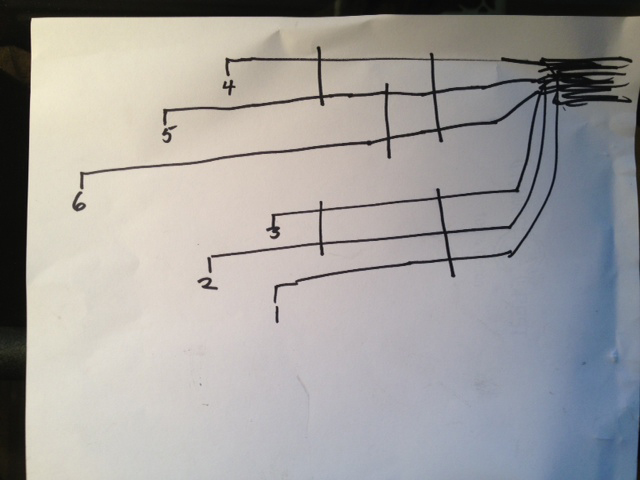

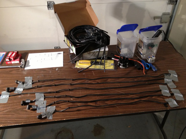

The engine turned over easily. I installed the ignition cable set I made from a kit by Taylor, cleaning up the chrome separators, installing new rubber grommets. These are tinned copper core silicone wires with a neat spring snap to the spark plug. They have the quality worthy of the car, except for the white printing. Sort of like big tire lettering. At least it wasn't embossed . I removed that with some lacquer thinner, then wiped them down with Armorall so they are all black.

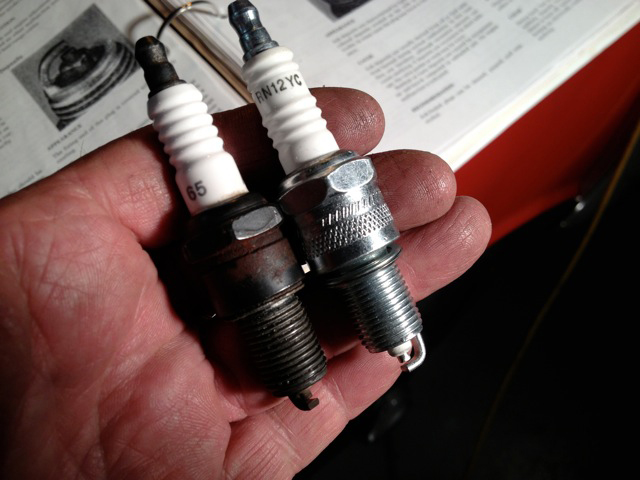

The plugs as found were Autolite 65, needing a 13/16" socket to remove. The are shorter than the replacement Champion 404 RN12YC (13/16" socket version). The #5 and #6 plugs I removed had oily deposits so oil may be leaking past the rings or valve guides into the combustion chamber. If an Autolite 65 is a colder plug, the new ones may relieve the problem temporarily. Head gasket could be blown there.
Now I just want to get the engine running so I can move the car easily in and out of the garage.
Attached Thumbnails 1961 MK2 3.8 Sedan Project.-oldwirenewkit.jpg   1961 MK2 3.8 Sedan Project.-snippingcontacts.jpg   1961 MK2 3.8 Sedan Project.-wiresetup.jpg   1961 MK2 3.8 Sedan Project.-removewireawl.jpg   1961 MK2 3.8 Sedan Project.-plugwiregrommets.jpg
1961 MK2 3.8 Sedan Project.-heatguardconduit.jpg   1961 MK2 3.8 Sedan Project.-thermosleeve.jpg   1961 MK2 3.8 Sedan Project.-ignwirekit.jpg   1961 MK2 3.8 Sedan Project.-newigncableset.jpg   1961 MK2 3.8 Sedan Project.-glazing.jpg
1961 MK2 3.8 Sedan Project.-plugswereshorter.jpg   1961 MK2 3.8 Sedan Project.-savednumbered4analysis.jpg   1961 MK2 3.8 Sedan Project.-oilintocylinders.jpg   1961 MK2 3.8 Sedan Project.-plugsinstalled.jpg   1961 MK2 3.8 Sedan Project.-plugwiresinstalled.jpg

As mentioned, the air cleaner paper elements I sourced from 2 regular Jaguar vendors are taller than they should be to close the air cleaner lid so it seats inside the lip of the lower pan. I did find a replacement that is 14" OD and 2" tall. I centered it in the pan and tightened the lid. It's probably available at any auto supply down the street and costs $12.99 (no sales tax in Oregon). The mfr and product number are in the photo. I found it completely by accident when I was looking for the sparking wire kit. It's more common for 50s Chevies I was told. I spent an hour or so searching through product catalogs to find something that fit well.
Attached Thumbnails 1961 MK2 3.8 Sedan Project.-genericpaperelement.jpg   1961 MK2 3.8 Sedan Project.-qr2mfr.jpg   1961 MK2 3.8 Sedan Project.-assbledaircleaner.jpg   1961 MK2 3.8 Sedan Project.-aircleanerinstalled.jpg

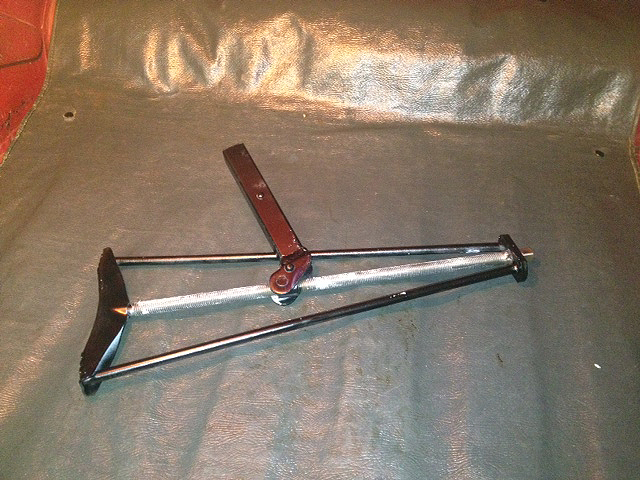

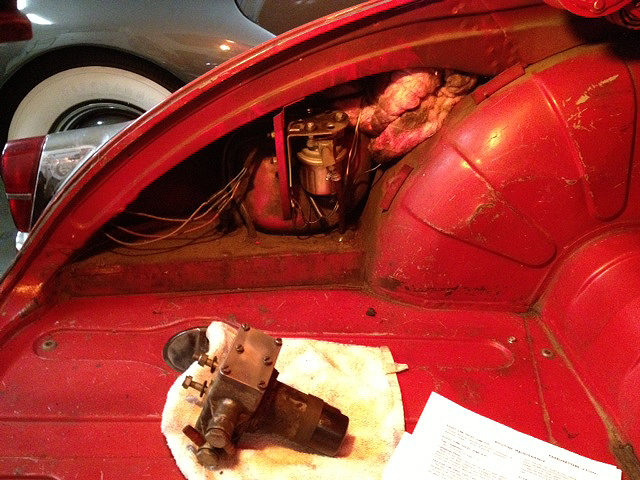

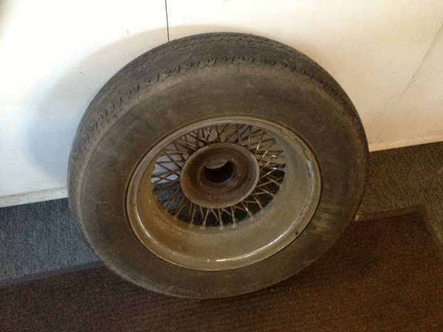

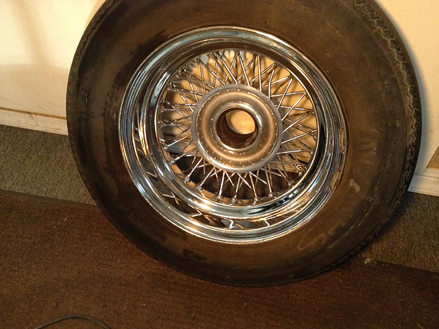

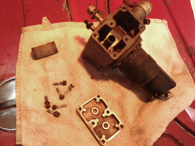

A funny thing happened on the way to cleaning the fuel pump filter in preparation for re-starting the engine, a filthy trunk. Being easily distracted, I decided to clean it up. This included giving the interior and the mat a thorough scrubbing, stripping the tools of paint and rust (the crank especially), the wire-wheel spare with its hold down, and the side panels, under which, on the left I found the fuel pump.
When the fuel pump didn't match the service illustration, I went through a couple of boxes of crusty old parts and found the original one. It was 1/3 full of a rusty powder, like cocoa, and the filter, not sure if it will clean up in gas. I may be able to repair it, but I'll do it later. It obviously wouldn't operate with all that stuff in it. The new one works fine. I'm going to slosh some gas in the tank, drain it and look at it, then put some regular gas in it.
With the Packard, I had hardened valve seats installed.
QUESTION: What is the normal procedure for dealing with today's unleaded ethanol-loaded fuel?
There was an empty bottle of lead substitute in the boxes.
I cleaned up the spare.

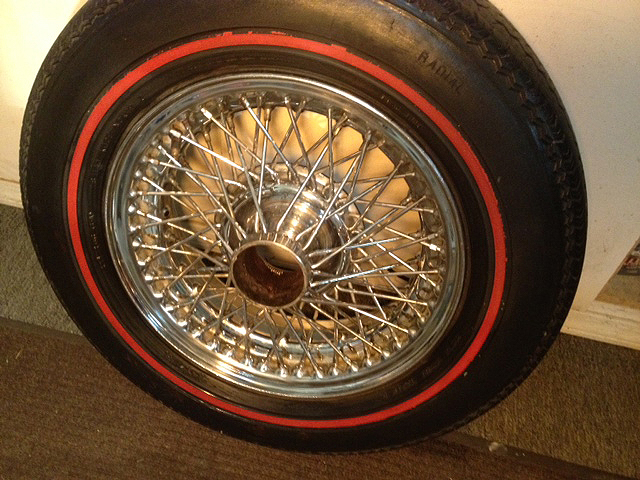

QUESTION There is one broken and one bent spoke. What is the normal procedure for that? I suppose a small reach-around wrench like the ones I have for brass fuel-line fittings would be ok on the spokes.

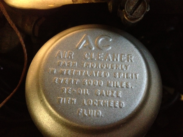

Couple questions up there to grok. Also, the AC breather cap requires the mesh to be washed in petrol and coated with "Lockheed Fluid." Is that brake fluid?

Originally Posted by JoeSantana
Yoo Hoo, Anyone. Couple questions up there to grok. Also, the AC breather cap requires the mesh to be washed in petrol and coated with "Lockheed Fluid." Is that brake fluid?
when it comes to wire wheels and spokes' replacing or repair, I prefer to let an expert do it because I know my limitations. There is a company called "Hendrix Wire Wheels" which deals with wire wheel repairs, I would ask them; I know that the spokes have to be torqued, so when one breaks, others will follow, but that's about all I know.
my '65 S type runs fine with unleaded, no valve issues, and I know little about Packards except that the original Heater Valve in my S type came from a 1950's Packard heater valve design.
I have cleaned the mesh filter with gasoline and put it back, never applied anything to it. The Factory Service Manual says to "clean it with petrol".
I have no clue what "Lockheed Fluid" is.

Thanks, Jose. There's a brake servo air cleaner. The cap references Lockheed Fluid. Lockheed Fluid is brake fluid. L8 in the Service manual.
OK at engine swap I got the point on modifications and that this is the primary interest of MK2 forum members. Interesting that parts were sourced in USA, (the interchange manuals offer plenty of evidence of that), but the 50s were our automotive heyday. Just hadn't thought that European mfrs looked here.

ok got it, I have the same "filter" in my S type. I thought you were asking about the cylinder head breather mesh.

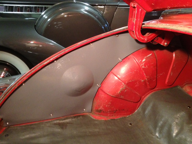

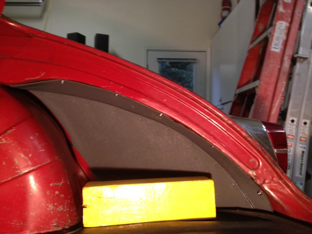

The detour through the boot is done for now. The side panels are clean and painted with new fasteners, size 6 instead of the size 4 originals, half of which were gone. The wood block got a fresh coat of yellow paint. I also removed the license plate which had to be cut off with a Dremel disk. I'm cutting off and removing the 2 broken/bent spokes on the spare and replacing those, with some help from Consolidated, the local Jaguar specialists, where I also joined the Oregon region. So turned my attention back to the fuel supply. There is no filter built into the new fuel pump, so that job is done. I removed the inline fuel filter with the glass bowl upfront. Cleaned everything thoroughly. Removed the banjo bolts on the carburetor and found no filter, a cone-shape spring with a screen, at either end. Next, the gas tank.

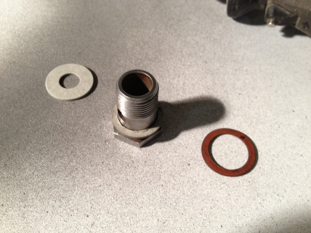

In removing one of the banjo bolts from the incoming fuel line to the carburetor, I dropped the fiber washer and could not find it. I bought a fiber washer with the same OD and used a sanding roll on the Dremel tool to get the ID to match the original.
The petrol tank filter/plug was on so tight, I needed a 13/16th in. socket on a breaker bar to loosen it after soaking the edges in Kroil penetrating oil overnight. The gasket gave way, so have to replace that, but it's a wonder any fuel went through that filter. The tank had about 3 gals in it of deep red-orange-brown fuel. I'm going to put a gallon of fresh fuel in, slosh it and drain it. See what that looks like. Then another with the line to the fuel filter up front disconnected just before the filter, to see what the pump pushes through. I'm expecting more gunk from the fuel line itself. Once it looks ok, if it does, I'll move on tot he cooling system, then try to start the motor. If not I'll remove the tank and have it treated at Mac's radiator and sealed.
The petrol tank filter/plug is brass, I discovered in cleaning it. I boiled it and cleaned it with Brasso and a toothbrush, the plug with a brass brush. There was a small tear at the top and 2 tiny pin holes which I soldered. So now to find a 1-3/8 ID gasket.
Attached Thumbnails 1961 MK2 3.8 Sedan Project.-banjoboltfiberwasher.jpg   1961 MK2 3.8 Sedan Project.-petroltankfilter.jpg
the seal is sold at SNG Barratt USA store, around $ .90 cents. Tell them to mail it in an envelope so you don't pay UPS $15.00 to deliver it. I think they are the same seal for all Jaguar tank's drain bolts, (some type of neoprene), my '65 S type uses the same tank drain bolt seals as my '84 XJ-6. you might add a little Hylomar between the seal and the tank for a positive leak-free fit without having to overtighten. That's what I do. (I'd use Hylomar on that fiber washer too).
