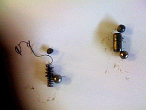

Consolidated replaced the master cylinder with a new one. Apparently the interlock/detent may need attention too. But in the meantime, we just won't push the stick so far forward. That prevents it from getting stuck in 1st.Through freeway gridlock, through downtown, I delivered the car today to my youngest son ,James, who now has a garage for it, together with all the parts and items, manuals, a floor jack and stands. I've put 150 miles on the car since getting it drivable. Now I'm going to refresh my garage and prepare it for the return of my '40 Packard Super8 Convertible Sedan, which is being meticulously restored by my eldest son, John.

Thanks, George. I repaired the detent/interlock on the Packard by removing the center plate in the floorboard and then the lid of the transmission. The detent is part of the lid on a Packard, so it's easy to fix it on the bench. I'll check the book to see how the Jag is set up, but that sounds like a great interim fix. Once I knew not to push it far forward, it didn't get stuck again. James was able to drive it around his neighborhood last Saturday when I delivered it without getting stuck. Here is the set up in the Packard and the condition of the ball bearings and springs when I opened it.
