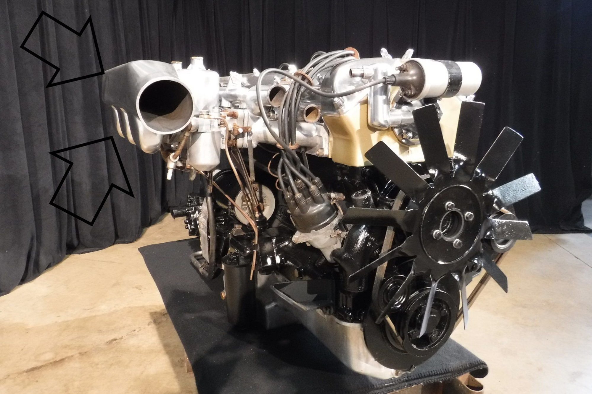

I was the winning bid today on a 3.8L engine from a Mark 10. I plan to swap it into my 240 (which is finally running great). It should fit, right!

As the 2.4 litre engine is a "cut-down" 3.4 litre block, and the 3.8 litre is a bored out and linered 3.4 litre block, it should fit perfectly, but it probably won't take the triple cars that the Mark 10 had as the engine bay is a lot smaller on the Mark 2 bodies.
Don't forget the back axle ratio may not suit the larger engine revs wise.

Fraser is correct re carb fitment - the large aluminum air box will foul the inner fender at the points noted. The top edge will be just below and under the upper fender, so the inner fender needs to be opened up all the way to the top if you want to retain this intake. You'll also need some throttle linkage as I recall. It looks like you have some compression variances approaching 30% which seems high - perhaps someone who knows these motors will comment. Good luck with the project - I installed a straight port head on a Mark 2 a few decades back and it worked well.

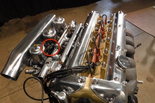

The front carb looks to be a starting carb. A leak down test is in order, hopefully just some sticking valves.

The front carb is a carb just as the rear and middle carb's are. They all do the same thing which is throw gallons of fuel and air in to the plenum chamber which divides the mixture to the six cylinders.
There might be a starting carb or to give it its correct name the Automatic Enrichment Device (AED) but this is small barrel with an electric solenoid attached. I think I am right in saying it is different on the 240 which had Solex carbs not SUs and had a manual choke set up. I think they changed back to SUs but retained the manual choke. Please correct me if I am wrong.

My 1968 240 has 2 SU HS6 AUD 256 manual choke carbs. The 3.8L I won is from a Mark X and has HD8's. My understanding is that a starting carb's jet is set up rich and is used in place of a choke. If you look carefully at the photos you will see a solenoid structure that is connected to a temp sensor that closes off the carb once it comes up to temp.

You are right Jim that is the AED which is connected to the front carb and takes its fuel feed from the front carbs float bowl but all three carbs are set up the same and the AED does not have any influence over the working of the front carb. My S Type has two HD6 carbs and the AED which I have converted so I can switch it on and off from the cockpit rather than relying on the sometimes unreliable Otter switch.
Your compression problems might be a sticking valve but unlikely or you would have no or very little compression. It might be coked up valve seats which are leaking and would benefit from a decoke and valve seat re grind (you do not need hardened valve seats fitted as the XK engines all had them fitted from new. Just in case your local engine builder tries to pull a fast and expensive one on you) or if the engine has been sat for a long time it could be sticking piston rings and a good soaking with diesel down the bores might cure that.

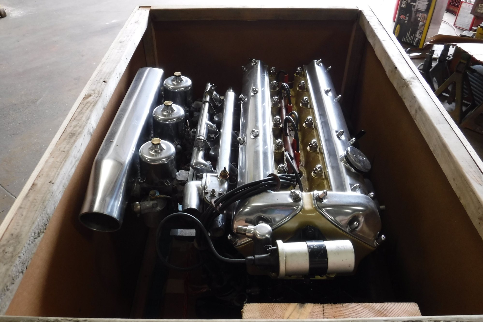

It has survived the trip from Oregon in one piece. A little over a week in transit to New Jersey. Now I have to decide what to do with it next. Shops around here are charging $125/hr! I can work cheaper than that.
