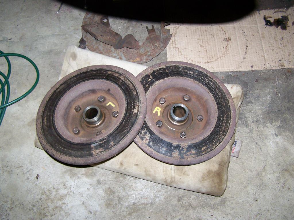

The photos speak for them selves.
I believe the rear rotors to be unserviceable, but I can't find any minimum specs for them _ not even the Jag mechanic could find them in his shop manual _ strange.
