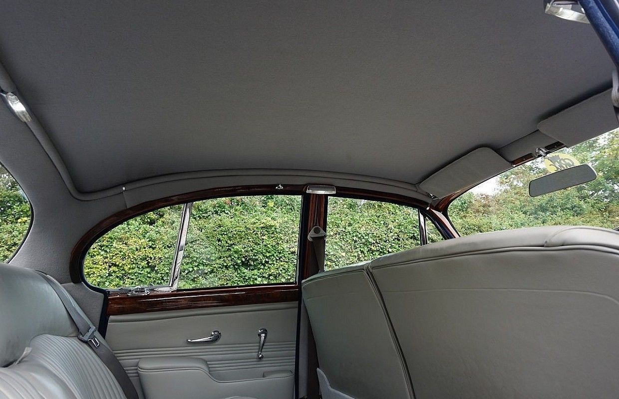

Glue foam backed Union Cloth direct to the dome like S Types did until late cars with boards or try aluminium formed/shaped on an English Wheel. Presume your glass fibre board is too damaged to take an impression from & mould a new one? The dome or board needs to be perfectly prepared or you will see bumps or depressions in the headlining.

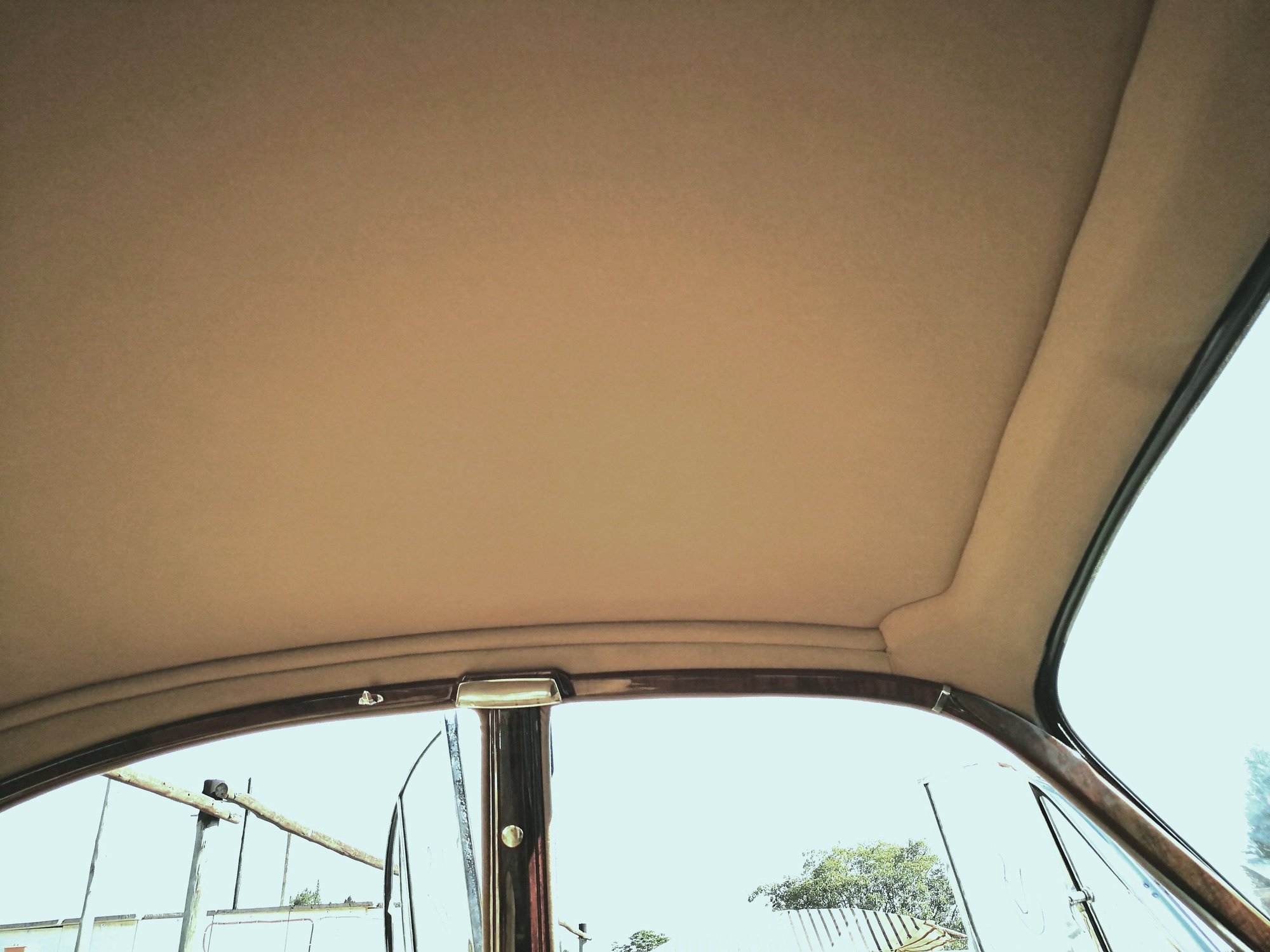

This is my S Type glued direct to dome. Cloth only pulls taught on front metal former once mirror, sunvisors & wood are fitted/mounted & all pulled tight to dome. (excuse colour shift on second pic. Contrast too high for cellphone cameras ~ top pic is colour correct). (Colour combo Biscuit). Remember S Type & 420 are identical shell from scuttle/windscreen back.
Here is a '68 420 for comparison in Cinnamon. (Cinnamon interior & Sable (brown) exterior was offered on some of the final cars)

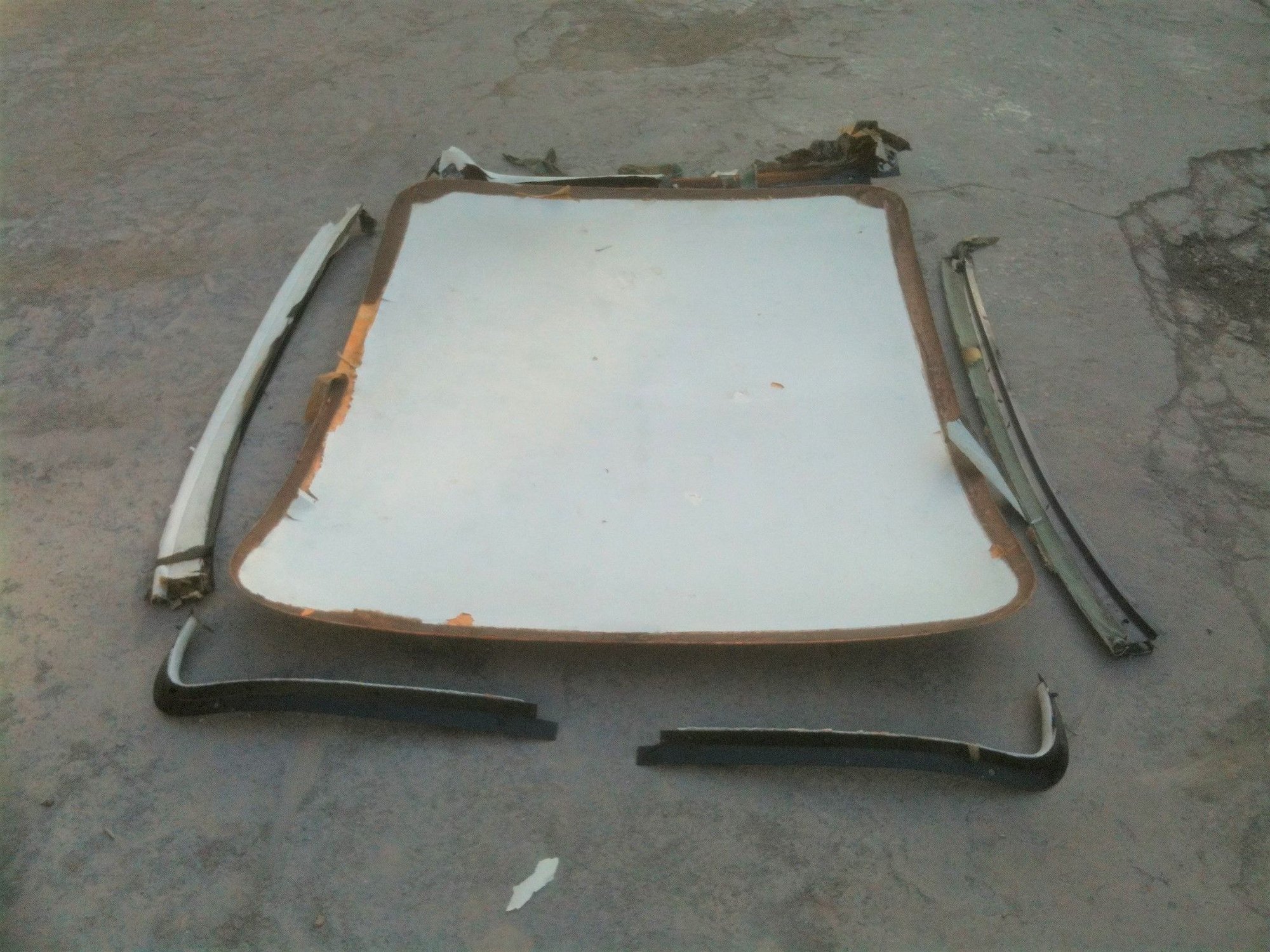

As you can see from the above photo I took mine out and repaired it when I rebuilt my S Type. As Glyn states the head lining in the late S Type 1966/67 and beyond is the same as the 420. Mine was cracked and chipped so I laid it out as you can see and gave it a coat of clear resin just brushed on. I made the mistake of trying to remove some of the white surface as this was peeling off when I removed the old head lining material before applying the gel resin. I mistakenly thought that the head lining fabric would cover the headlining with no problems as it was now strong and smooth but unfortunately the dark patches where I had removed the white paper showed through the fabric. I ended up putting a second layer of fabric over the first and gluing them together. No more dark marks and I have the thickest, softest head lining around.
Just as an aside you cannot remove or install the head lining board in to the car through any of the doors it has to go in through either the front screen or rear screen apertures.

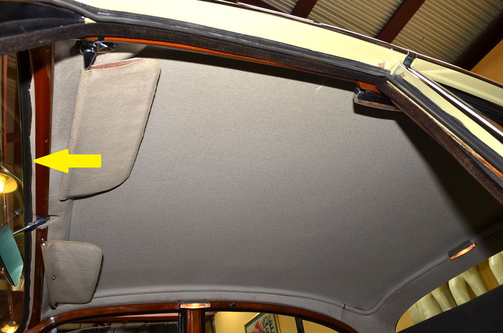

Here is a grey interior on a dark blue car. I think it can look very smart. Regarding your foam worries, we face similar conditions in SA. How much of it's life is the car really going to spend in the sun? On a relatively low use car I don't think it will be an issue. My lining was grubby but fine after 90K miles. A daily driver is possibly another matter.
If you don't take the windscreen out you need to work the front very carefully. The liner is supposed to be glued into the rebate & then the screen rubber fitted or you end up with a mess like this. There are obviously "work-arounds" to do it neatly.
