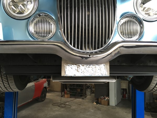

Jon is right with the ram air vent scoop underneath the front valance it will scoop large amounts of air and then I have a sheet metal "V" that then directs that air around the engine and then the air vents out thru the triangular holes which Jon posted pics of. I do want to point out that it is the combination of both that enable the engine bay to keep cool. I had the triangular vent holes prior to the ram air intake and that did NOT keep the engine bay cool, in fact it was a oven until the addition of the ram air intake. The Jaguar as a poor design to vent out air out of the engine bay but with these mods it is not an issue which is key in stop and go driving.

Not that much at all. There will be no clearance issues at all, as my 3.8s is highly customized with a coil over suspension, custom lower control arms that has dropped the car down around 4 to 5" off the ground. My car is substantially lower than any stock Jaguar and I have no issues with the ram air under the valance. Also my car has a custom flexible front valance added as the stock Jaguar had nothing to cover the front frame, etc. We took a front valance from a newer car and adapted it so that it now has a front black flexible valance around 3-4" tall and the ram air is another 1-2.5" below. You hardly see the aluminum ram air but it creates tremendous airflow. I did so many other things prior such as all the fancy special insulated hose covers, heat shields, etc. which did NOT fix the heat issues; the ram air did the trick.

Looking again at the pics, I assume I won't need the lower scoop as this is for an oil cooler, is that correct ?

Yes, I added a steering fluid cooler as that was one of the areas that was affected by the previously high engine bay temps prior to the ram air being added.

Here are some pics, the main thing was the front aluminum valence that scoops the air up and inside the engine compartment and in my case being a V8 I put a "V" to route the air around both sides of the engine and the openings at the rear of the inner fender wells allows the air to exit and flow. The "V" section directs the air on each side of the engine and both rear inner fender wells have that triangle shaped opening so the air flows around both sides of the engine and exits at that rear triangle openings right before the firewall. The other more expensive things like special high temp coating of the headers, fancy heatshield wrapping of wires, hoses, etc., increased radiator, etc. I am sure helped but none of those to me made as much of an impact as the valance scooping massive air funneling it around the engine/hot exhaust headers and then out of the engine bay. Prior to that I did all of the heat treatment increased radiator, etc. but the engine compartment just turned into an oven where the heat was trapped.
