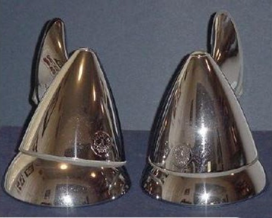

Rock also manufactured my Spot Lamps which you can see in this picture. They are 5¼" inches in diameter for the S type's 5½" diameter auxiliary lamp buckets, 2 inches larger than the MK-2's buckets.

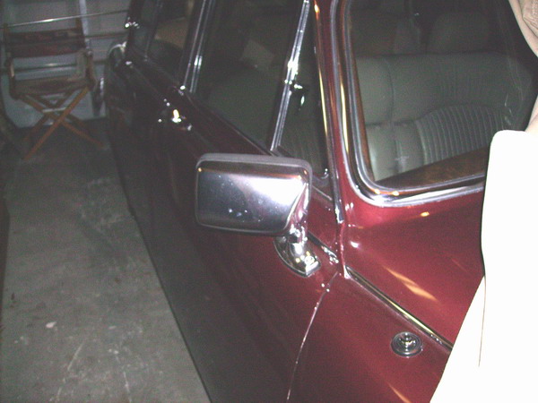

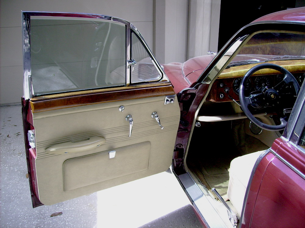

as to appearance, look at my S type, in my opinion they look awesome, but it is a matter of opinion. I have a friend with a MK-2 who saw mine and did the same, his wife loves them too.
For me it is also a Safety First issue, the old motorcycle-style Lucas mirrors, whether on the fenders or the single one on the driver's door are totally useless in my opinion.
To scare you even more, installation is serious surgery, I measured twenty thousand times before I put the drill to the metal. I even made a template so both sides were perfectly equal. You have to consider the movement of the quarter window ventilator when placing the XJ-6 mirror, you have to drill 1" inch round holes at the door's front jamb and at the A post jamb to install a rubber neck "accordeon", you have to go on a junkyard search for the right rubber accordions, (this is where the mirror's wiring goes thru the door to the interior of the car). And the dash needs to be removed for easy access to routing the new harness, dash completely out.

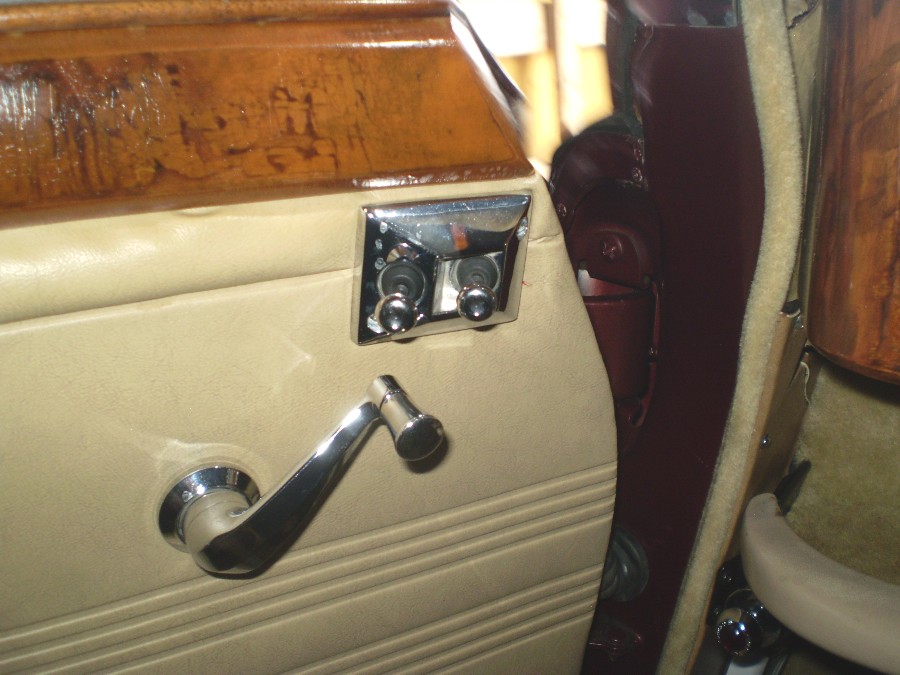

Otherwise, the electrical connection of the mirrors is a simple Black Ground wire to any chassis screw using a ring terminal and the Red positive wire goes to an empty space at the fusebox using a female spade terminal, it can't get any simpler.
The XJ-6 switch I installed at the door, per the picture below. That was mostly easy.
