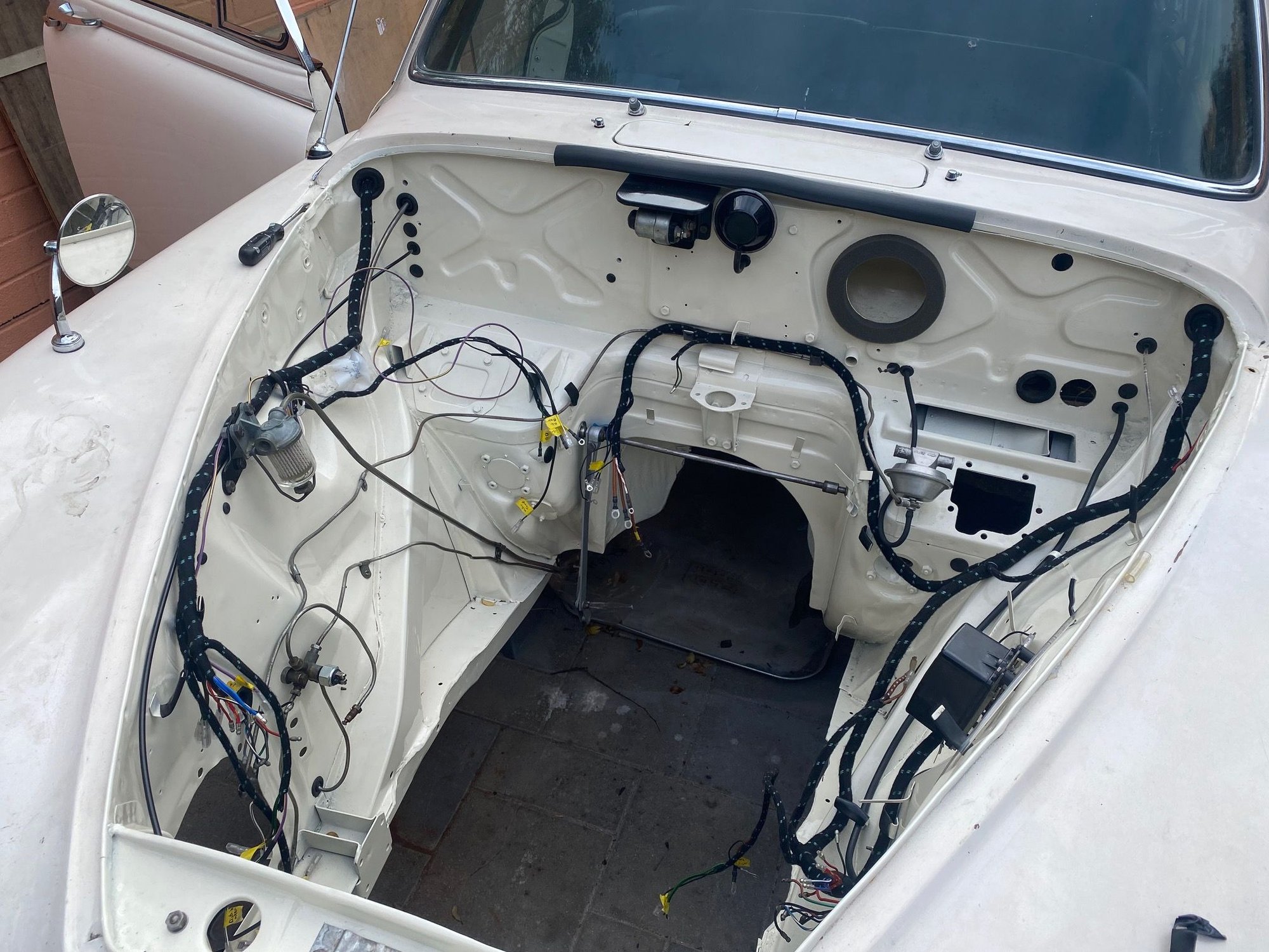

Not sure about the MKII harness but I just replaced the main harness on my 66 S Type and there is NO problem connecting it to the rear harnesses running down the sills. On each side of the interior under the dash there are bullet connectors that disconnect the main harness from the rear harnesses. Very simple. If you pull off the kick plates and newspaper tray you can see that connectors are stuffed into holes to protect them.
Replacing the harness itself was fairly easy. Take your time, take lots of pictures and lay out both harnesses to see what goes where. Also, keep your old harness. I had to go back to it several times to figure things out.

New Harness installed

The engine bay photos are just stunning. If you have not already, post more photos. Thanks for sharing as it provides tons of inspiration to me and others.
