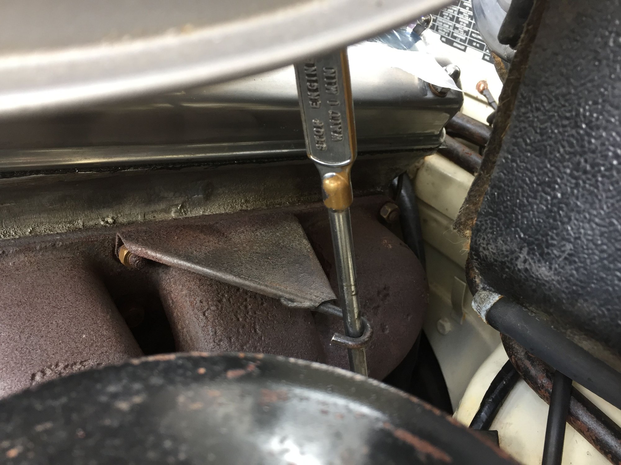

I'm Restoring a MK2 which came in bits. Could somebody please post a photo of The Dipstick support bracket and the Clutch Slave pipe to hose Bracket as they are located on the Engine

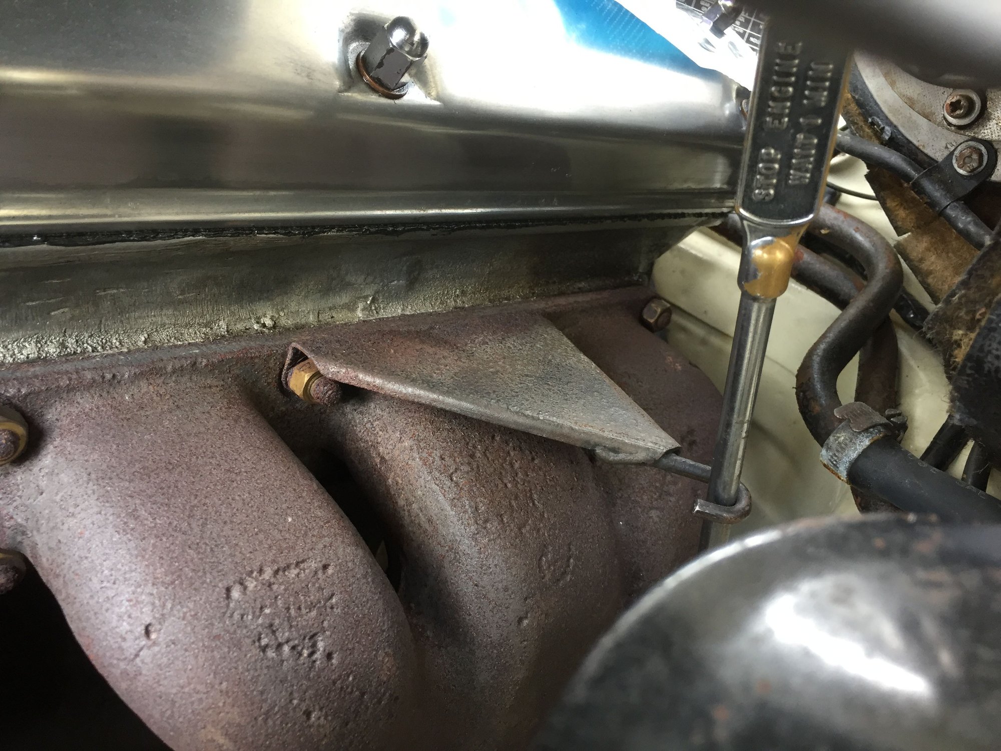

This is the dip stick holder in position. Can't help with the clutch as I have an Auto.

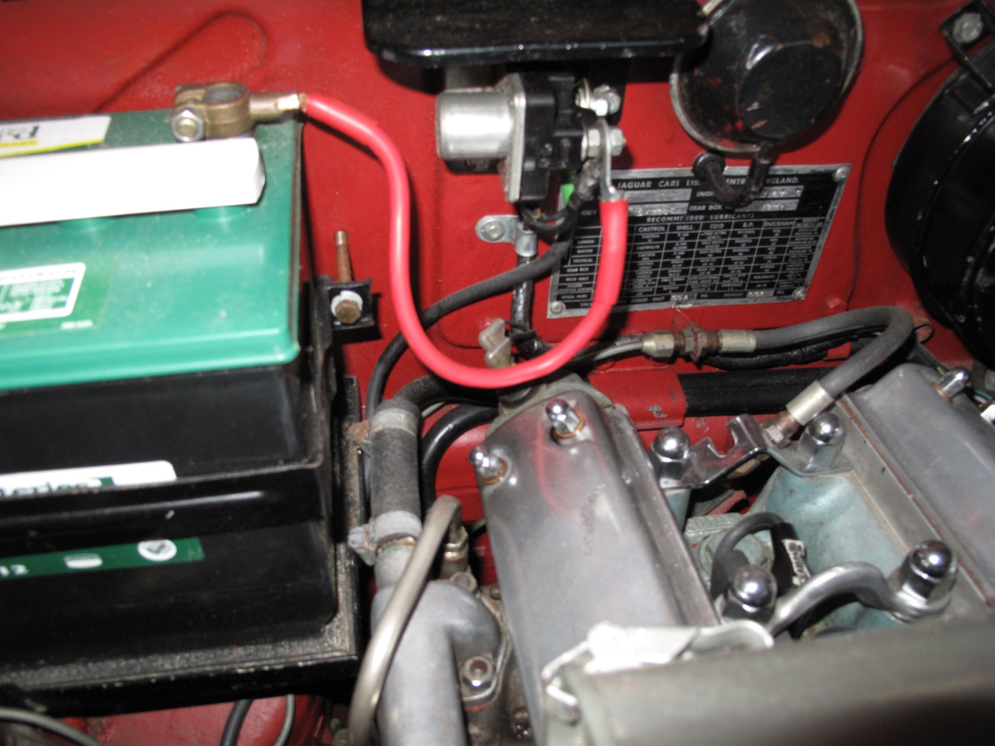

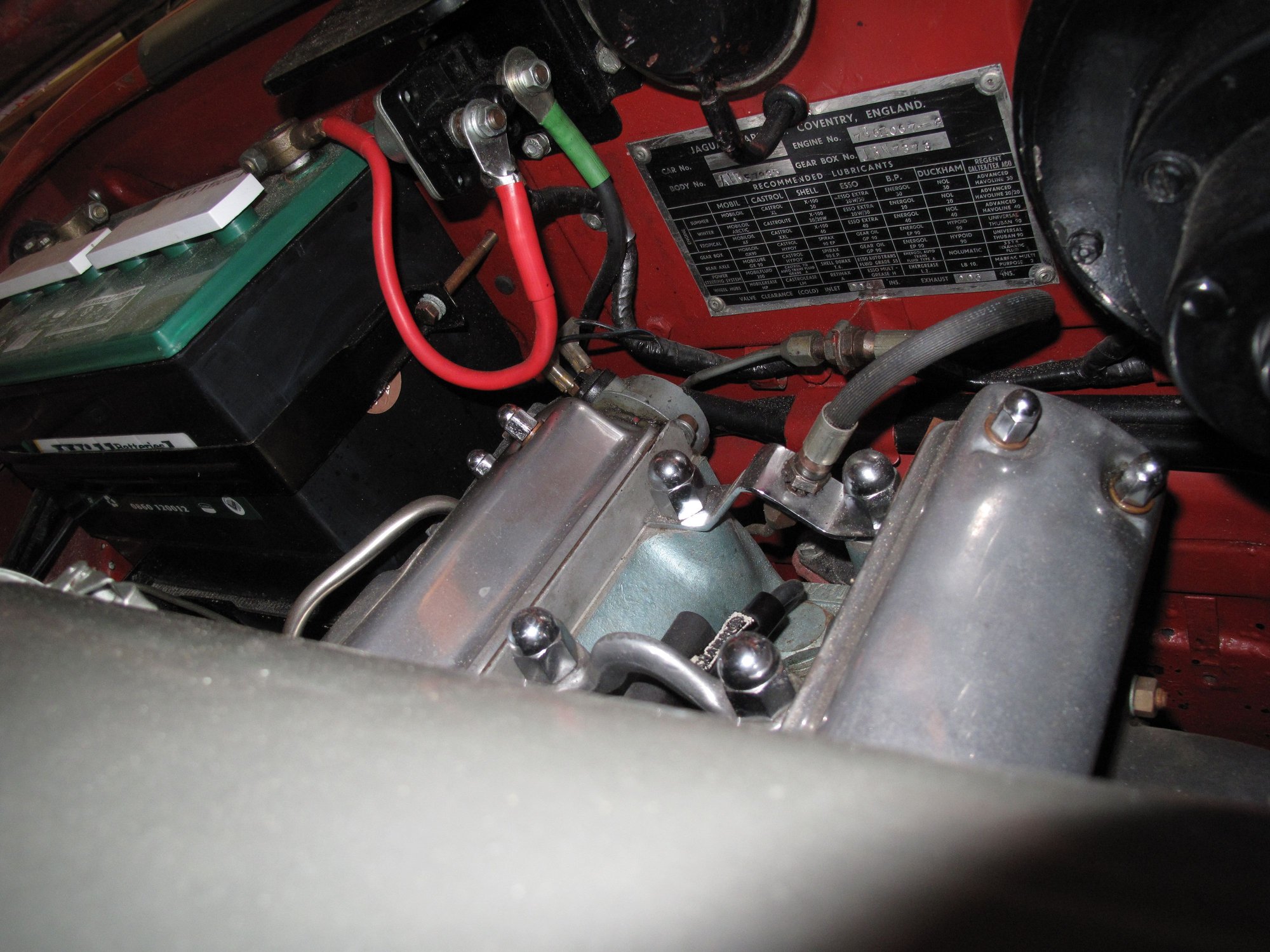

https://www.jaguarforums.com/forum/m...umbing-240884/
