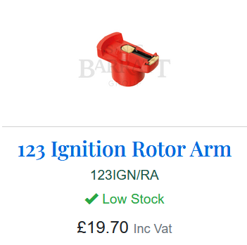

Units with a metal stud frequently suffer from the spark jumping to the distributor shaft & not the cap.

Barratts sells the 123 ignition rotor arm only because of all the trouble with rotors. They will still sell you the unit I used in my post above but only as a special order. The rest are distributor specific. e.g. V12. The studded horror is still around however.
