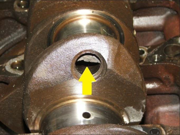

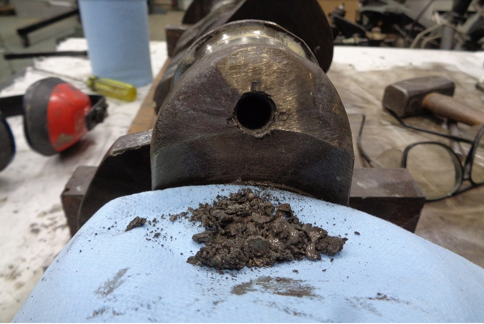

A good example of why we should remove those crankshaft plugs when rebuilding an XK engine and clean the oil galleries.

Some years ago I was at a Jaguar workshop and was shown the results of an incorrect engine overhaul in a MK2 by another workshop.
The crankshaft plugs had not been removed and debris build up had blocked the lubrication holes on a couple of the cranks.
The result was big end bearings running dry and lack of lubrication to the associated cylinders and pistons with severe scoring of the cylinder walls.
The workshop was making an assessment of the reason for the damage and costs to repair on behalf of the owner of the car who was sueing the workshop which had done the original overhaul.
This is just to let you know how critical this is when dealing with older Jaguar XK series engines.

It's amazing Bill. That awful second photo crankshaft only required cleaning and a 20 thou grind of all journals to get into spec. We won't talk about the cylinders. They had to be enlarged to maximum.

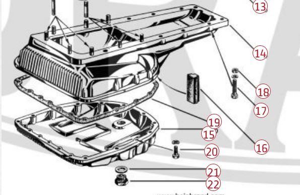

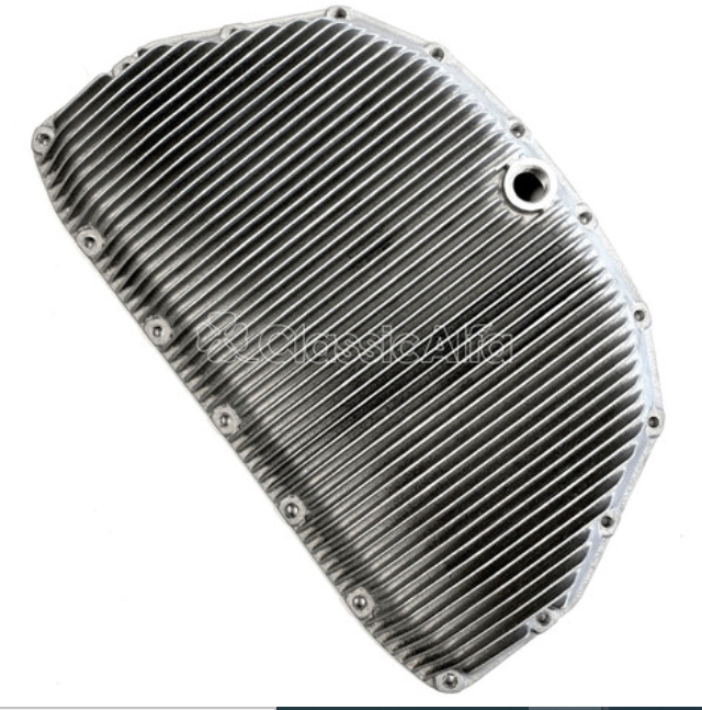

Large capacity finned sumps & oil coolers a la Alfa Romeo are there for a good reason. Why you can drive them flat out all day without fear of engine damage.
10 litres of oil & finned alloy sump base right in the air-stream on a 4 cylinder twin OHC engine from 1300cc to 2 litres. And they are deep fins like a heatsink on a powerful Class A amplifier. Sumps are completely baffled as well.
