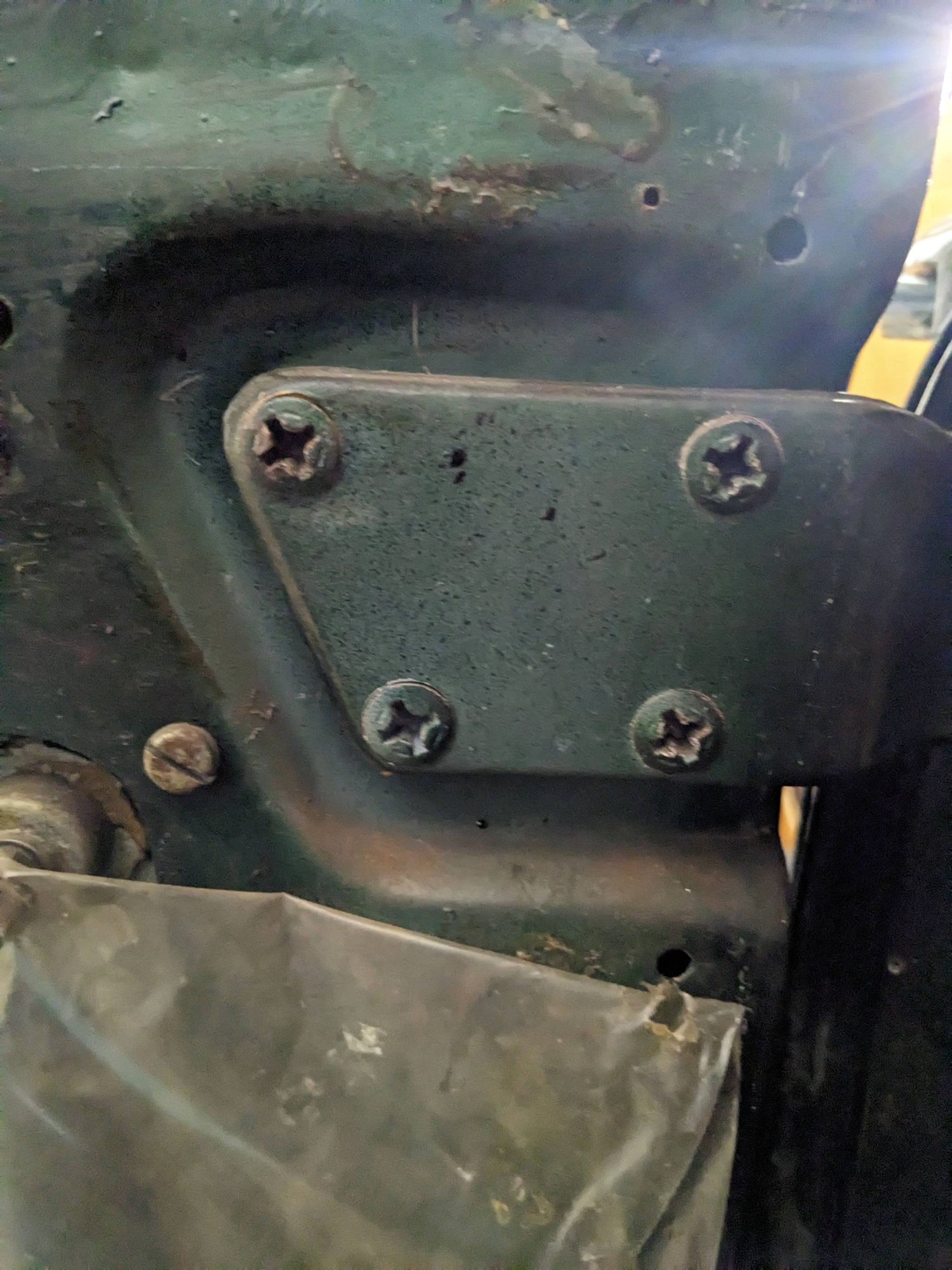

From memory when I have done it in the past the hinges were left attached to the car shell. The front hinges are held in place with three 1/2 bolts each top and bottom. The rear door is similar but to get the top hinge off you do have to strip the door cards out and there are three screw cross head bolts on the top hinge under the door card.
You can remove the hinge but I would not say getting the cross head screws out is in any way easy unless they have been removed before in the last couple of years. Those cross head screws will rip up even with an impact driver. I removed the doors and left the hinges in place.
As Glyn said you require an impact driver to remove the screw cross headed bolts and I found the door did not open wide enough to get the impact driver onto the cross headed heads on the hinges and hit it with a hammer.

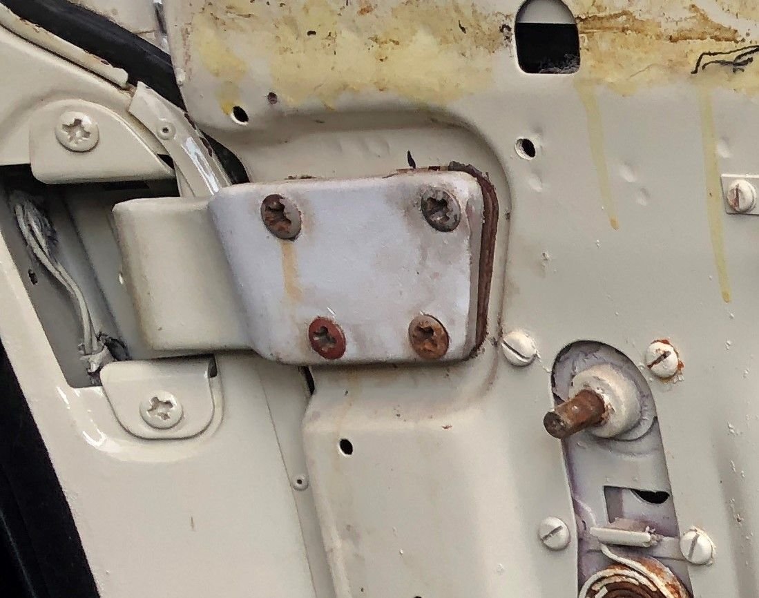

Remember the top hinge takes one thin headed screw on the rear doors or you can't fit the door card flush ~ ask me how I know ~ LOL

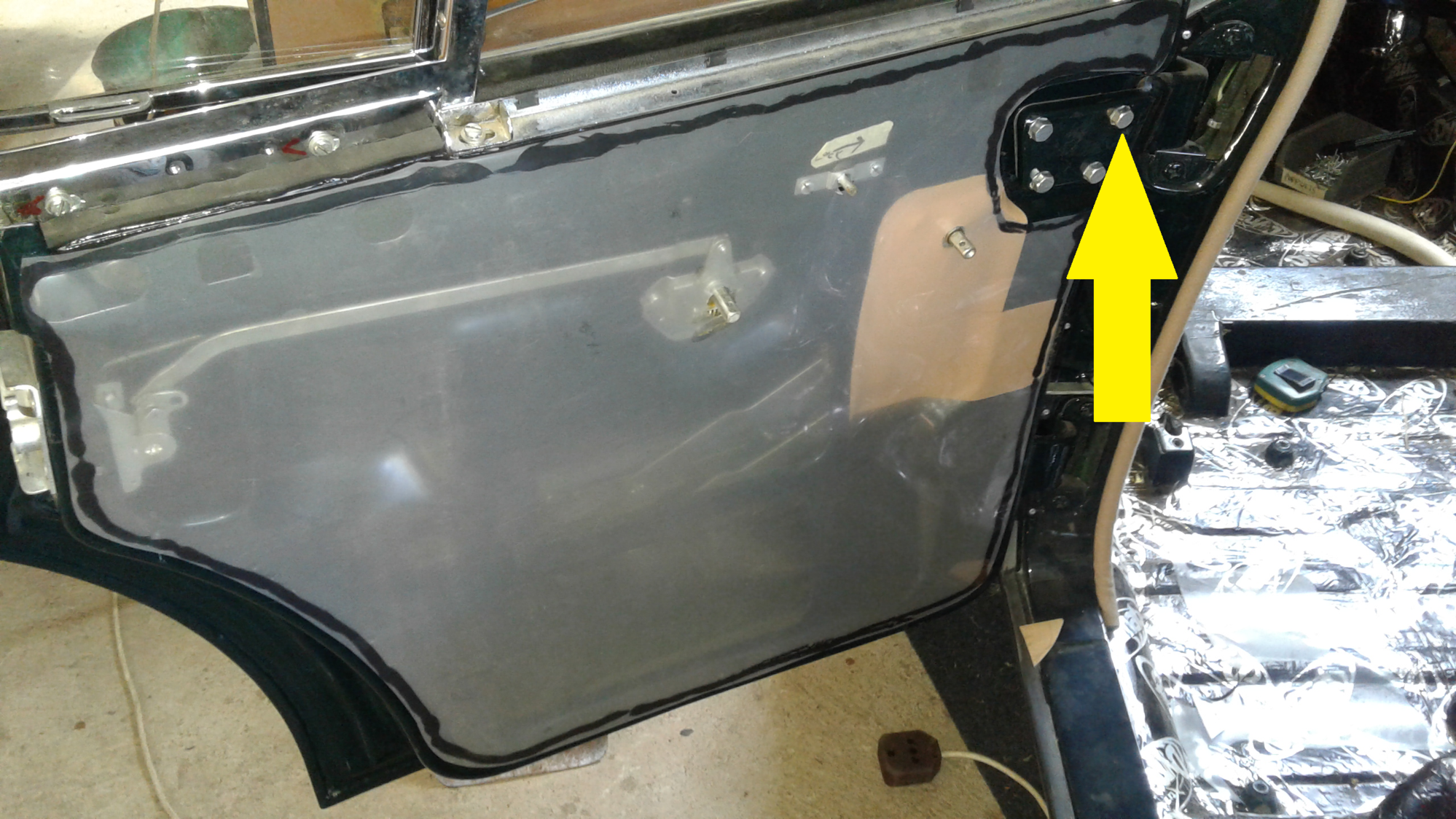

Glyn M Ruck's Avatar
Posts: 5,546
Likes: 1,493
Refresh page for pic.

These are the correct counter sunk cross headed bolts that hold the rear upper hinge in place behind the door card. You need either a large cross head screw driver and a bit of luck to remove them or as Glyn has stated an impact driver with the correct cross head bit. Very easy to slip or not have the head of the screw driver correctly in the cross and you will ruin the head and not be able to get the bolt out without drilling it out. I have used a large cross head screw driver with a pair of mole grips on the shaft of the screw driver to give me leverage to turn the screw but mine have been removed and you need to have a lot of force going into the screw driver (By putting all your weight in to it) to hold the bit in the cross head of the bolt.

All 3 of my cars had 3 machine bolts and one cross head screw on the rear doors so as not to foul the door card. Either an earlier car thing or a CKD thing. Your car is late production. Mine were all earlier. The hinge sits in a depression in the inner door skin.
And remember how many shims were where for easier re-fit.

This shows the arrangement on my car, built at the end of 1962, registered 1963. The screws are not tight as I'm working on that corner of the car.
