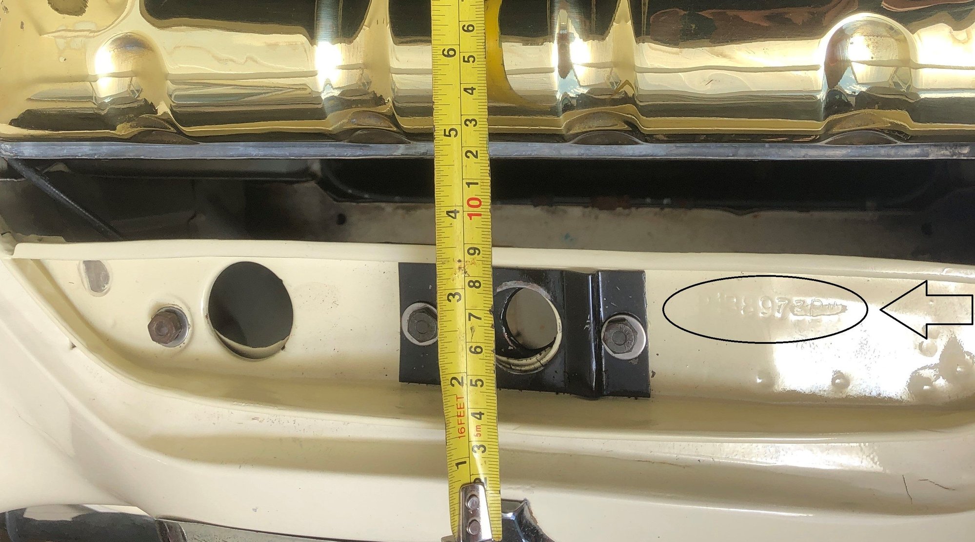

If you have taken the number from the VIN plate check again or take a photo and show us. Also compare it with a number that is ether stamped or etched in to the slam panel just to the right of the bonnet catch. Quite often the numbers are hard to read at the back of the engine so I have found by taking a photo you can enlarge it and read it more clearly. I have also found in the past that the VIN plate can be replaced with a new one and the previous owner has got the numbers wrong. The slam panel is the best place to confirm the number as this cannot easily be replaced.
This is a picture showing the location of my chassis number on the slam panel of my 1968 S Type.

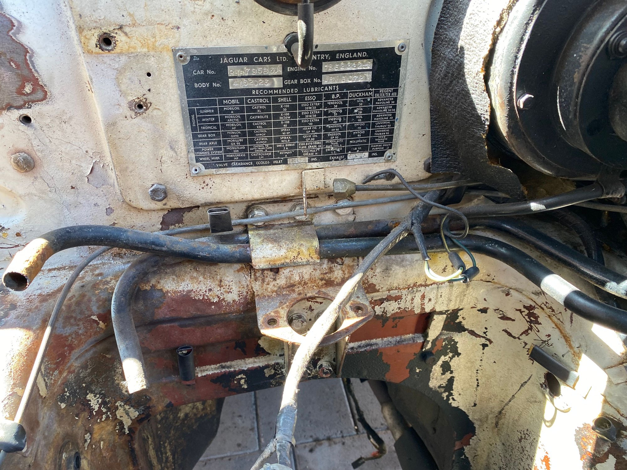

Isn't there a data plate on the fire wall above the rear of the engine? That should have all your vehicle information.
From this I can tell it is a LHD 3.8s manual with a 9:1 compression ratio engine built on the 25th March 1966.
