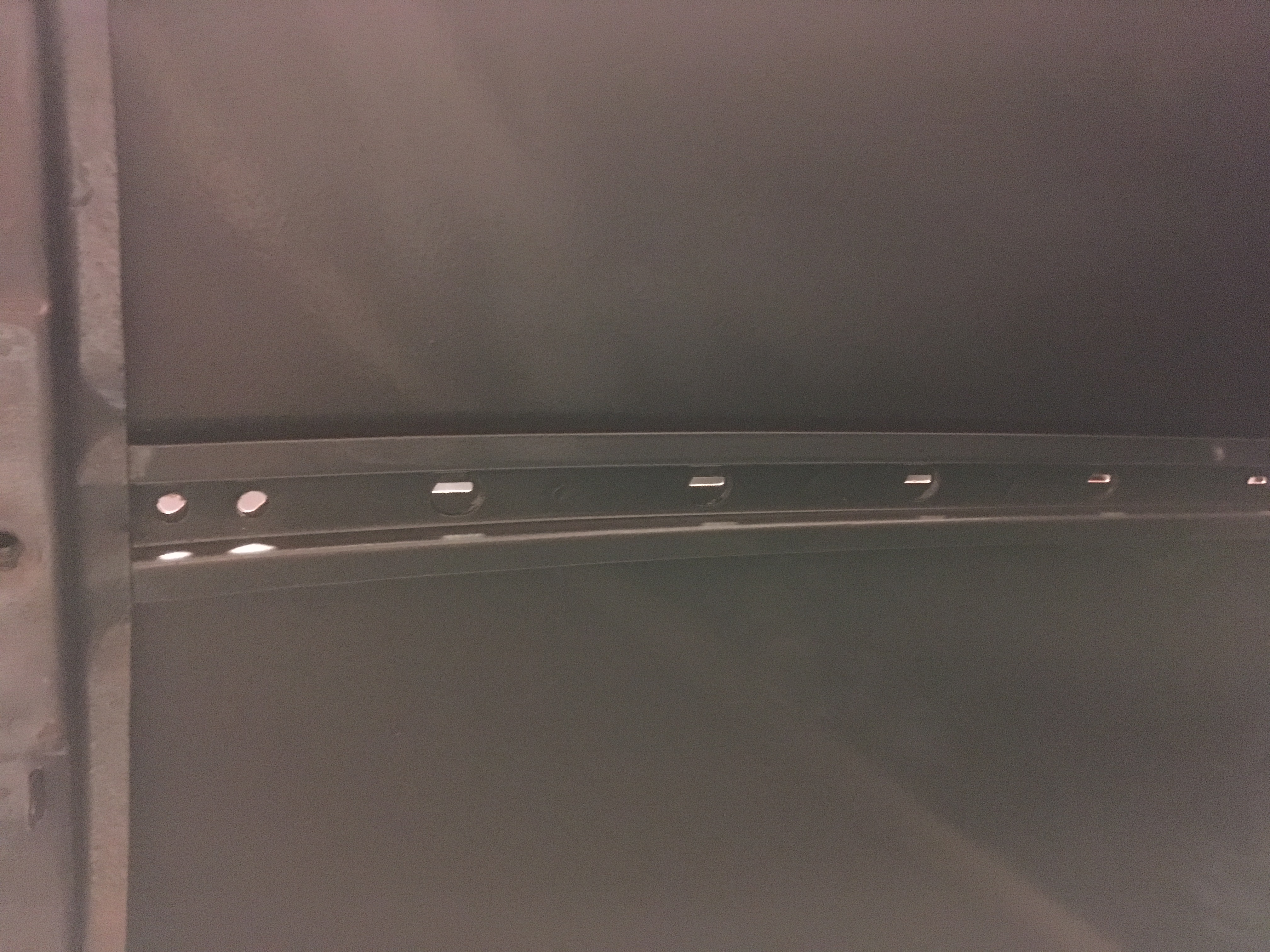

Here are a couple of pics of the inside of the hood
Attached Thumbnails Hood Trim Clips-img_2283.jpg   Hood Trim Clips-img_2284.jpg

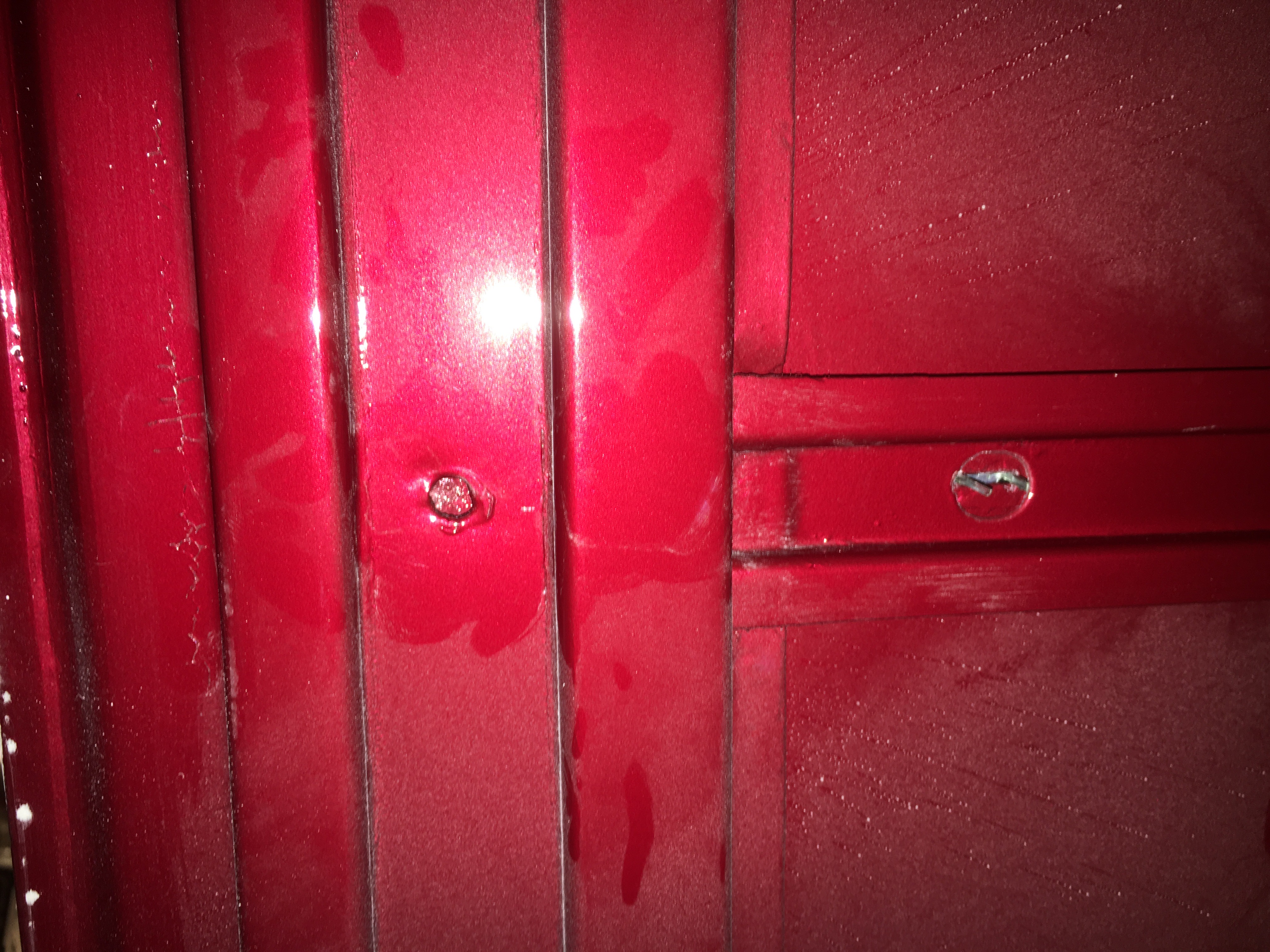

Here are two pics of the rear of the hood. From the top, you can see the last two slots that look the same as all the other slots. But when you look at the underside, there are two cross braces that run under the slots, so no way I can see to spread the clips and clamp down the trim.
Attached Thumbnails Hood Trim Clips-img_2928.jpg   Hood Trim Clips-img_2926.jpg

Hmmn, very good point, I am trying to find my old trims to see what they were fixed with in that position, I have a new fixings kit and that doesn't help me either.
I will find where I put the trims and come back.

I decided that the only way to resolve this (partially) would be to drill through from the top at the rearmost clip position. This would enable me to pull the trim down into its proper position, but I still have not decided what to do about the second from rear position as this also is hidden under the cross beam. By the way, the clips from Welsh Jag are too big to fit the slots in both my MK2 hoods. I had to carefully grind down each clip to shorten it to the length of the slot, and narrow the tangs so that they would go through the slot.
Attached Thumbnails Hood Trim Clips-underside-hood.jpg   Hood Trim Clips-hood-trim.jpg

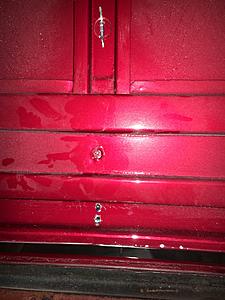

Default Door Trim Clips.
These are the door side trim clips that came in the Welsh Jag Kit. They are a completely different design from the ones that came off of the car, and do seem to work very well. I had to squeeze the trim a little to get it to clip on nicely, but so far so good.

Are those slots in the doors ? They are normally just holes

Default Slots
They are slots on all 4 doors. I have a 62 as well, and they are slots also. You may be thinking of the holes along the top of the door.

Yep. My Front and rear doors are slotted. 1964.

They are holes on my 67 340 are just holes, I haven't taken the trims off the 65 yet.
Does that answer the question re the bonnet, should there be riveted clips the same as the doors for those blind slots then ?
