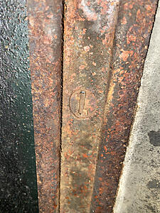

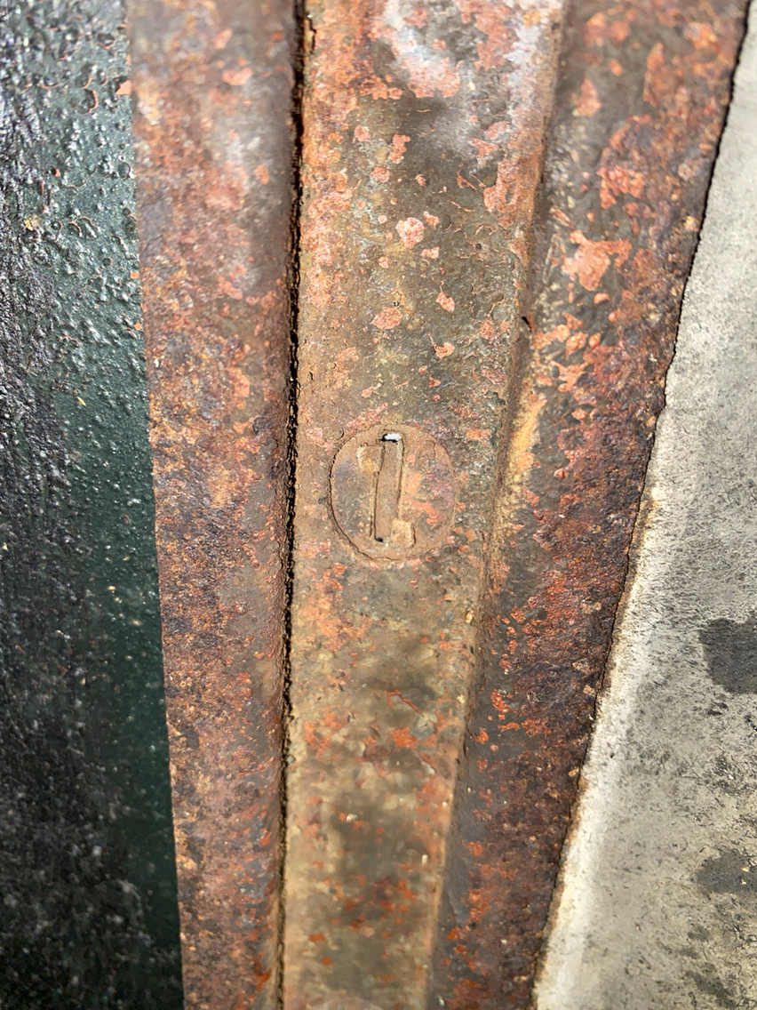

Here is a pic of my 65 built S-type. It appears to be a probably a "twist in the trim" thing, then with the tabs bent over. I have no idea of a part number, just throwing it out there as a "likely original assembly part."Hood Trim Clips-photo161.jpg
