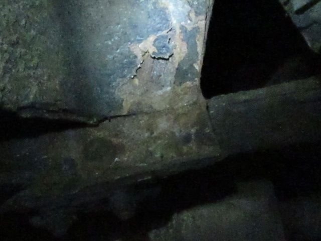

Hi Jon,
Thanks for the advice about tank removal, I've attatched a couple of photos of the repair area just where the front end of the rear near side spring connects with the body. Its not very big and is the only corrosion on the car but I'd like to deal with it before the mot . The car has been off the road for 8 years since its last mot expired. I bought it in auction a couple of months ago so I'm working my way through it trying to prepare it for regular use again.
Oh I know the area all too well! See attached pic, there is a void at that point, and 2 thicknesses of steel, the rust gets in and between the 2 sheets and off it goes.
When you take the rear suspension out (assuming you will ) carefully check the spring hanger channel, this has some voids and is also double skinned, if the rust gets in there you will be replacing that as I had to, so make sure you check, treat/deal with that area fully.

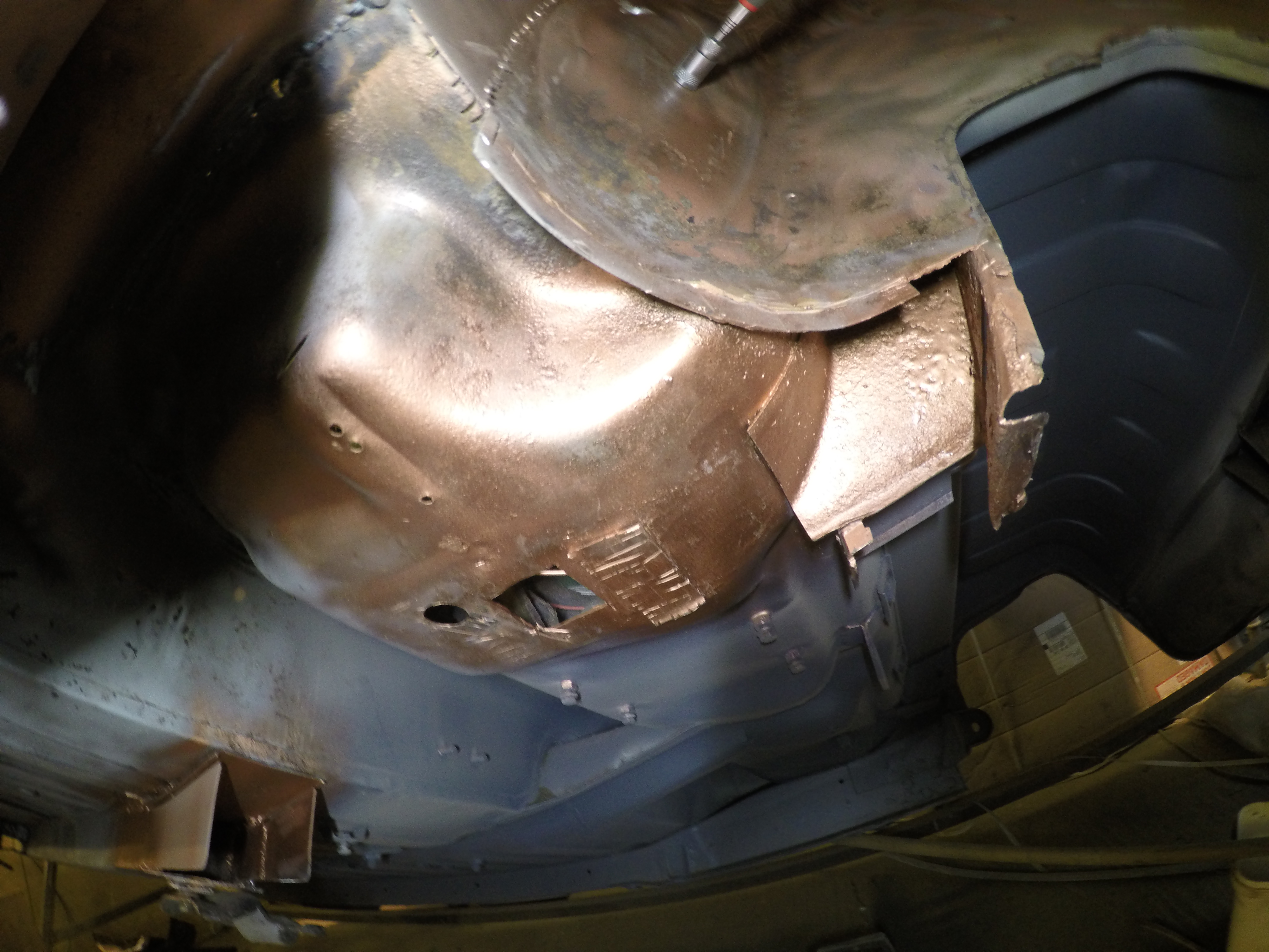

Hello again,
Following on from the advice about checking for rust in the rear wheel arch and spring hanger area. After thorough checks the only area needing attention was the nearside rear inner wing panel. I cut away enough to check the spring hanger channel and luckily this was sound. So I made a repair patch and welded it in place going round it with seam sealer. This was the final job before the MOT. I drove RBD450G to the test station Thursday afternoon and it passed with just two advisories. One being the rear tyres showed early signs of perish cracks and the other was blue smoke on acceleration. The tyres are an easy fix but any advice on the smoke would be helpful. The mot tester is a Daimler 250 v8 fan and suggested I try changing the oil for 20w40. These engines always seem a bit smokey but you may be able to advise me. There is also some oil leaking into the sparkplug tubes but I believe you can get seals for these.
Best regards Mike
Best regards Mike
