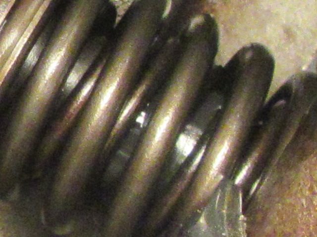

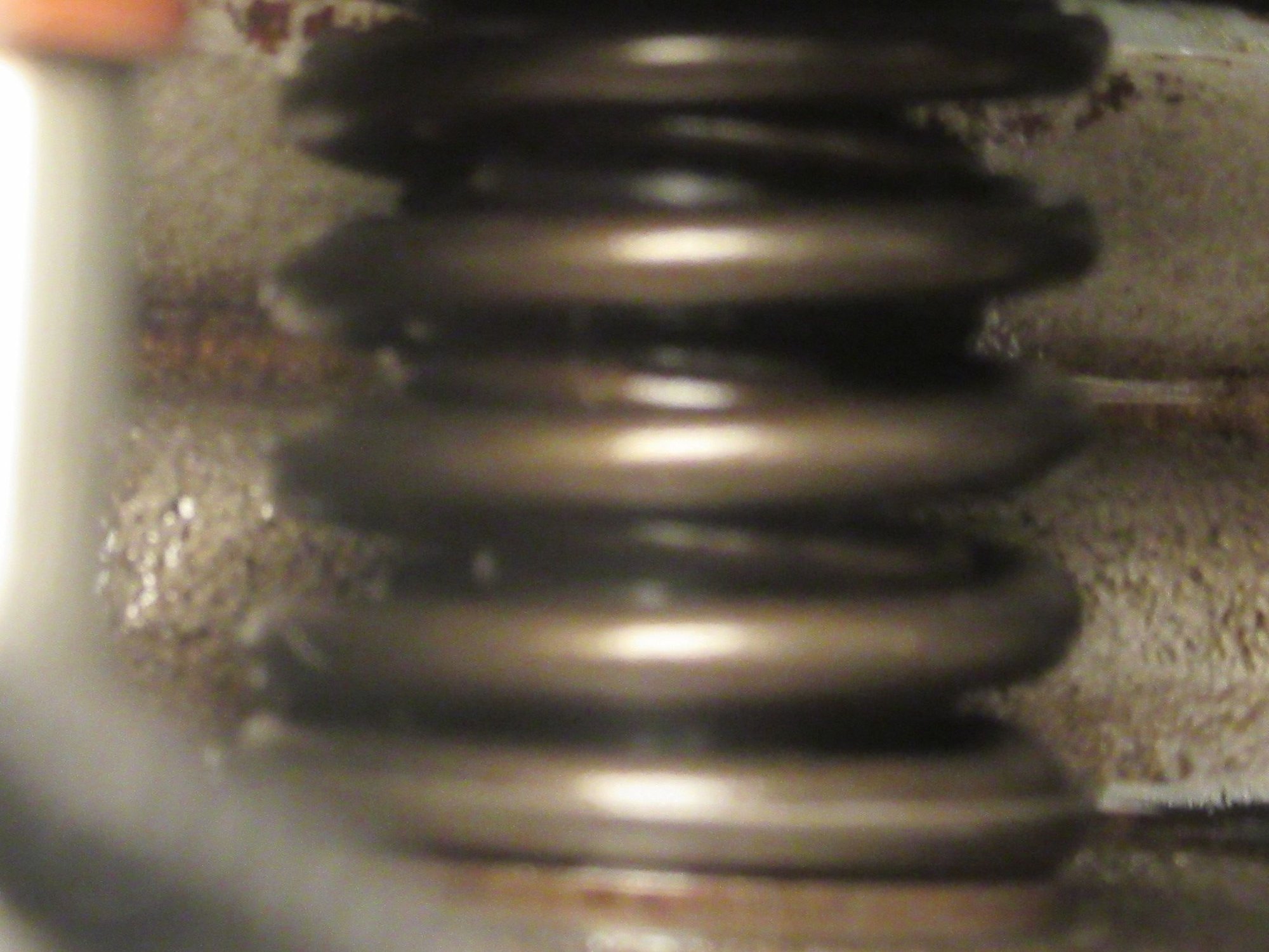

Hi Mike, can you post a pic of the seals, I have never seen white ones, they are generally black with a spring around the top edge to help squeeze the seal to the valve.

I've taken some pictures for you, looking at them today in daylight rather than a lamp they look more grey than white. There is definitely some kind of flexible collar inside the spring.
