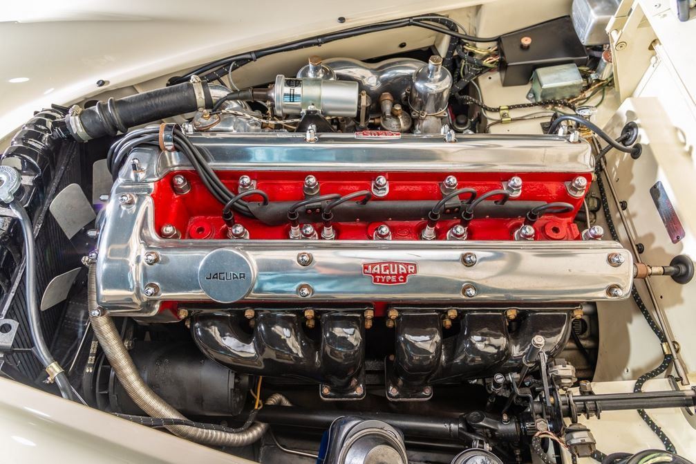

One of the few C Type wide angle twin plug heads would be great. A friend has one in his XK. Lucky bugger. Bright red with emblems on the cam covers.
This is a 6 plug version. The Twin plug units were rare as rocking horse droppings. I think most of them ended up in D Types.

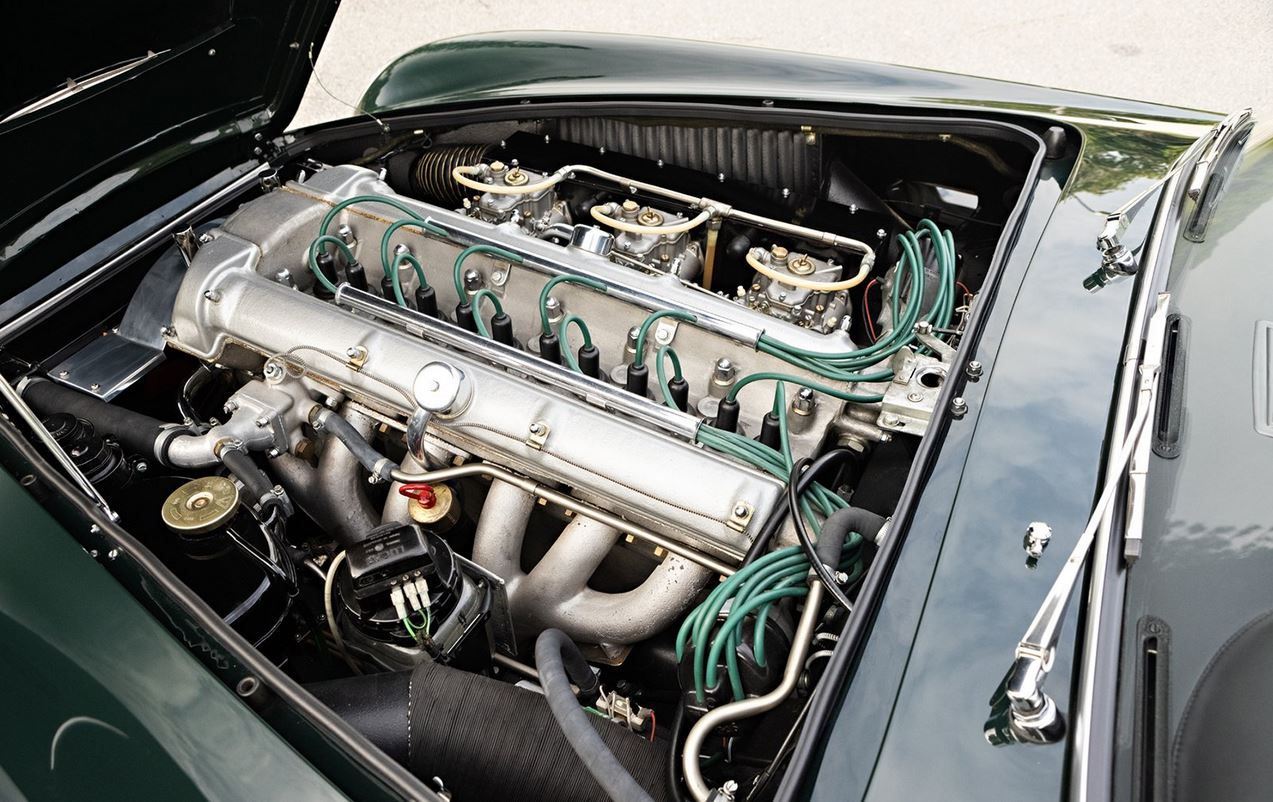

The 12 plug is fitted in this.

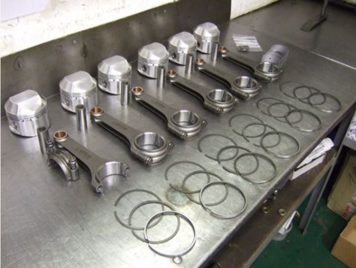

Exactly ~ I'm a swirl & squish believer (gasoline engines ~ if some tumble comes with it all good). I have no idea what the twin plug did in the D Type or what they did with compression ratio. (The heads have become collectors items). Equally I don't know what larger valves & higher RPM did to driveability at part load. All good questions.
Aston Martin DB4 GT had some success with 12 plug heads. Twin distributors were a pig to time.
Note pistons:
