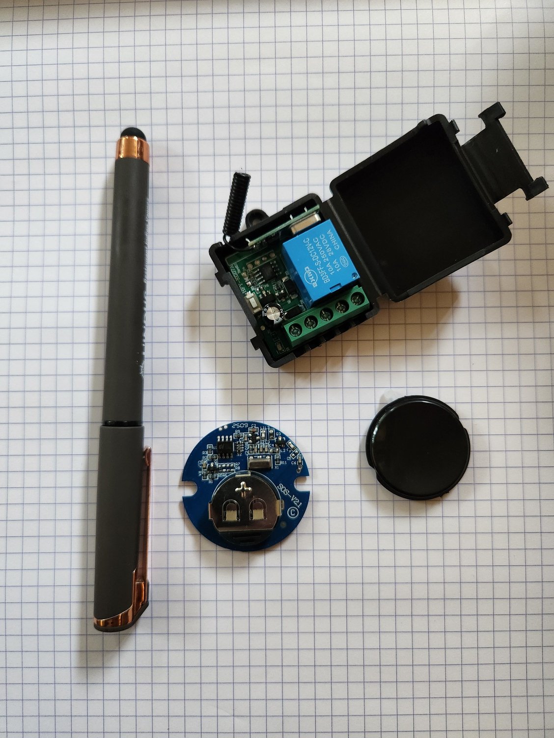

Hi Peter
The switch has arrived I've taken it apart quite a small board with button , led and key for style battery.
The receiver with relay in it is i fear to small for Jag twin horns but I'm sure it would coupe with a 30 amp SRB relay.
I will post some photos when I get a chance, fingers crossed.
Cheers Simon

can you hardwire that module to a 5VDC voltage regulator to avoid changing the battery?

Hi It's 12 volt but I've decided to run the horns through an SRB 30 amp relay so the module operates the relay, less load on It's internal relay
cheers Simon
