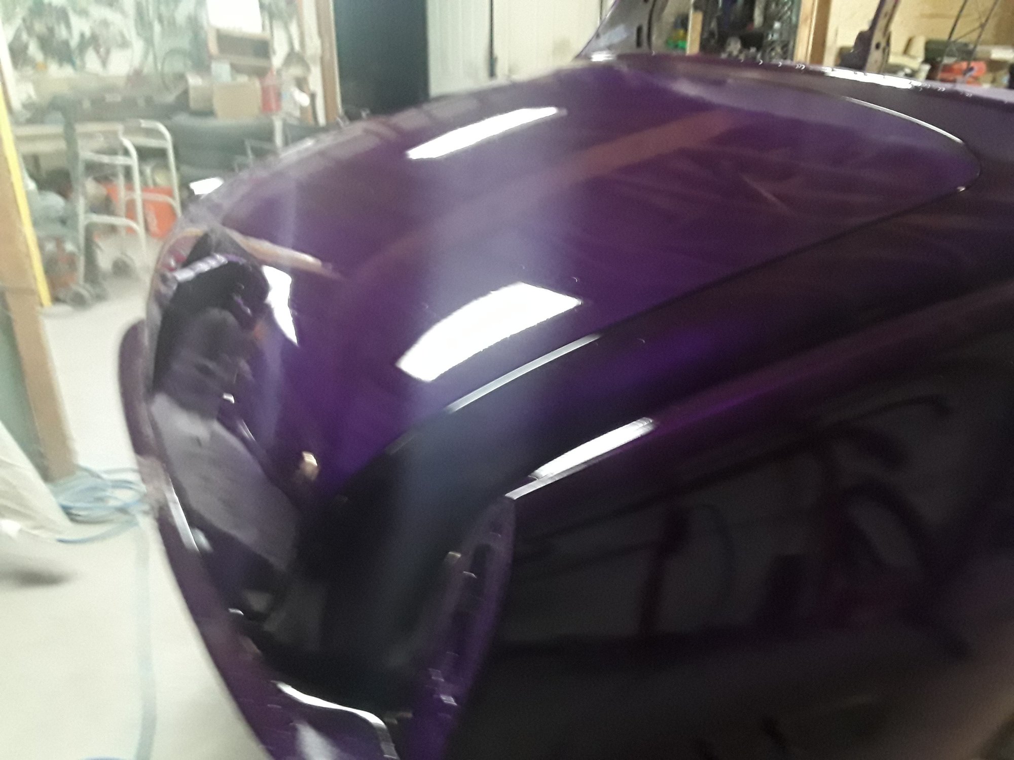

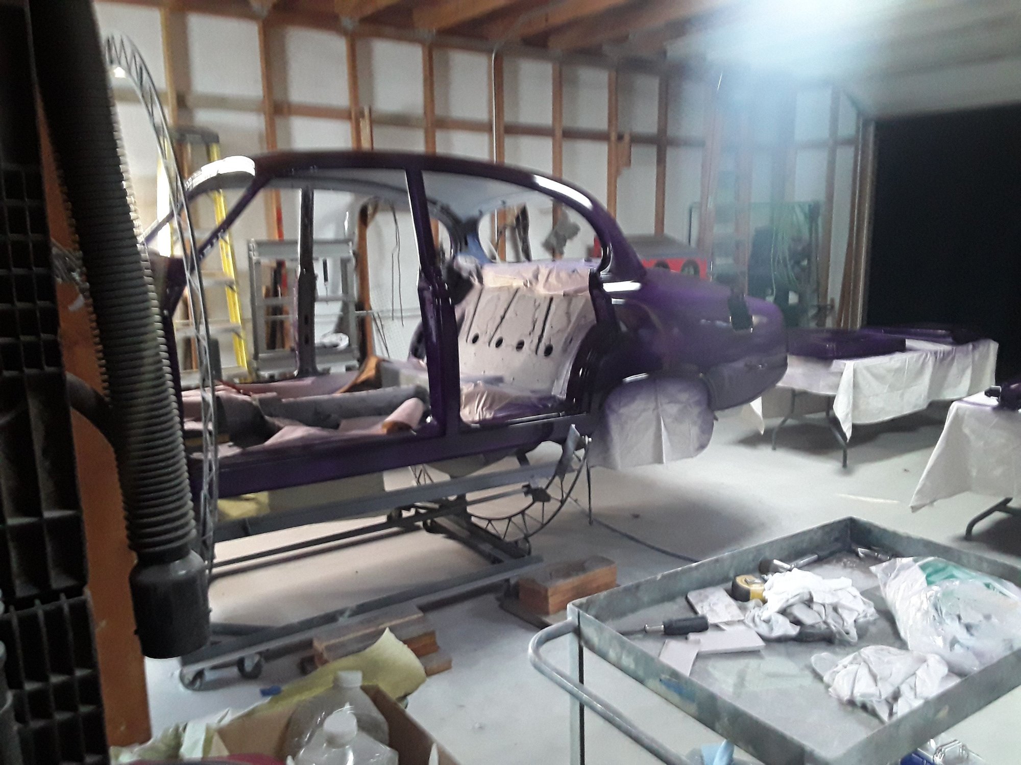

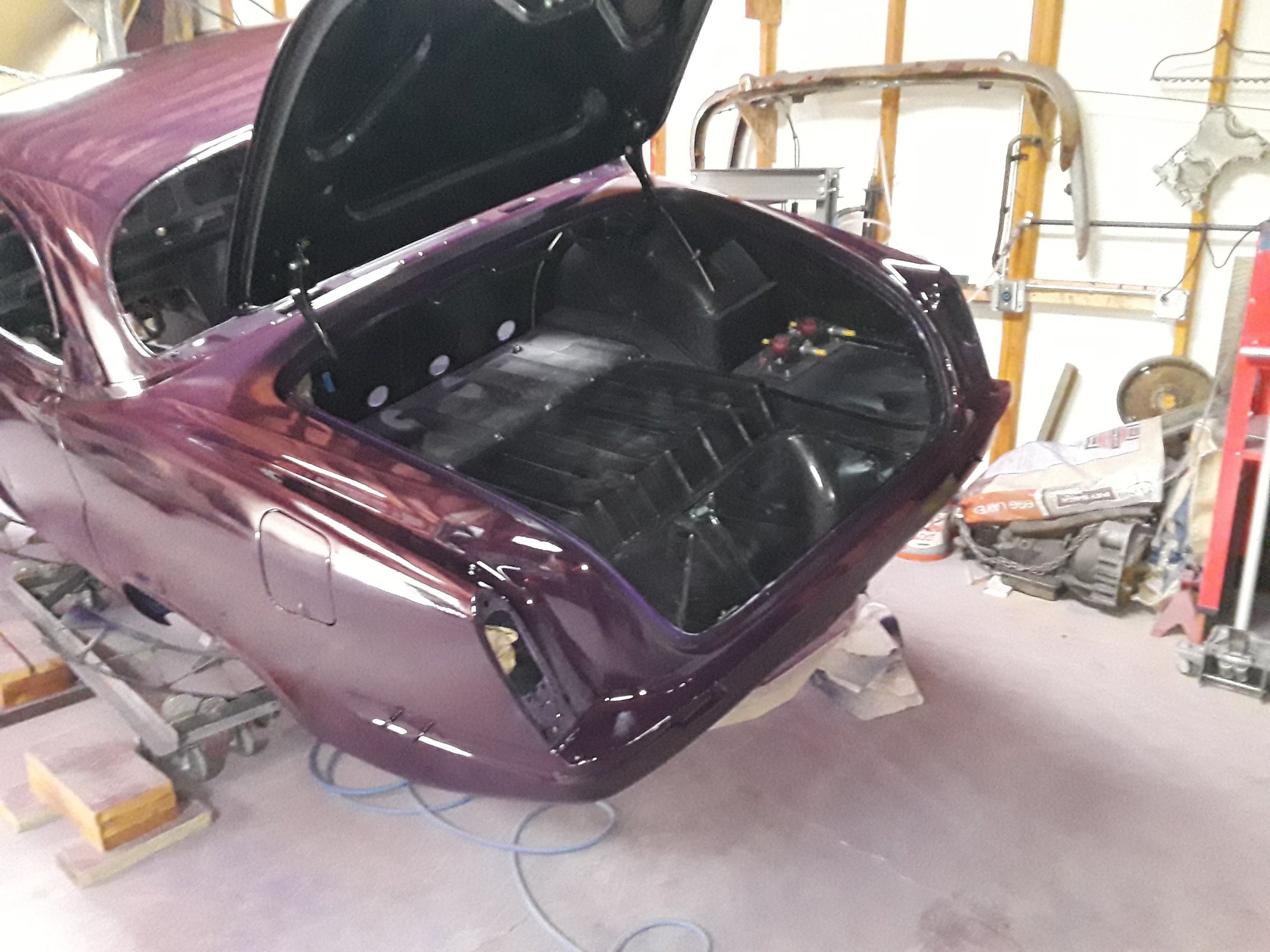

A few Photos of my 4 year project:
12,500 USD invested in parts so far...
4.2 rebuilt engine from 1987 XJ6, BW35 trans, all LED lighting, Touch screen stereo with subwoofer, backup camera on license plate frame...
work in progress for a old guy with a bad hip...you should see how slow i work with a walker !
