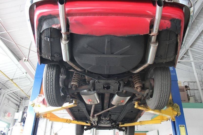

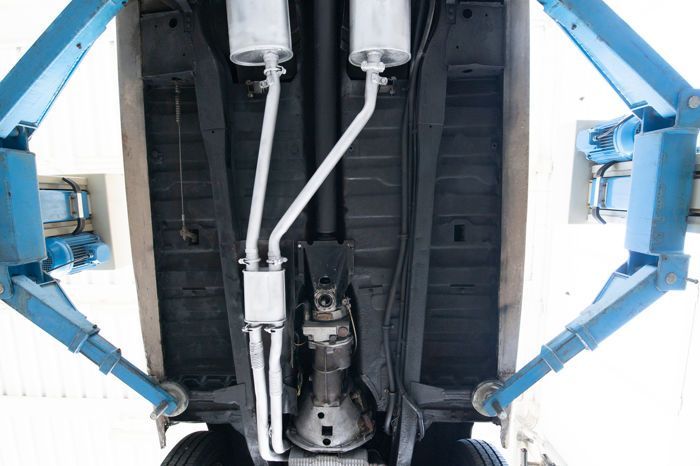

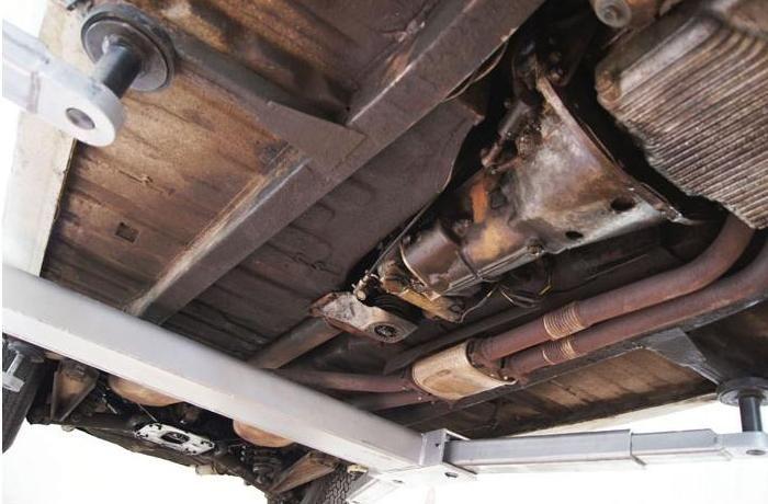

Why not place the rubber pads on the square jack tubes of the car ???
Old Mar 12, 2021 | 04:11 AM
Glyn M Ruck's Avatar
Posts: 5,546
Likes: 1,495
Old S type. Similar floorpan to Mk2.
As Jeff says. Place pads at the 4 jacking points where the body is suitably reinforced. It won't fall off unless the Andreas lets go in spectacular fashion & demolishes your house.

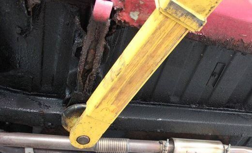

With compromised sills & outrigger jacking tubes like this car I guess you could always lift at the inner "chassis" rails. Trouble is that with this sort of rust damage the whole unibody structure is weakened until properly repaired.
