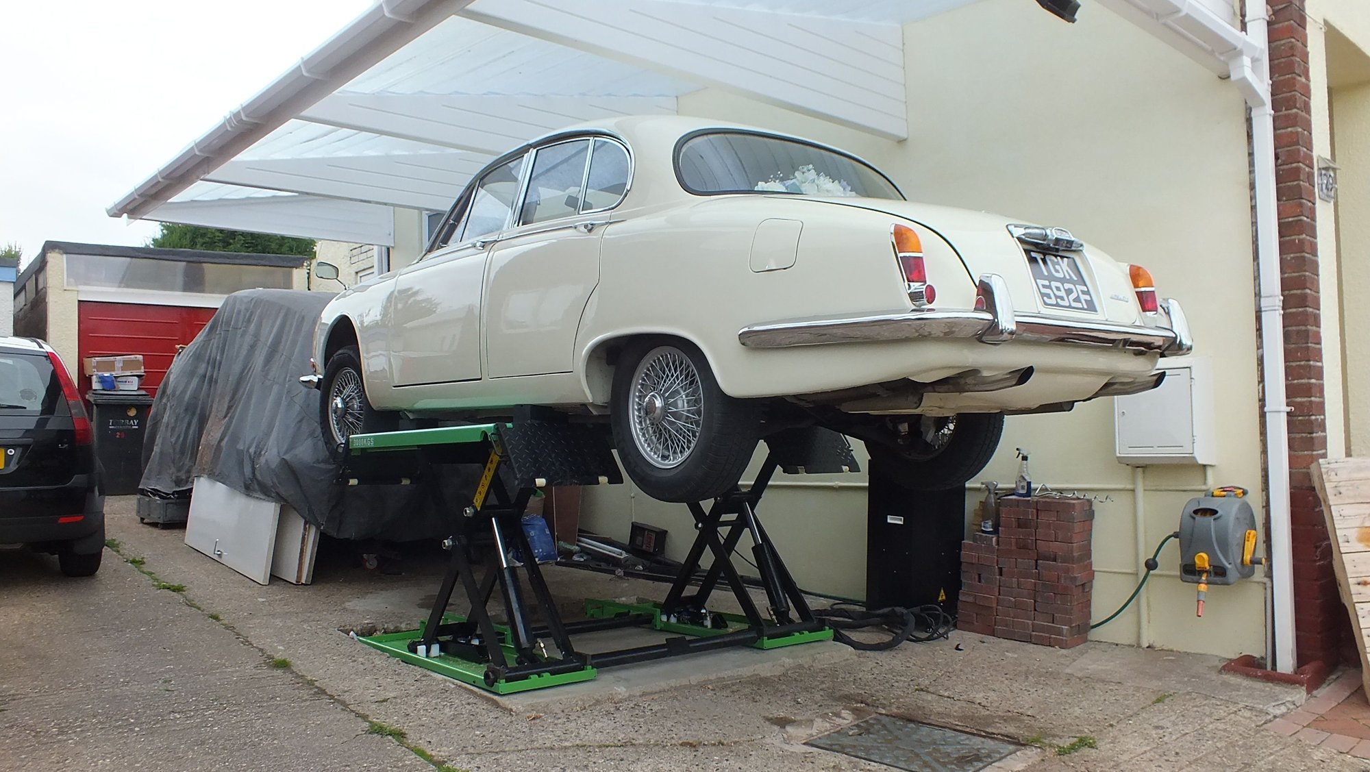

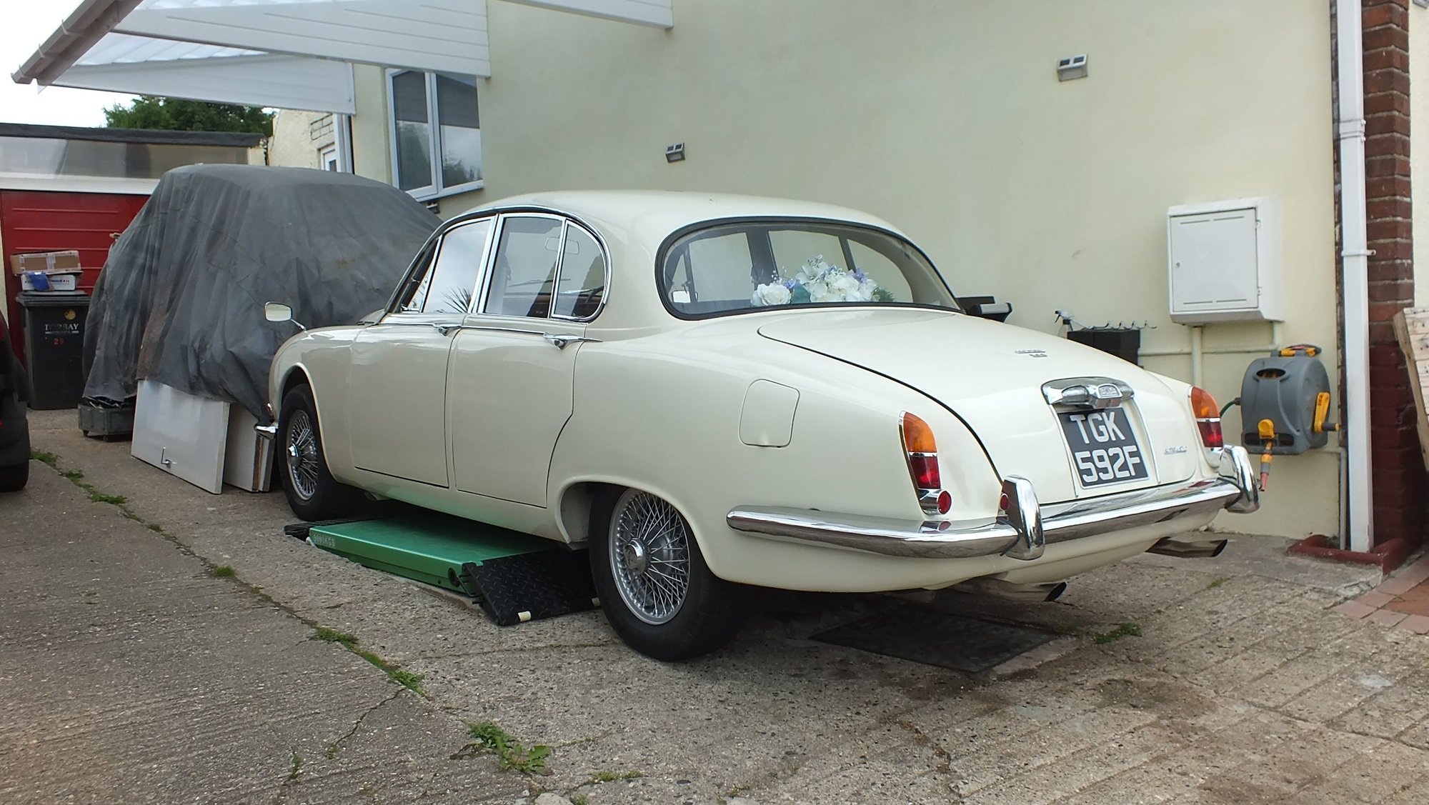

My S Type has had new sills 12 years ago and as far as I can tell is rust free. On my driveway I have a hydraulic ramp which is the type that you drive the car over so the wheels are hanging off the ends with a flat surface under each sill. I then jack the car up with small rubber blocks under each jacking point. Never had a problem and never heard any weird creaking sounds so all is good.
The design of the jack allows me to work on the suspension and brakes at chest height just by removing each wheel. It also allows me to safely get under the car for oil changes and the occasional power wash clean. I have also used it to polish the lower sections of the bodywork whilst the car is up on the jack rather than having to bend down.
