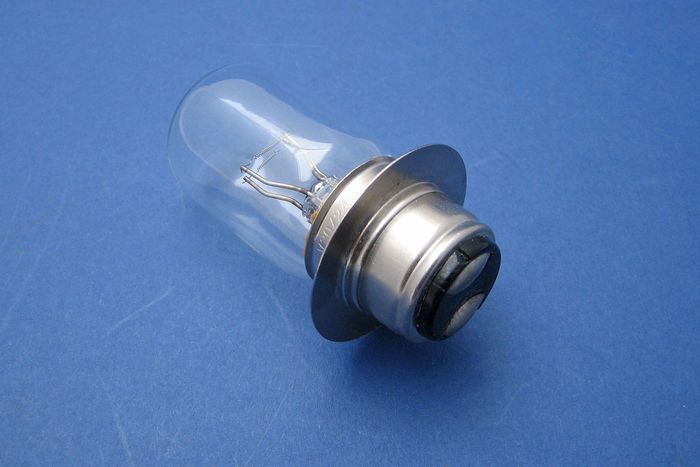

this is what they have inside, they read: "410", "Made in Germany".
I've never seen such a huge bulb. Are they still available?

Many thousands of British cars had these headlamps and they were fitted on the XJ saloons right to the end. Quartz-halogen bulbs are now normally fitted and are a straight swap. Sometimes there was a small hole in the side to take a small side-light bulb and holder that was a push-in fit.
Later on, a sealed all-glass 7" unit came along which was, in effect, a huge bulb and if the filament failed, you threw it away.

I have to apologize, they are not H4 bulbs, they are P45t bulbs, I hadn't spotted the 410 marking on the rear of the lamp.
They were 45/40 Watt non halogen, and have a slightly different base to the H4 which has tags on the side, still not a pre-focus bulb, they are not a straight swap for H4, but there is a halogen equivalent which is an HB12 these are 60/55 watt.
Both the 410 and HB12 are available, but generally not from the standard auto stores off the shelf.

I contacted the new Lucas and they say the bulbs are still available and referred me to a US supplier.

yes I noticed it wasn't Lucas anymore when he referred me.
I did find the bulbs elsewhere. New.
