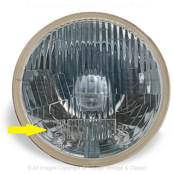

There should be a marking on the lens (usually an arrow or L or R in the numbering or both) as to whether they are designed with lenses that dip to the left or dip to the right.
Example for RHD car. (dips to the left) ~ (a LHD car requires lights with lenses that dip to the right.)

Link does not work. Found your eBay ad. The fact that they are marked Lucas "European" makes me believe that they are dip to the right.. Inadequate resolution in pics above.
The difference could be purely in the part number and only displayed on the packaging. (I've shown a typical Lucas example) Sometimes in black on rear of reflector.
What I'm explaining is the difference in dual filament dipping lamps. Lights for RHD cars dip to the left and LHD car requires lights with lenses that dip to the right.
The difference is all in the lense facing profiles.
A single filament fog light etc. requires no dipping consideration. Only a direct ahead beam.

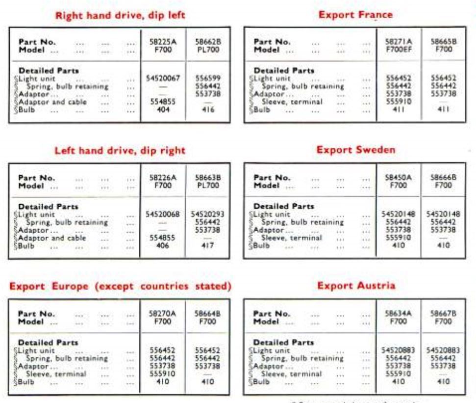

Lucas Catalogue Jaguar pre sealed beam.
HEADLIGHTS:
