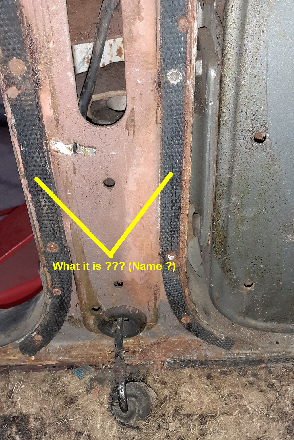

Hello, I am newbie on this forum.
I made myself happy and bought a Jaguar 3.8S. I'm at the beginning now and I think it will be a project for at least a year or two.
Now I am dismantling the interior (the body must be sandblasted) and I have one question, please.
What is the material of the pad in the body to which the furflex is attached ? Wood, rubber ?
It is possible to buy it ? Does it have an original Jaguar number ?
Is there anything that can be replaced ?
Thanks Roman

I think its called tacking strip, from what I remember its very expensive so if you can save it I would.

Thanks, but it is cca 1 cm x 1 cm (square cross section).

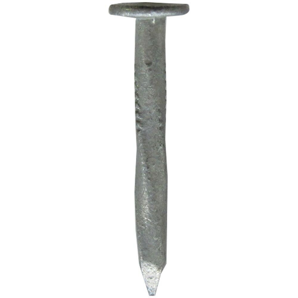

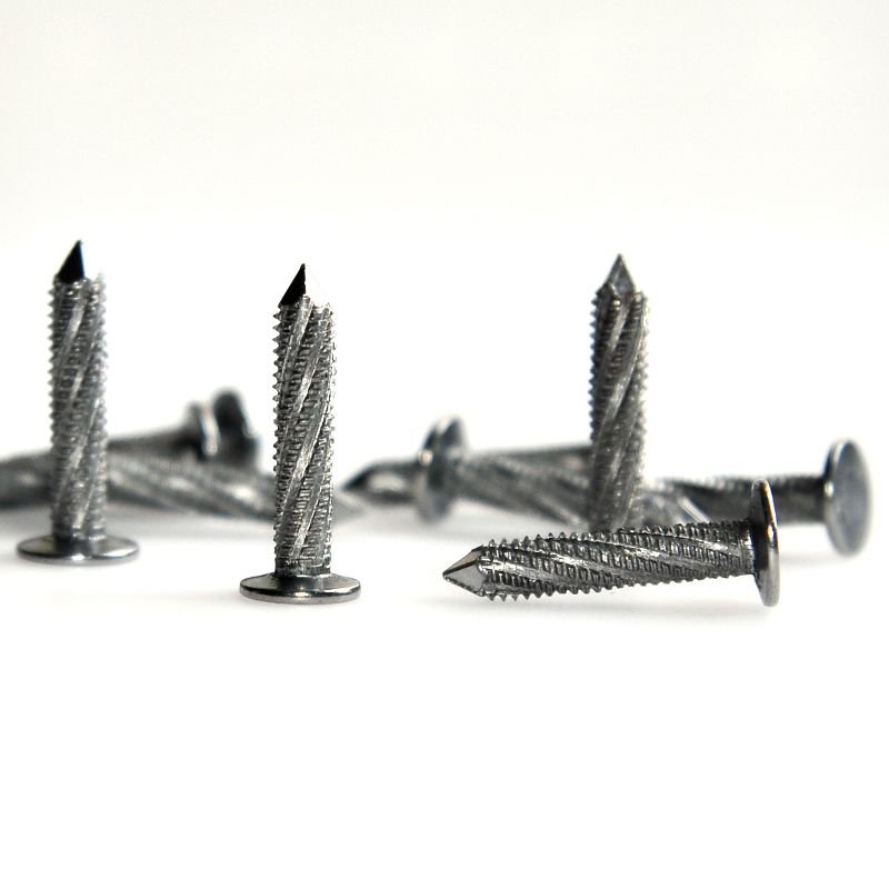

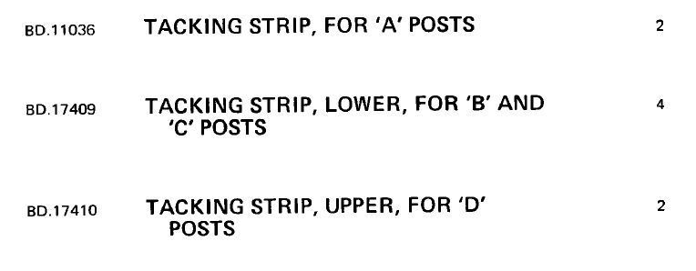

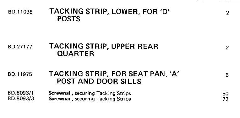

When I rebuilt a Mark 2 in the 80s, I was able to find an unused shell, which had no tacking strips installed, but I was able to take the strips off the shell that I scrapped. They are very hard to remove because they are held on with "screw nails". These are hardened steel with a very coarse thread and hammered in making a hole as they go in. If you can find a scrap body 60s Jaguar body shell somewhere, you might be able to get the tacking strips off that. I doubt you can get the original stuff now, time has moved on too far.

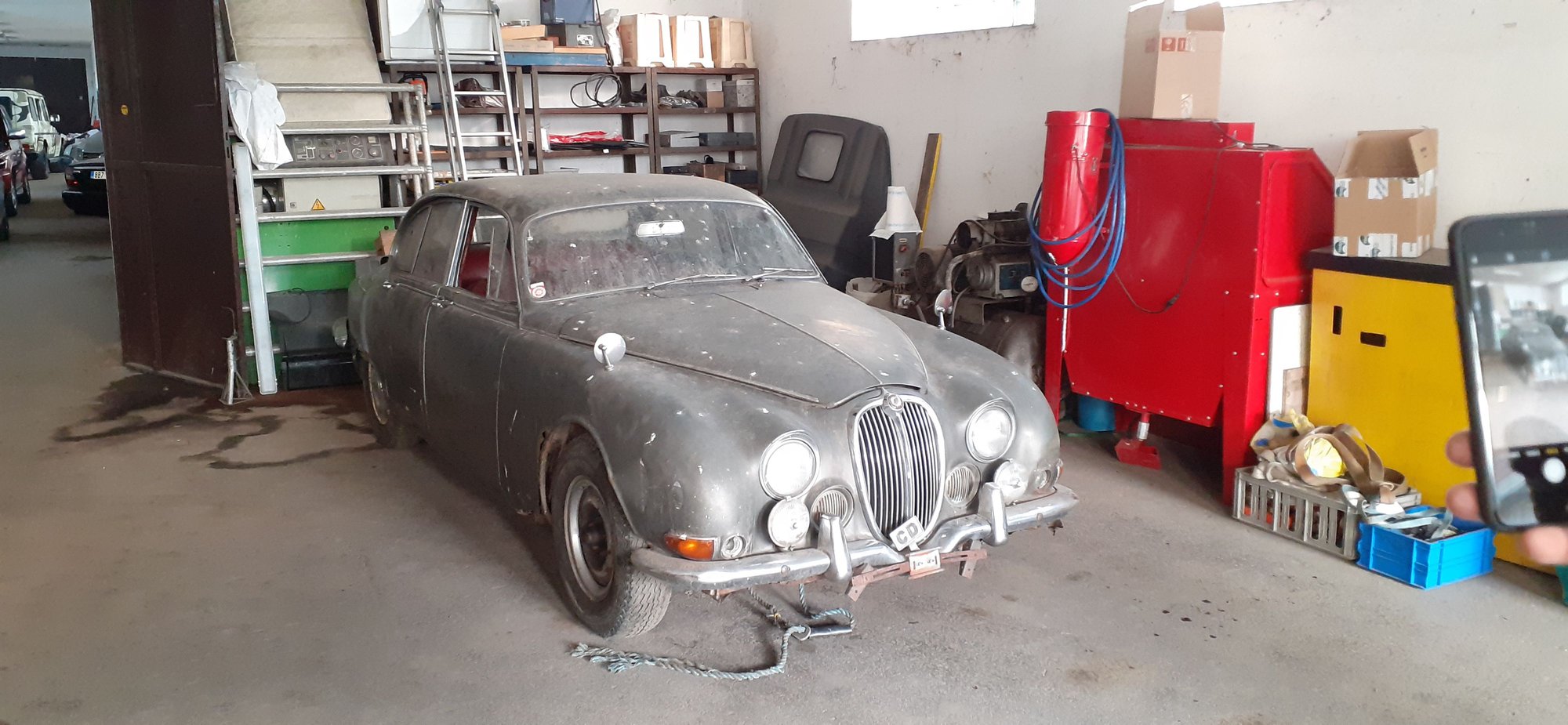

I just noticed your S-Type has a plate on the front with CD on it, is that a diplomatic plate?

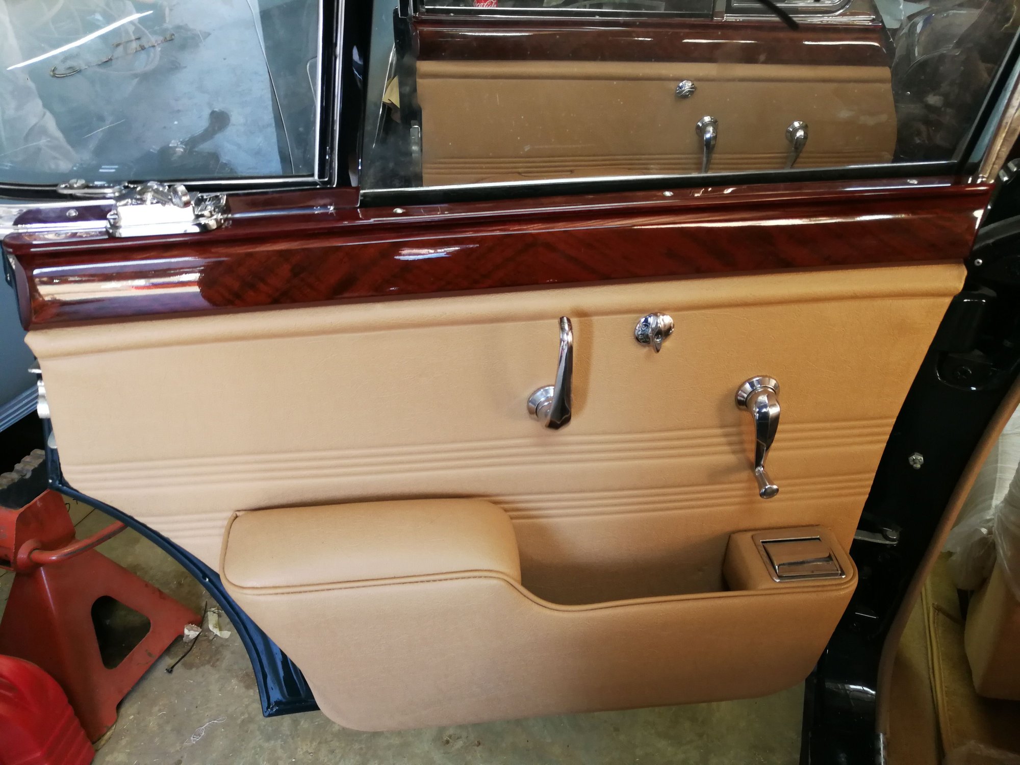

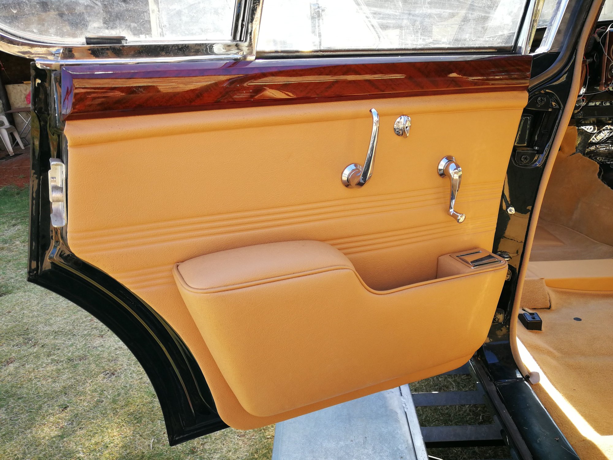

Pop rivets would work but 122 of the things is a curse. My guy used a heat curing glue that is a little like contact to hold things in place & then once in place you run over it with an iron & it cures. Did a great job.
Pre to attaching tread plates & top garnish rails.
With top garnishing rail & tread plates. Sorry ~ pics not taken for this purpose. Tread plate has black protective sticker over it other than the clamping lip.
All my material/upholstery kit from John Skinner UK.

Yes, it was diplomatic car in Vienna, Russian diplomat working for UN UNIDO. The car has been immovable for 20 years in Austria and I bought it last month.
