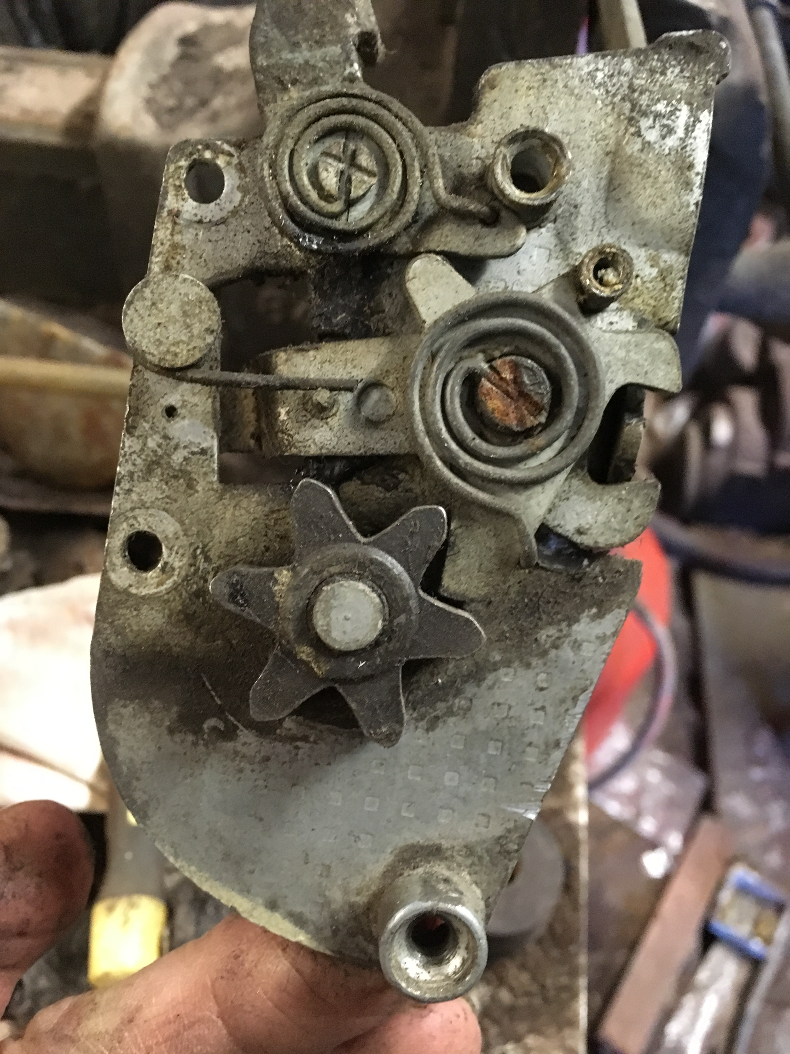

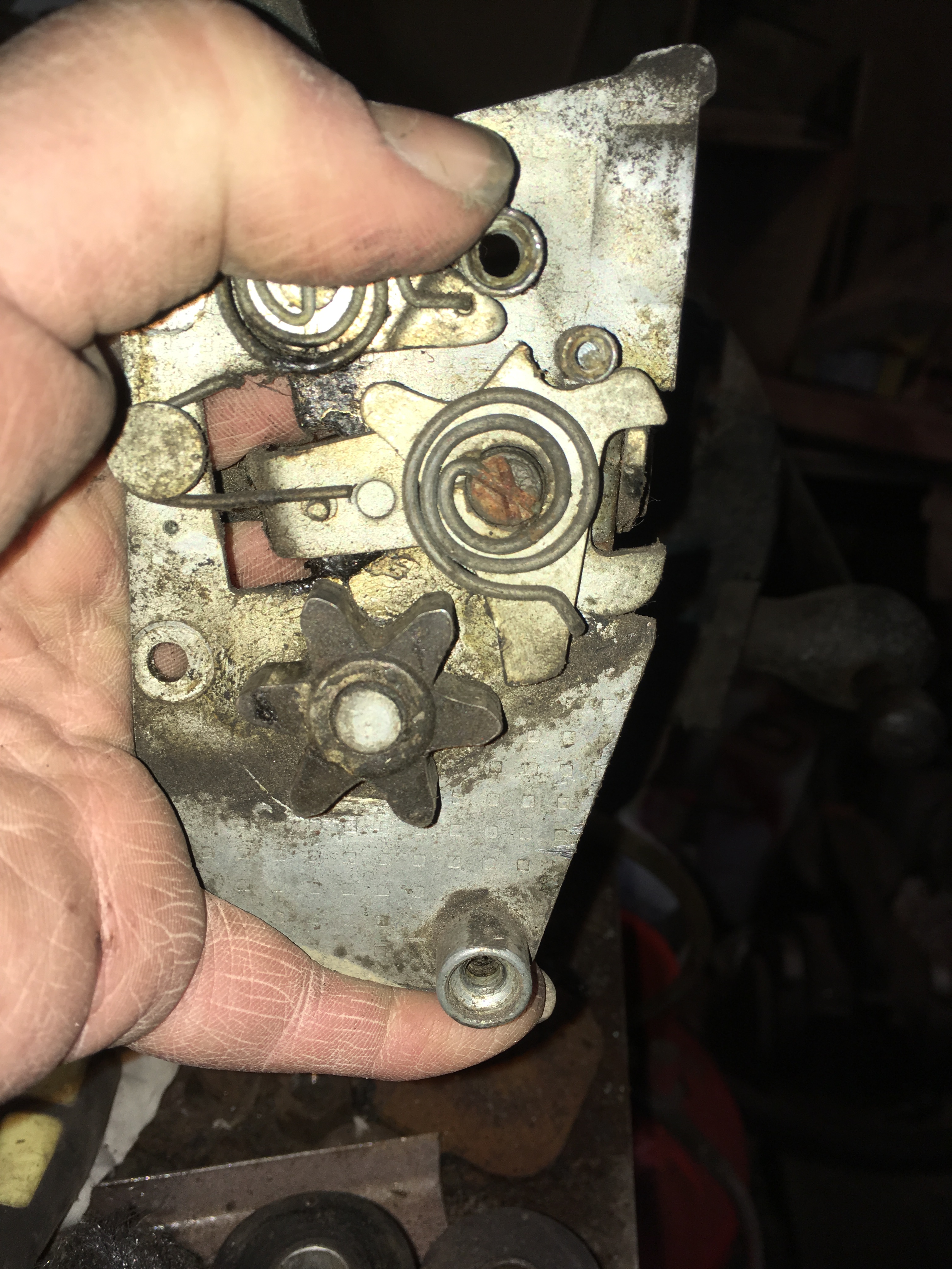

well, the rear door locks are pretty simple, yet also pretty robust, I have attached a video which hopefully shows the workings, the toothed wheel is the actual catch, the lock works like a ratchet, with the outside button or pushing the internal door lever releases the wheel (ratchet) so that it can rotate freely and the door opens.
First, have you tried pulling the door with the button pressed, or pushing with the door lever opening, or vigorously wiggling the door back and forth from outside with the button pressed, the easiest answer is that the wheel has seized and this may free it ?
The button presses on the angled lever that my finger is pushing on the 3rd picture, showing the catch in the open position, the 2nd picture is with the door lever opening the catch, and hopefully you can see this working in the video.
The lock is very mechanically simple, and it is unlikely that both the button and the inside lever have both come detached or broken, the toothed wheel is on a fixed centre point, and may have seized, so try what I have said above and let me know how you get on.

Thank you all for your assistance! We managed to remove door card and found that gear was gummed up beyond belief. Some “manual persuasion” via my boot did the trick. De-gummed and working well once again.
